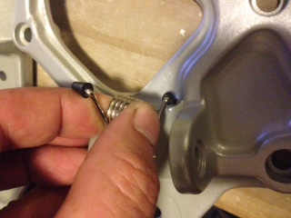

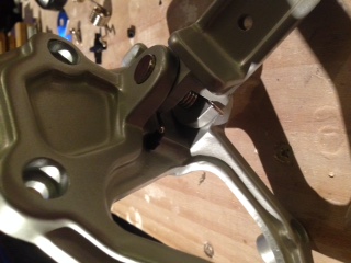

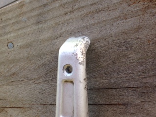

Largley OK ... road rash on the Pegs but not too deep

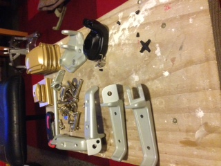

Stripped ready for Powder Blasting
Out with the dremel to take out the rash & reshape & off to the blaster & PC
On assembly I couldnt bring myself to load up the Peg return spring straight on to my coating so found some plastic that was UV stabilized (garden watering component) cut to size & fitted (a little bit fidly for my sausage fingers but it worked)
- Stripped Pegs.jpg (41.97 KiB) Viewed 15520 times
- Road Rash.jpg (39.29 KiB) Viewed 15520 times
- Plastic Bung PC saver.jpg (32.95 KiB) Viewed 15520 times

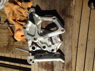

I have only worked out how to get 3x pics on at a time thus this post
This shows my super Bung PC saver
Returned from Coating
Bung in
I forgot to take a photo showing the whole units assembled but also got new fittings for the gear shifting rod ... greased & installed
actually pretty pleased with this job
Bung in
- Pegs Post Blast & Powder Coated.jpg (39.84 KiB) Viewed 15520 times
- The Bung installed.jpg (34.41 KiB) Viewed 15520 times

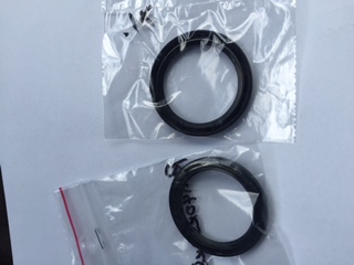

New Front Wheel Speedo Seal (a pain as I lost the old one)
Thanks to Ducinthebay (Phil) 40 x 52 x 5 Single Lip (which matches measure up after getting the numbers)

- New Seals Front Wheel 40 x 52 x 5 Single Lip.jpg (27.07 KiB) Viewed 15472 times

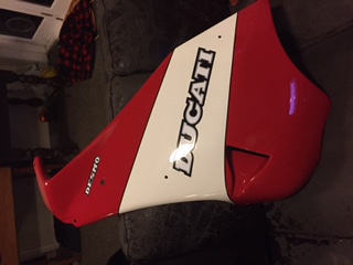

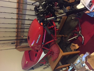

Re: 90 900 Supersport Tidy-up - The Fairings

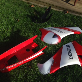

Tank Sealed, Rear Tank Mount welded with gusset (was cracked & weak), dings beaten, fairing cracks relieved, glass, etc, etc
Came up good ... used European Ford Radiant Red which was the only colour on the web I could find for the 89/90 ... albeit I gaurantee someone will correct that point for me now)
Dont care is bloody nice colour
Install new pump & filter when I get my hands on the right fuel hose (will post that)
So below from gravel rash & 25 years of use ...doesn't really show the damages but you get the idea
Anyone point me to supplier for front Tank silent blocks/Mount as the ones I bought (for a 900 supersport) are too thick?
- The Fairings.JPG (58.56 KiB) Viewed 15350 times
- Fairing Panel.jpg (26.91 KiB) Viewed 15350 times
- Tank Dry Fit.jpg (40.34 KiB) Viewed 15350 times

For fuel hose, make sure you get stuff rated for fuel injection, and that it can withstand immersion. I installed some stuff that wasn't, and it swelled up, and started leaking in a short time. Don't go with regular fuel line. The autoparts store can help you out. Also, use the fuel injection clamps that have the two flanges and the small screw and nut. The old style hose clamps just beat the life out of the hose and lead to leaks.
Good progress none the same.
I peiced together the rubber bushings for my tank. The blocks on the side are my reference (and I doubled them up, 2 per side) then I bent the flanges on the tank to accommodate the rubber bushings I could source at my local hardware store. Sheetmetal is always meant to be bent.

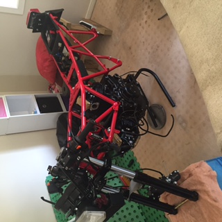

Engine is finally back missing a couple of parts that can be added once in Frame (albeit one is a swinger bearing which makes a little tougher but do able)
Bet you thought I had given up ...

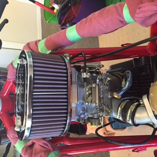

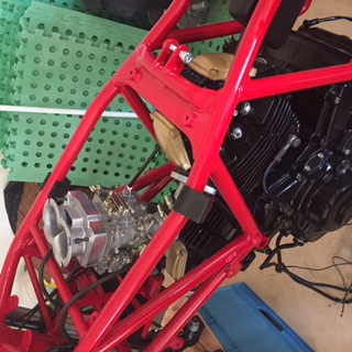

Overall with a couple of changes made to the machine I am no longer hung up on making as original .... so this means a few minor upgrades
The Carb will go with a K & N filter so in she goes .... starting to see nuances for the machine I have up to this point only read about .... here the carb goes on but doesnt sit exactly square to the frame (as it was from new)
The Weber looks good!
- Weber & T.jpg (60.49 KiB) Viewed 15006 times
- Weber & K & N.jpg (55.6 KiB) Viewed 15006 times

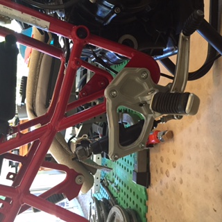

On with the FootPeg assembly I built a year plus ago
Clutch line in with new bolt & bleed
Now on the bit I am blOOdy dreading ... the wiring
Has been 2.5 years since this loom was on the bike & as per a lot of the posts I read before I took it apart (so I should have known better) .... I didn't take enough photo's
Electrics (the plan at least)
Upgrade starter cables which go on to new starter motor (with H/Comps in I didnt was to stuff around with an old starter) - Motelectric built this for me so will be cool to see if it fits (he was very accomodating actually)
Dyna Coils
Clean, Grease, check/tune each connector & Dielectric grease
New OEM Reg
