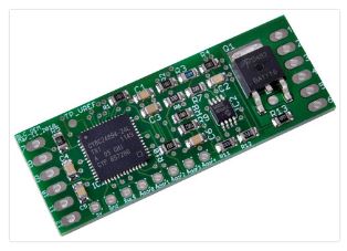

I run a 14point7 unit with my MyECU... but i notice that they also sell a controller (for a bosch 5 wire sensor) suitable for circuit board integration for $40 here: http://www.14point7.com/products/slc-oem
Wideband controller.JPG (22.11 KiB) Viewed 15496 times
