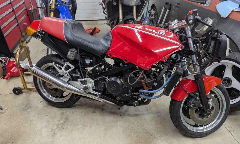

So it's been a while yes since I updated this. Not much has happened but... I did get new tires installed finally. I'll post later the date stamp but I can at least say they're just over two years old. Old yes but better than the 24yr old rubber that was on it. I'll scuff up the rotors lightly before I install the wheels and check out the brake pads also. Bike only has 14k on it so I'd imagine the pads are ok. I'll probably end up getting new ones just for condition sake. New chain will be here this weekend also, maybe install that if I feel so inclined.
Something that I have been thinking of now that I have the tires off - change the gearing maybe. As you can see here, chain was last adjusted in the middle of the rotation. Gearing right now is 15/38 with a 106 link chain. Bought a 108 link chain just in case I felt like going up two teeth or so; plus the chain was only $93 and I got it sooner than a 106 link one. I see I can get a new rear sprocket on Ebay but... how badly do I really want it, I don't know. Time for more research...

by Tamburinifan
Not sure about 750 Paso gearbox ratios but 15/40 or similar most seems to like.

by Mc tool
Mine is 15 / 38 but I had given thought to changing it , I mean if one can ride open road mostly in 5th without realising it probly 40 on the back wouldnt hurt . :)

by enginerd
I'll probably pick up the 40t just because it's available now, NOS AFAM piece in silver. Aside from the gearing to ponder over, next step is order some new brake pads all around; other pads are coated in rust dust. Besides, nothing wrong with new pads right? After I get that sorted I'll finish up the brake and clutch fluid.
Oh, any opinions on stainless lines? While staying original is nice, one can only imagine some black stainless lines would be a helpful upgrade... For safety, right? For the front brakes, I'm wondering about running a double line from the master cylinder for a hint better feel on braking. Well, that's my thought at least.
Here's the bike with fresh rubber now. :D
