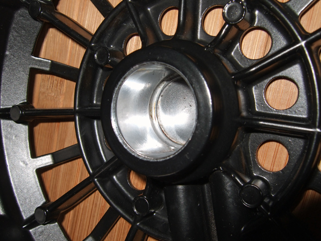

I just realised I posted the wrong photo above, here's the photo after it moved.
I think that was the correct picture as one can see the rust line has moved up.

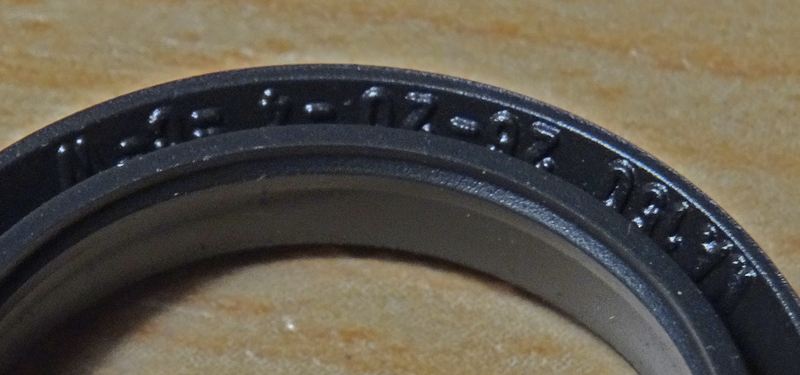

You could be lucky. I have a seal and although it's quite difficult to read it says NA150 26-20-4 and and bit farther away W which may not be directly related to the number. NA150 describes the shape of the seal. See pic below.
If a bearing shop doesn't have it or can't get it try a hydraulics shop. I'm certain there are alternative types that could be used as well.

Not sure what's going on with my computer but it was showing the photo with the cylinder down and now it's as you say
. Weird, I've had a couple of problems since posting again. Maybe it's this new computer....or the Wild Turkey
