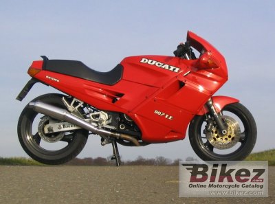

I too think a Paso belongs on 16" wheels. Here`s a 907ie and from this angle it just doesn`t look right. Specially the rear wheel looks too big. No doubt it may handle better, though. (btw the pic proves that the Contis also fit on a 907ie)Why aren't you guys going the 180/60-16 route?
I think the era of 17" wheel conversions on Pasos is about over. The common reason to do this was that there were no tire alternatives which infact always existed. The 150/80-16 is what many go for although the tire is not made for a 5" wide rim. Ducati Germany approved it though. Although it`s a tight fit there`re about no modifications required except for lifting the front fender, a longer chain and turning the rear excenters way back. You lose most of the way to adjust the chain, but there are numerous sports tires in this size.
The 180/60-16 which is a perfect fit for a 5" rim requires spacing out the front and rear sprocket or the chain will hit the tire. Many 180/60s are for heavy tourers, only one or two manufacturers recommend their models for customs, sport tourers etc. one of them being AVON. I chose this option.
While I will stick to the 180 I guess in the longrun the 150/80 will be more popular as you don´t have to machine any new parts.

you're right, perhaps the 907 does'nt look good with its 17" rims, even if I think also Pasos don't look so good with 180/60 16" rear tire.
Too big, too.
P.S. I have the same 2 in 1 Conti on my 907...
Too big, too.
- Posts: 5571
Re: Swapping wheels to 17inch
true the 180/60 is big but it´s by far not as high as a 150/80.

I do agree the the photo of 907 (above) looks a bit funny - but I think this is more the black rims with black tyres and because it is sitting up on the centre stand!
