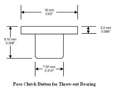

I used Gerhard's diagram and made another one. I'm planning on stopping by a machinist buddy's place today and see if he can make me a couple of these. I'm picking up the replacement throw-out bearing this afternoon, also....
I'm hoping to have the Paso back together by this weekend so I can out a couple hundred miles on it.

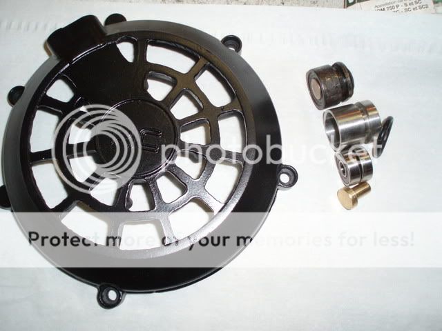

Gwenadu
Re: Clutch Piston
1st time I try to put a pic...
Alain.
I fixed the pic post code. There is a "Hot To" in the FAQ section.....
Alain.

I got the bronze button machined by my buddy and have the Paso back together and the clutch bled. If all goes well, I may take it for a spin around the block this afternoon, and then I plan on riding it a couple hundred miles this weekend. It's supposed to be bright, sunny, and about 70-degrees (F) this weekend.
