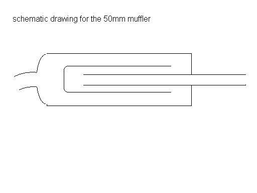

Not so mutch to develope:
The surface of a 50mm can is about 1962 sqr mm, so I tried to have a similar value also for other cans.
This to build something that works like a 50 mm pipe with 1.5mt lenght.
The end I took a 75 mm can and a 92 mm can to build my muffler
Here's an idea abotu what I mean:
have a nice ride, Nicola

Post by Tamburinifan »
The muffler only controls back pressure & sound level.
Length of headers is another story.
Long way for gas inside muffler usually used for keeping volume down. Often used in car mufflers.
So, what are you trying to achieve with 1,5m 50mm pipe?
I just want to understand. :thumbup:
ducapaso
Location: siena, italy
Post by ducapaso »
A shorter 50mm pipe had a great deal of troubles...
2500 rpm for idle, cutoff of power at 7500 rpm and so on.
I don't know why it happened, but I tried a smaller pipe (28mm)
that ran good but with very low power; a 40mm for a 1.2mt nominal lenght and ran better then I made this and just try...
Moreover, I must say I'm not sure about engine conditions: It's a very performing unit and it "might" have some "non stock" part, but I can't be sure about... I never opened the engine!
