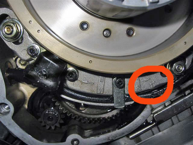

Hi,
a friend of mine is prepairing to optimize his ignition. He would like to correct the ignition timing of the rear cylinder also to improve the engine`s smoothness (which is only possible with some modification). Appearently the ignition timing of the rear cylinder is by 2° less advanced than the front cylinder to reduce thermal load. The pick up bracket seems to indicate this, too. The strange thing is that noone, incl. some Ducati mechanics seem to know about this.
Anyone out there know something ?

It`s not a mistake that has to be fixed. The engine should run smoother when removing this though. The question is how much thermal load will change.
Some random thoughts: if the timing is not set correctly the rear cylinder may be more than 2° off. Causing the engine to run rough. Some guys report that the engine runs better when the carbs are not perfectly synchronized but adjusted slightly towards the rear cylinder.
A friend measured the degree marks on the flywheel and they are accurate. Hence due to one pickup being 2° off the marks on pick-ups and flywheel don`t perfectly match. Only one mark can. So how do shops adjust the pick up (bracket) ? Considering that noone asked knew about this they probably set the pickup bracket to the "middle" meaning they try to match front and rear marks which in the end causes both cylinders to be more off correct timing.

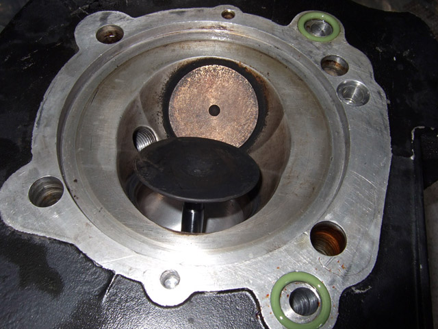

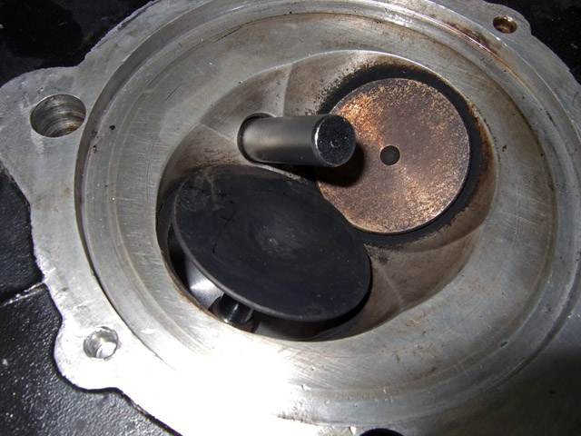

Re: Cam Timing
It`s mentioned in the file:
This is specially the case if larger valves are installed or cams with increased lift or like in my case both.BE VERY,VERY GENTLE WHEN ROTATING THE ENGINE WITH THE
PISTON STOP IN AS YOU DON'T WANT TO PUT THE STOP THROUGH
THE TOP OF THE PISTON.ALSO, DO NOT ROTATE THE CRANK A FULL
360 DEGREES WITH THE STOP IN AS THERE IS A CHANCE THAT THE
VALVES MAY MAKE CONTACT WITH THE STOP.
