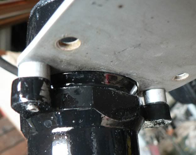

Here is a photo of my excenter position:
I put the camera under the bike to get this photo of the tyre clearance:
Clearance is 19mm in the centreline of the tyre, and 10mm at its closest point. I also rechecked the chain clearance using an Allen key as a more accurate guage and it has 8mm.

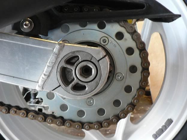

So with a couple of jobs completed on the motor and the exhaust repaired (at last!), it was time to begin final assembly.

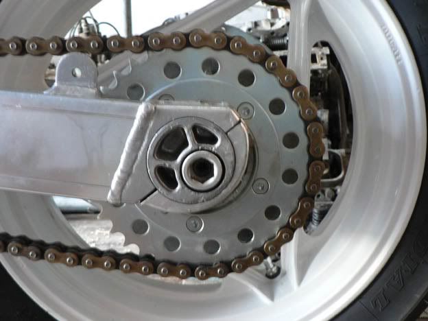

I had acquired a chain guard (missing when I purchased the bike) so worked out how much to move it over. It looked to me that originally the front of the guard would have fitted inboard of the mount, but it was enough to assemble it on the outside of the mount and make a spacer for the guide. Remember I'm looking for 10mm so with the guard 4mm thick I made a 6mm spacer about 25mm in diameter. The sequence is mount, guard, spacer, chain guide. If you plan ahead, stick the spacer to the guard with some contact adhesive, otherwise tape it to a rod to get it in position and use a lot of bad language! You will need a 30mm bolt.
For the rear mount I made another 6mm spacer slightly smaller at 20mm in diameter to go between the mount and the guard - with a nice stainless washer and 25mm dome-head cap-screw:

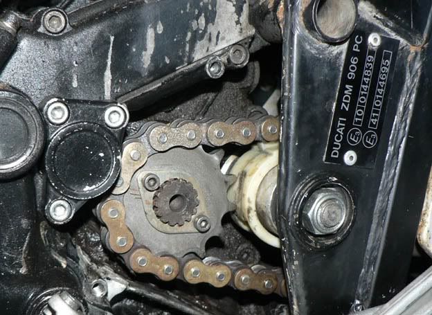

It was after I'd struggled to get the exhaust on for half an hour that I hit a snag. The left hand centre stand bolt was loose and when I tightened it and lifted the stand up, it hit on the chain!
This came as a shock as there was no problem when I rode the bike, but the loose bolt must have allowed the stand to twist away from the chain. I will have to grind away part of the foot to get some clearance.
I ran out of time to do this so it will be my first job on the project in the next day or so (and it may be a good idea to replace the nylon pad too!). Not a big one to overcome, but another thing to take into account.
If you are intending to do this mod, check your chain to stand clearance before you start, so you know how much to alter the stand.

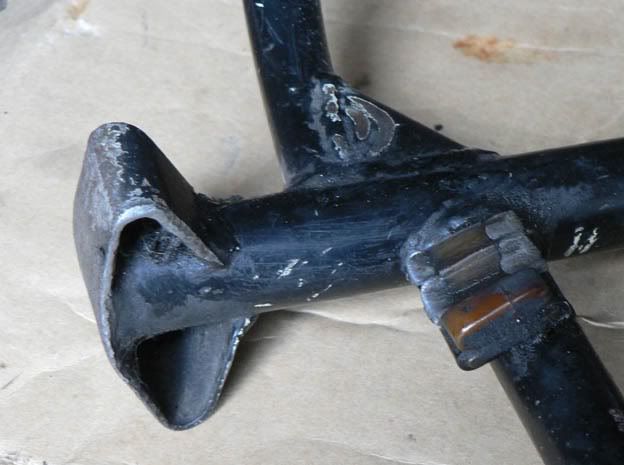

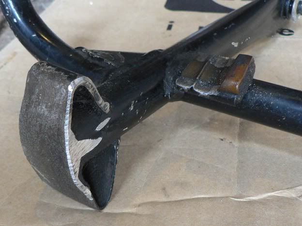

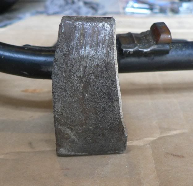

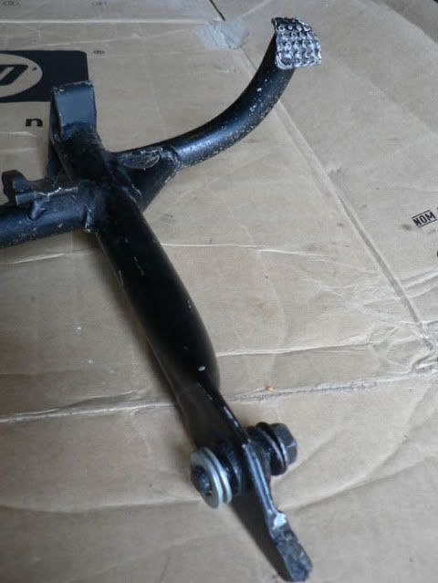

I managed to spend most of my Sunday on the Paso. First I ground away part of the centre stand foot for some chain clearance.
I wasn't sure if this would be enough. When I offered the stand up to the mounts I found there was quite a bit of side clearance so I added a couple of washers to the inside of the stand:
This was enough to give me 2mm clearance on the chain. I figured when I'm sitting on the bike the chain will be higher so will have more clearance. There will be times when you go over a rise and the weight comes off the bike but I will keep an eye on this area to see if there is any sign of contact.

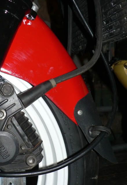

Next I fitted the front guard. I made up these spacers for the fork brace/guard mount:
They are 12mm diameter and 7mm thick. I used 4 stainless steel dome-head allen screws 6mm x 20mm long. I didn't finally tighten these until I had fitted the axle. I had to file a little out of the curves on the ends of the brace so it would fit up inside the forks where there is no groove for it.
With the Dunlop 130/70/16 fitted there is virtually no clearance on the sidewall inside the mud guard. Thankfully my bike has a mudflap fitted and the speedo cable loop is mounted on that otherwise I couldn't fit it:
