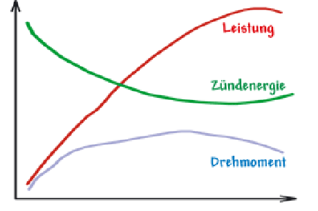

In detail. Typical 4 cycle engines at maximun torque have the lowest consumption and the lowest demand of ignition power (30-40mJ). At lower rmp ranges were the carburation is more difficult and the specific consumption increases the demand of ignition power can increase drastically. Depending on combustion chamber, exhaust and timing it can triple (90-120mJ). At max. power output and during accelleration the fuel demand and the demand for ignition power increases.
Original coils will supply about 40-50mJ. (a DynaCoil ca 110mJ - therefore what most people note first is the improvement when starting the engine).
red: power, green: ignition (spark) energy, blue: torque
The secondary power of a coils is usually not a problem as most range over 16kV. At operating temperature a spark plug requires about 12-13kV to build up a spark and 16-18kV when it`s cold or the spark plug is dirty.
The power output will be reduced if the coils are not supplied with 12-14V (typical voltage loss on most carbed Pasos seems to be at least 2 volts, therefore the wiring mod). Spark plug wires can age. The core can brake (typically the cables with a carbon core) or the isolation can become brittle and the spark may jump to the frame or engine. (I did find both symptoms on a friends Fiat Spider 124)
