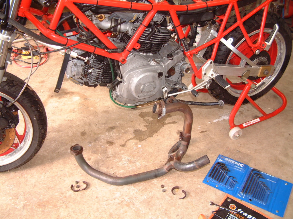

Did'nt get a lot done today.A bit more paint removal and also took the exhaust system off.
I think there's potential here.Thanks G:thumbup:.

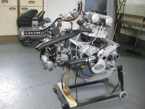

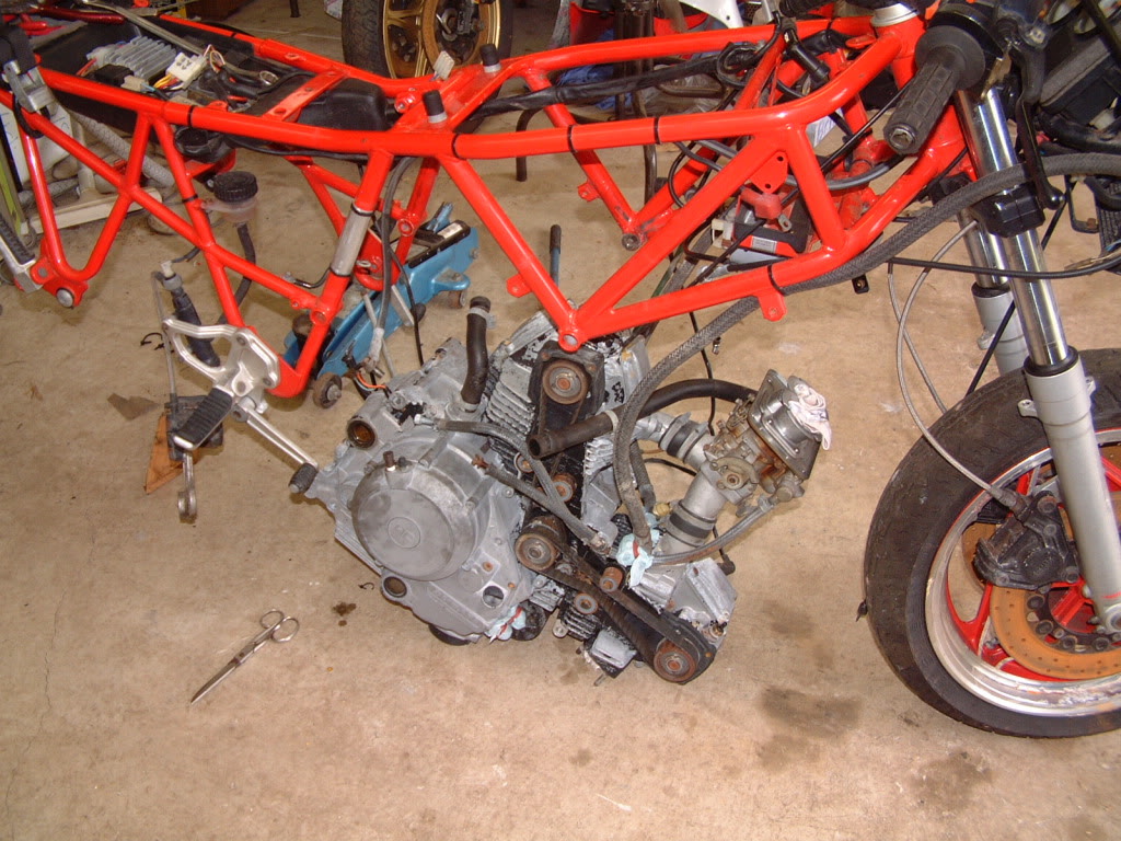

Having several bikes you probably have a rear wheel stand. If so you can use that as a motor stand.
Maybe don`t use a hammer in front but something more stable :)
(found on the internet)

paso750 wrote:Having several bikes you probably have a rear wheel stand. If so you can use that as a motor stand.
Good idea G.I might knock something up similar :thumbup:.
A2

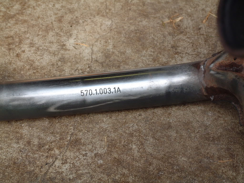

On the 600 single exhaust I can tell the diameter is smaller compared to the system we have.
Good luck fixing your bike!
Greets Joep
ducinthebay
Post by ducinthebay »
...And I can tell you that the stock header pipes on the Paso and Sport are smaller than for later model 900 motors and aftermarket. Although I haven't tried it, the headers from a 900 motor should work, but you may have to trim the back pipe going into the collector. The angle at the exhaust flange seems to be unchanged, but the added stroke moves the heads a bit farther apart.
The one 2 into 1 exhaust that was made for the Sport was the Gia-Ca-Moto. I have one on my bike. I think Conti made one also.
If you search the aftermarket pipe manufacturer's websites, you can see how interchangeable their pipes would be.
For routing, anything that fits later SS models should fit the Sport. This is not true with the Paso, as that swingarm configuration lead to a very unique header pipe. Of course the rear hanger attachment would need to be modified, but that's easy enough.

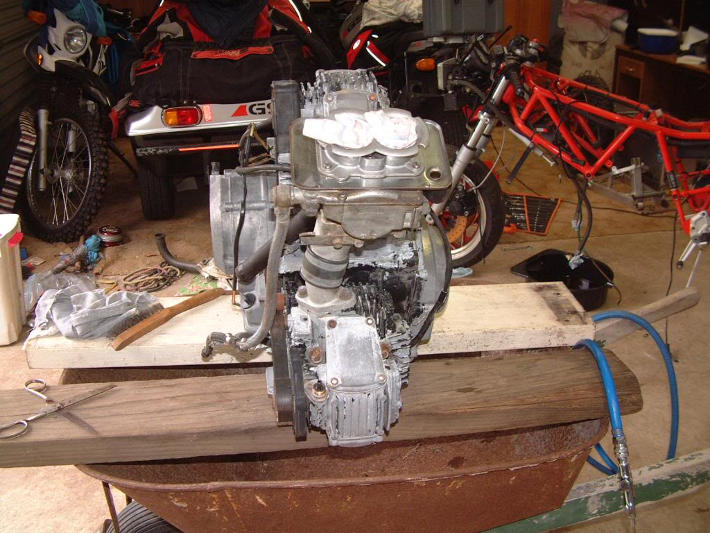

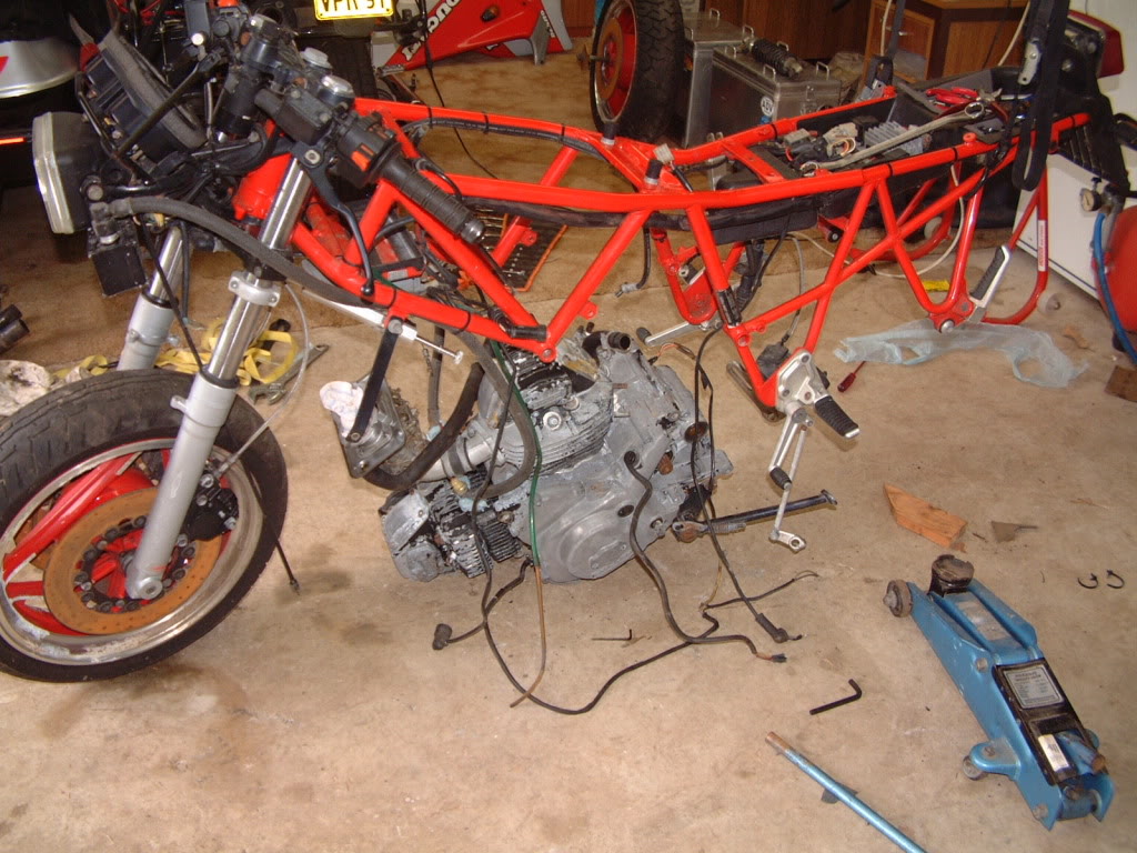

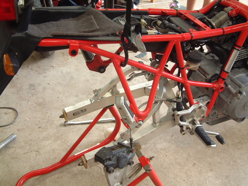

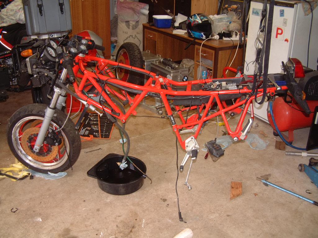

Now back to the Sport.I dropped the motor today.It all went easy...too easy :dunno:.The swingarm came out ok.
Everything seems ok.Disconnected a few bits and pieces and the motor came out without a problem.

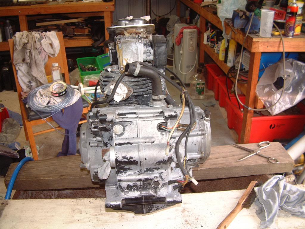

I then put the engine on my pre-fabricated engine stand which is a bit different from the photo that G put up :lol:.

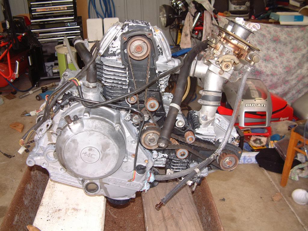

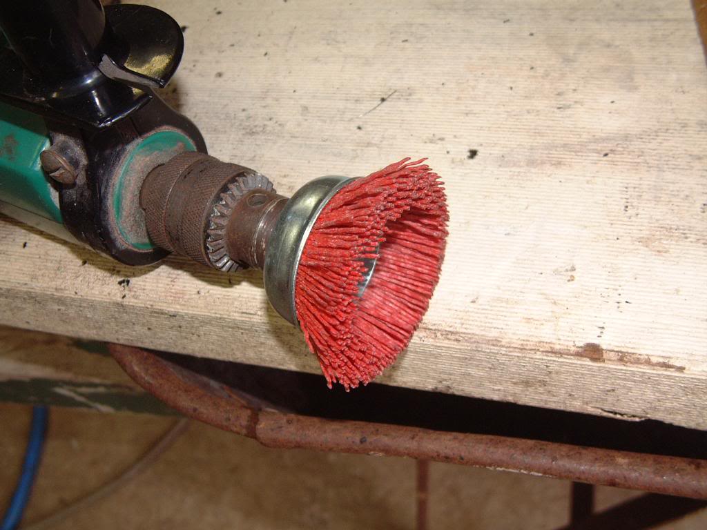

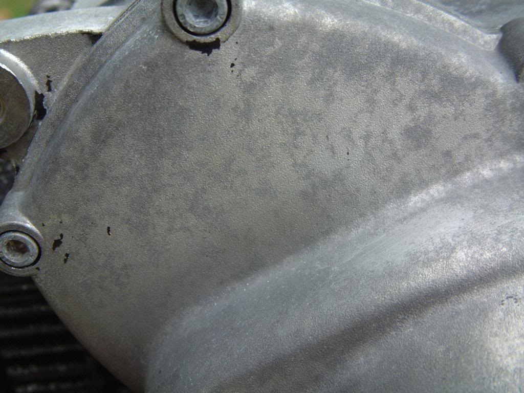

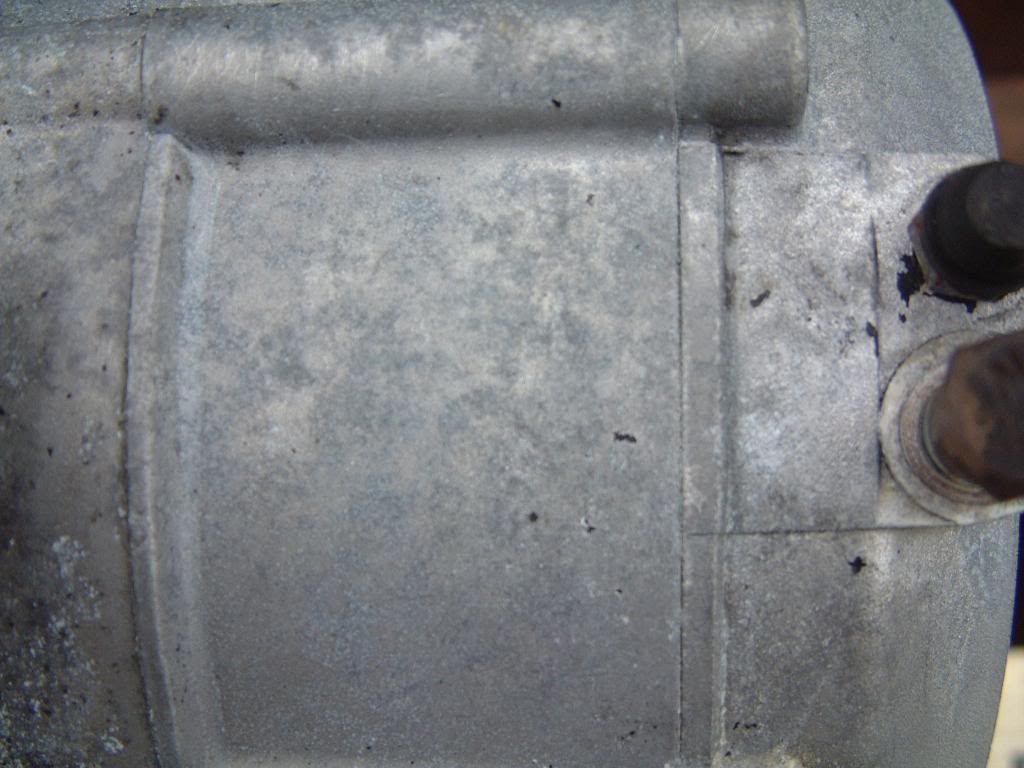

I spent a bit of time cleaning as much old paint off that I could.Unfortunately I've still got these stains on the alloy which I can only get rid of by using something like this.
That's ok for the parts that are easy to get at bit there's to many areas I can't reach with it so it looks like the bare alloy finish I wanted won't happen unless someone can come up with an idea.I've tried different cleaners but nothing seems to work.
This is the finish I can get with the above tool....
....but how to get into all the nooks and crannies.

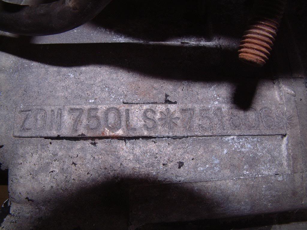

Here's the engine number if it means anything to anyone.Does it tell what number off the line it is or anything?.

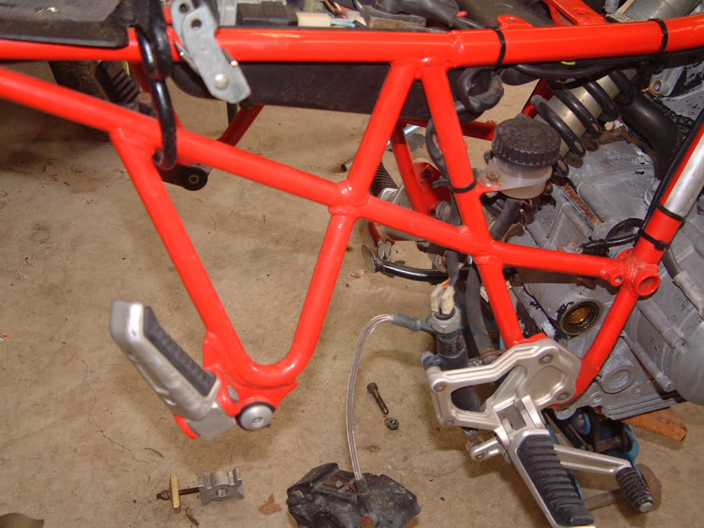

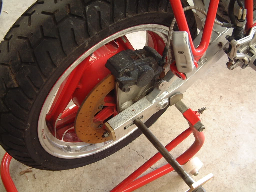

ok, you asked for it. :mrgreen: Go back out in the garage, look for a wire and tie that rear caliper to the frame - now. You may also replace that rag in the engines swingarm bushing with tape as the rag won`t really protect from dust.
Nice engine stand btw. :)
So what`s the story about the other bike, what happened ?
