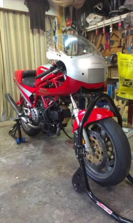

Track Day coming up on Friday, I'll be in the geriatric's group.
Woo as they say Whoo
- Track Ready.jpg (72.9 KiB) Viewed 12366 times
