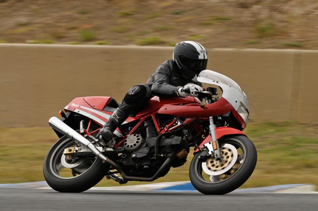

Posted: Mon Sep 23, 2013 9:51 am
by bmw851
Old fart on an old tart, sounds a bit rude me thinks, but true, apologies to the “caring understanding nineties types” out there.
Finally got the old girl out for another (absolute spur of the moment decision, sorry Andrew next time) track day at Eastern Creek, and finally a run on the 17’s, actually got in 2 full sessions before torrential downpours ended the days proceeding’s. (That equates to nearly all of a whole 14 laps on the old GP circuit)
What did one learn?
Do make sure your tyre warmers will actually fit before the day, particularly the front :mad: .
Do scrub in your grooved slicks before the day :banghead: .
Don’t drop your tyre pressures to counter lack of tyre warmers, which will then encourage lurid rear end slides from your Ducati because of under inflation, it’s just plain silly :choo: .
Don’t be a big nancy boy (again apologies to the 90’s types) and take 2 sessions to start getting into it :wacko: .
Do believe your Doctors when they tell you that riding with a couple of fractured vertebrae and a not happy collar bone/elbow and wrist may be painful and cause more damage, and did. (A long sad and tawdry story, part of why a chap has been so quiet on the site of late, but I’m over it, Hamish the door is open go for it and it had better be good :lol: )
Do ride as many laps as you can, whilst taking as much Ibuprofen as your stomach can handle. :smoke:
Do out brake people into corners. (Bastard)
Do be a SAB and ride around the outside of guys with their knee down and think their last name is Marquez, only because you can. (Smart Arse Bastard)
Do be a mongrel and out brake same said people when they make you look like your sitting still while doing 200 Kph down the straight, and of course block them mid corner and then make ‘em work for it. (Absolute Smart Arse Bastard)
Do accept the fact that there are some much, much more seriously faster people then you out on track, and get out of their way with as much style and graciousness as you can.(Not so smart arse bastard after all) :oops:
Yes a chap had some serious fun, and was the $2000 to convert worth it, hmmm, I’ll need another track day then let you know……………….. :thumbup:
A very sore, but worth it :beer: .
Peter
