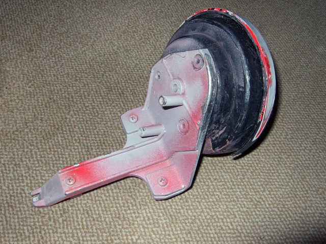

Re: New member - in need of some advice ...

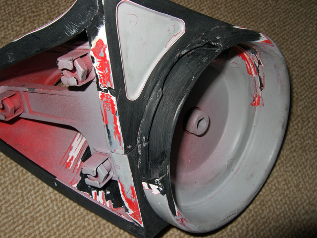

Has anyone an idea how to completely dismantle the mirrors?
Mine are badly damaged and after unbolting the mirror I can't see how to remove the alu part from the plastic (is it glued?).
I have seen an original for sale ... €300
so that means the original will have to be reconstructed by me.
Anyone?

Frank, if you mean the triangle but: it is clamped on the mirror. Will send you a pic of the inside if you need one.

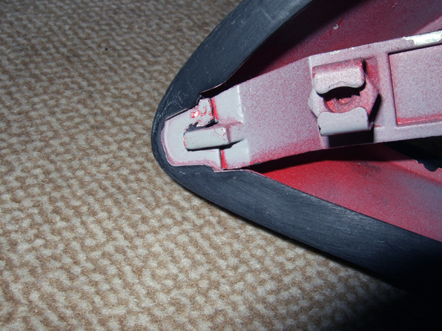

Hi Léon,
Want to know how to get the plastic shell separated from the alu part where the glass is screwed on....
The plastic is badly broken, want to strip the paint from it and repair it with fiberglass but first I have to get the alu frame out of the mirror.
The main difference in the airboxes is that the one of the 906/750S have the crankcase breather tube attached to the front bottom while on the P750 airbox it`s to the front.At first sight they both fit, the 906 is marginally bigger .... preferences?

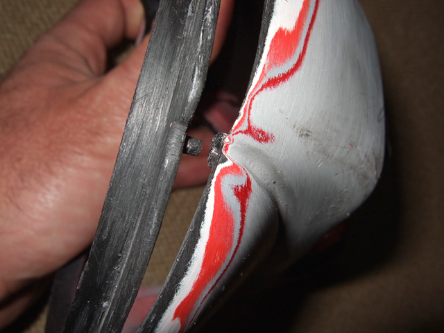

While the original snap on mirrors are made from around 26 single parts it is not possible to completely disassemble them. The mirror pod is held on the alu frame by three pins which were heated so it`s a kind of rivet connection. The mirror pod is glued to the mirror housing. The front of the alu frame is held in place by a little metal plate.
While it is possible to fix mirrors with fibreglass I would rather use a good two component plastic glue as the housing is as you said plastic. The bond will be better, it`s easier to work with, you`ll ad no material etc.
If you really need or want other mirrors I have some spare ones.

Hallo Gerhard,
Mine (left) has multiple and deep cracks and was very badly repaired.
I bought another one from Rudy but that was as bad as the original.
Have seen the Cagiva freccia mirrors but, although I really hated the Paso mirrors when it came out in the mid 80-ties, I consider the mirrors also as one of those typical iconic Paso items and as such I prefer to get the originals back on (but in good/perfect state).
Once I removed the glass I got the following idea: I drill the 3 "rivits" and I could, at a later stage replace the rivits by 3 bolts or something like that (or melt it back) since there is sufficient space between the white glass carrier and the pod for an alternative fixation methode.
My main problem remains to get the pod removed from the main housing and I assumed it was glued, something you have confirmed.
I will try to find a way to separate the pod and the main housing (it is already loose at some places).
Once that has succeeded I should be able to take the mirror fully apart and repair the pod and main housing, no sweat!
If anyone has an idea how to get the pod loose from the main housing ..... feel free to share your thoughts

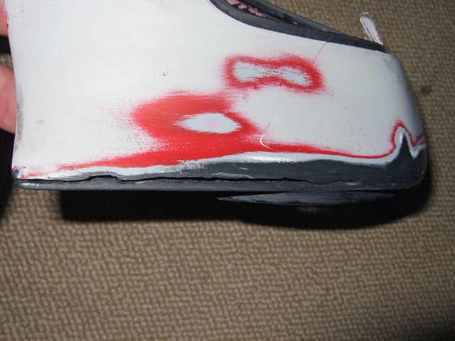

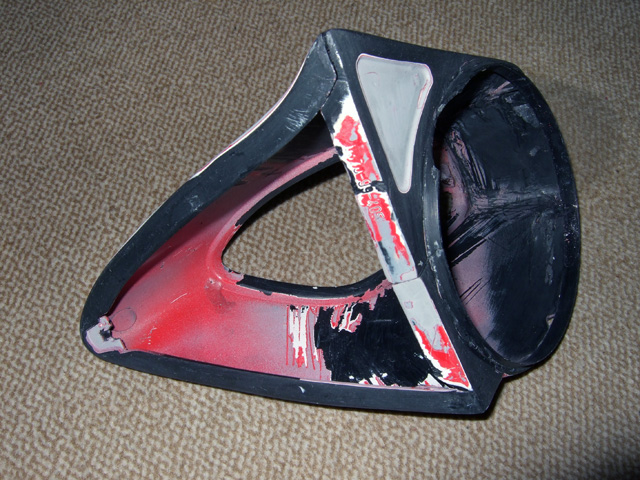

this is one I split as it was fixed with glassfibre. The cracks in the housing were already there. Levering the pod off resulted in a part of the border breaking off although I used no sharp or hard tools and little force. It will be like new when finished although it doesn`t look that way

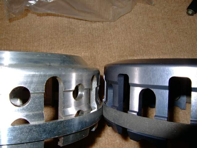

I've seen a beautiful clucth basket on e-bay but have no idea whether it would fit a Paso 750 or not.
It says for all Ducati dry clutches like 851, 888, 916 etc.
Nevertheless I'not sure this means it will fit a Paso 750.
Any idea if they are similar?
it will not.
If on ebay or anywhere else it says "fits all dry clutch Ducatis" that means everyone post 1990, hence not F1, Pantah, Paso 750/906, Sport, early 900SS or Cagiva Elefant.
The clutch basket of the P750 has the groove for the circlip and it`s is deeper
