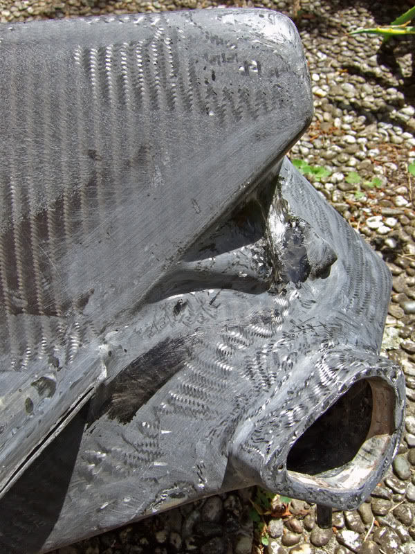

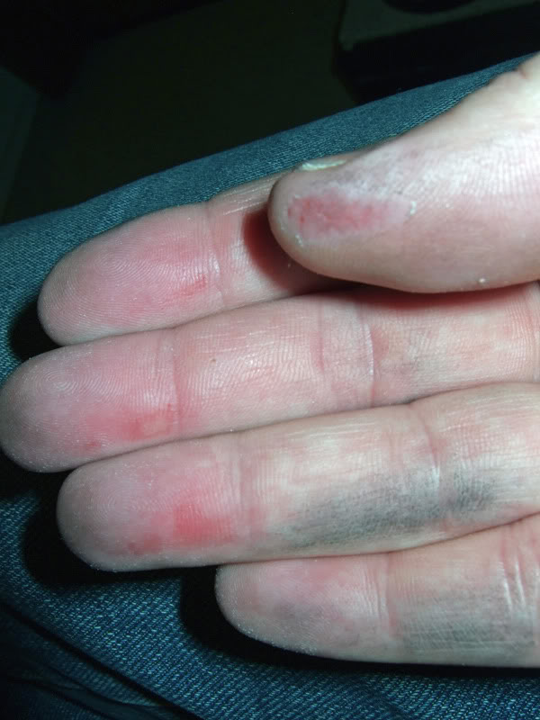

Figure, yesterday I started at about 10:00 and finished at 20:40 with a total of maybe 1h of break. Way over half the time was dry sanding. (wet would be better but as I still want to laminate later the day and with the current temperatures the parts won`t dry fast so there`s no choice).
I should post a pic of my thumb as I do not use gloves and I do not use machines either. The good part is after a blister comes another and then come callusses. At least then the finger won`t hurt and the skin won`t become so thin the blood starts seeping through. Which usually happens at the second or third day. When that happens I tape the fingers and carry on. Call me crazy but I want to finish this.

paso750 wrote:Figure, yesterday I started at about 10:00 and finished at 20:40 with a total of maybe 1h of break. Way over half the time was dry sanding. (wet would be better but as I still want to laminate later the day and with the current temperatures the parts won`t dry fast so there`s no choice).
We all love our bikes, so often we do some madness.
But, someone loves them more, someone less...
:mrgreen: :mrgreen: :mrgreen: :mrgreen: :mrgreen: :mrgreen:
Ciao :thumbup: :thumbup: :thumbup: :thumbup: :thumbup:

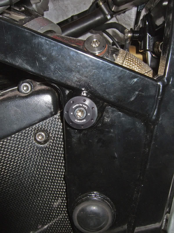

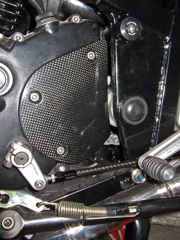

During winter when it was too cold to work in the garage I looked around for some nice bits for myself so I got some frame plugs (22mm), a new shifter rod, rear axle plates, replaced the rear axle as the old one was scratched, got a set of black Brembos (to match the rear black caliper) as the current front Brembos are golden, an ultrasonic bath as I always wanted one, a laser chain tool and some other small bits.
These are a much better guide than the flimsy original steel parts.

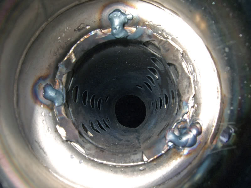

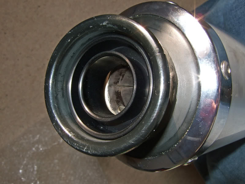

Meanwhile I found some db killers for a BMW that could be modified to fit in my L&W cans. That thing in the end is a fake db killer which I took as it looks much better with it as when you see the spot welded cone only. This still doesn`t make them legal but less noticable by noise and looks.
(Baukes old 906 with L&Ws)

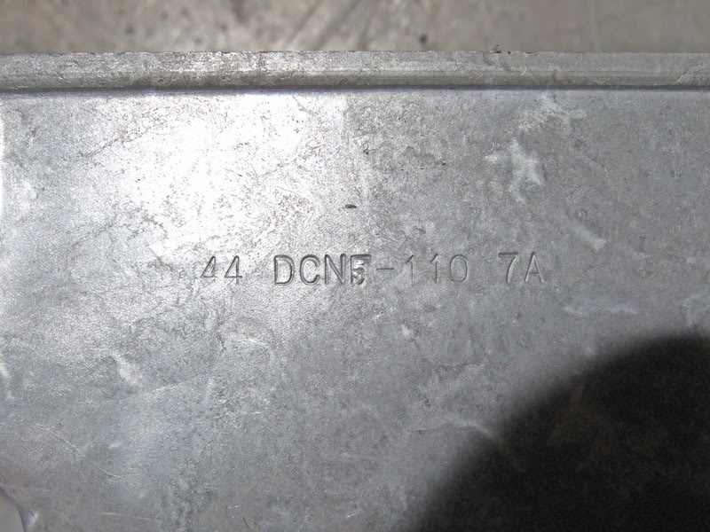

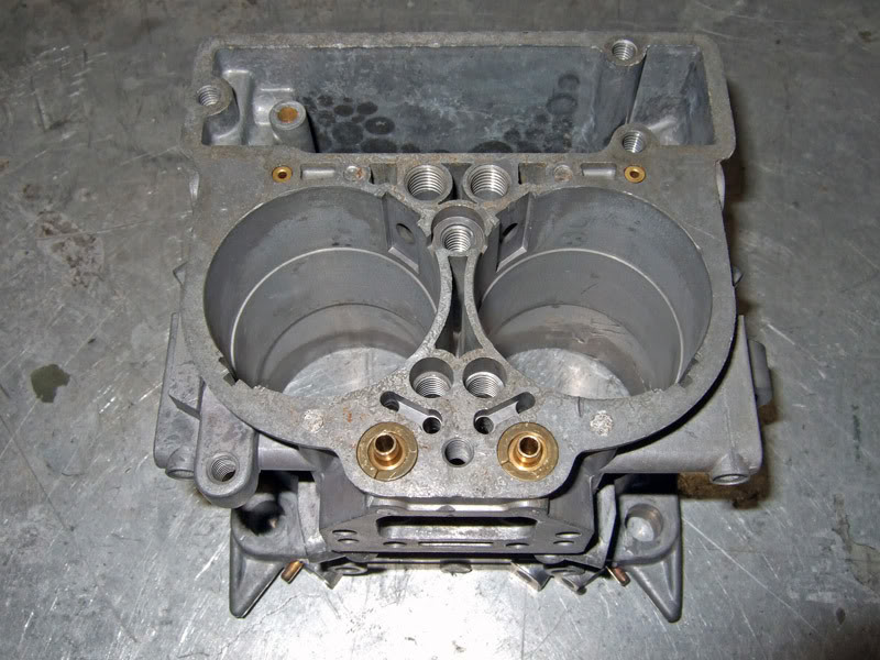

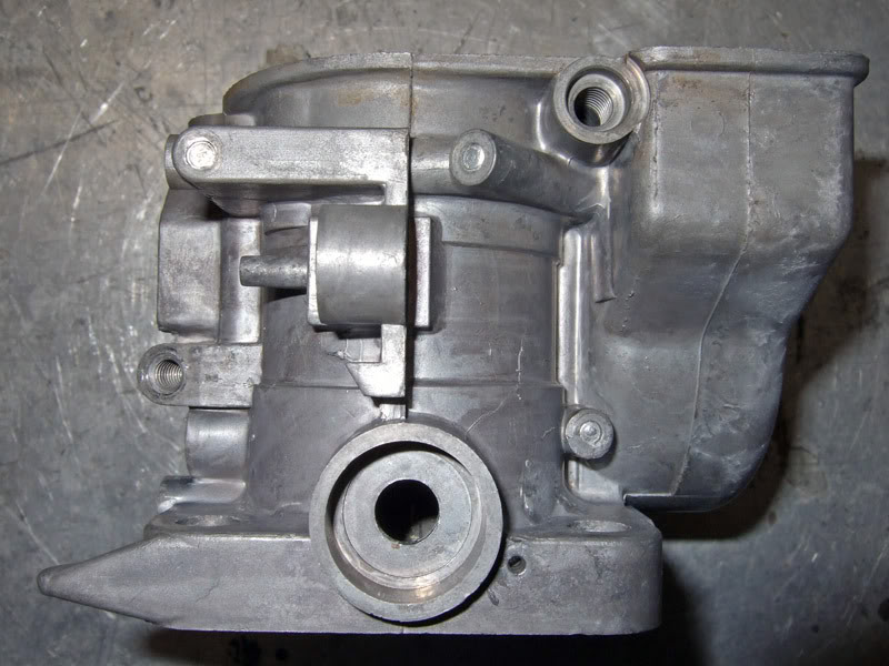

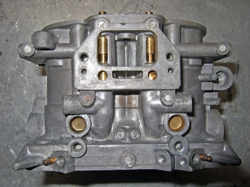

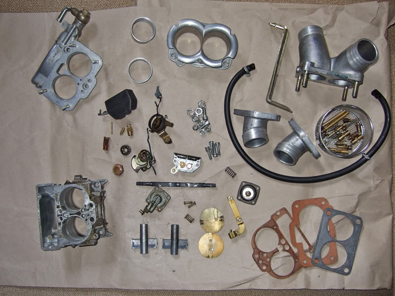

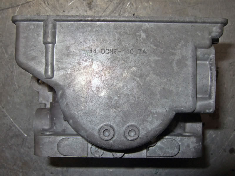

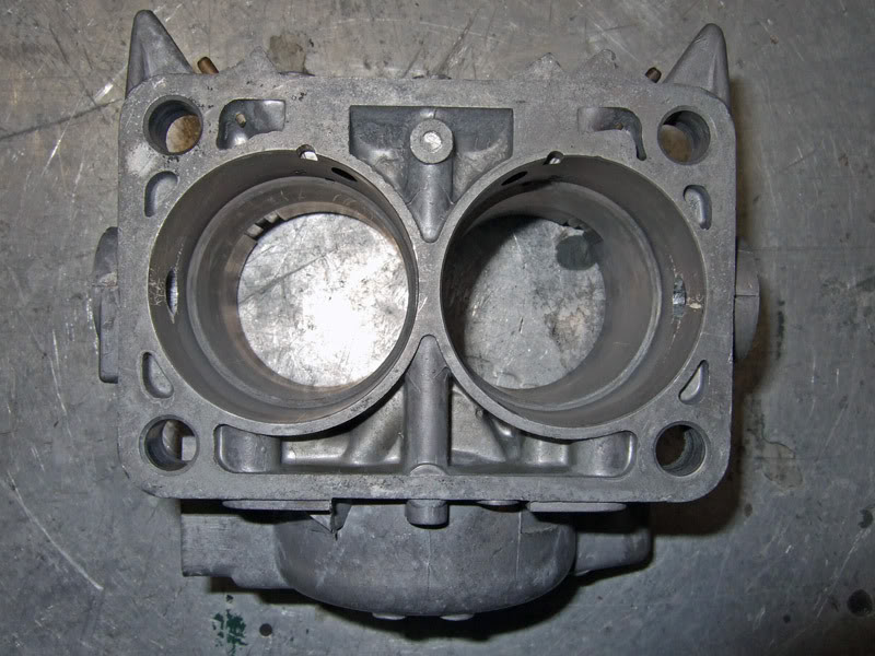

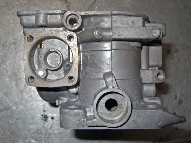

As it´s the easiest to pass vehicle inspection with a bike in near original condition the next step towards completion was rebuilding the Weber. The Weber was completely stripped, cleaned, all seals and gaskets replaced. A set of jets was ordered same as a new throttle axle (expensive), new throttle plates, throttle axle bearings and a bottom gasket which was not so easy to find. Well over €100 spent only on parts :banghead:
The typical residue in the float chamber if the fuel isn`t drained before storage.

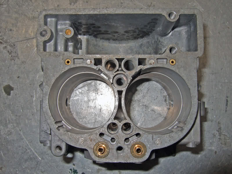

Of course the jets below where removed before ultrasonic cleaning. This was the beginning of reassembly.

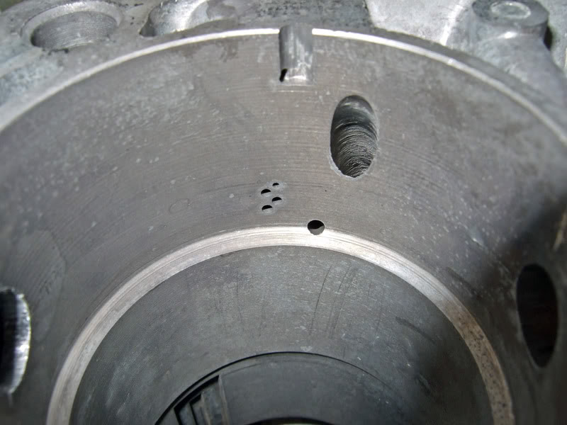

The progression holes, the small group in the middle. There seem to have been different models of Webers. My Weber/Dell orto (DCOE, DCO/SP & DHLA) book says "Both manufacturers have made emission versions of their respective carburettors, but these are not as good as the 'universal performance' versions, in terms of best possible all around accelerative and top end performance. Note that one of the quickest ways to establish at a glance wether a sidedraught Weber or Dellorto carburettor is suitable for high performance use is to count the number of progression holes. Any carburettor which has two or three very small diameter (1mm, 0.040inch) progression holes will have a rich progression phase, all other factors being equal. Carburettors with five quite large diameter (2mm/ 0.080inch) progression holes will have a weaker progression phase, all other factors being equal." I wonder if this is valid also for the DCNF.

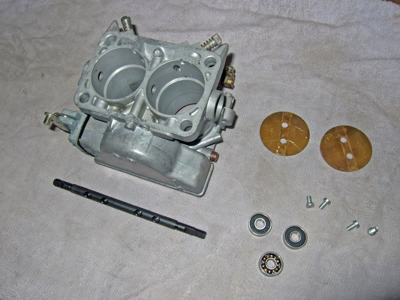

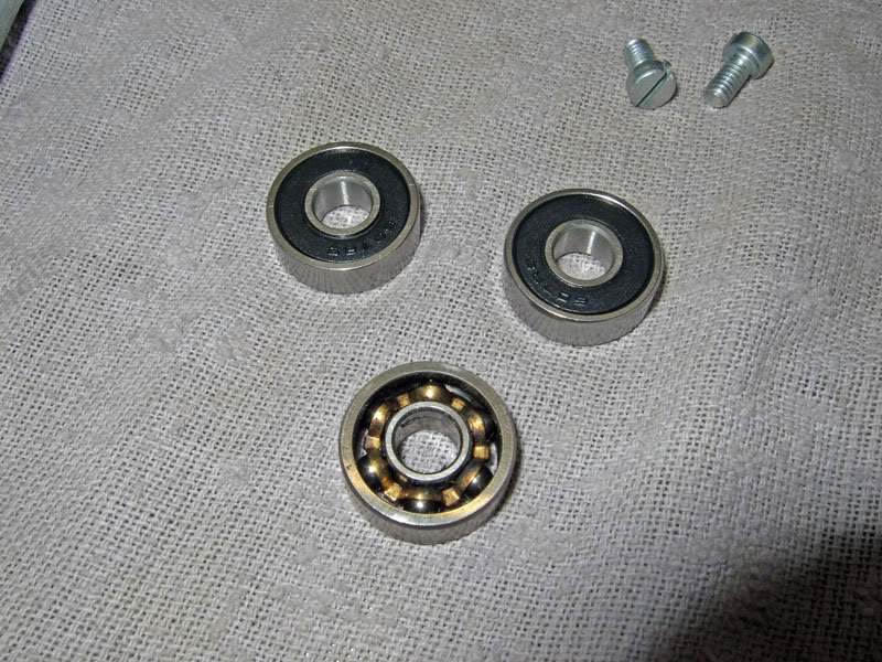

The old bearings where moving rough which only could be felt after the return spring was removed.
I read that the open original bearings could also be a reason for leak air so I got sealed ones.
Adjusting the throttle plates to close as perfectly as possible was a pita.

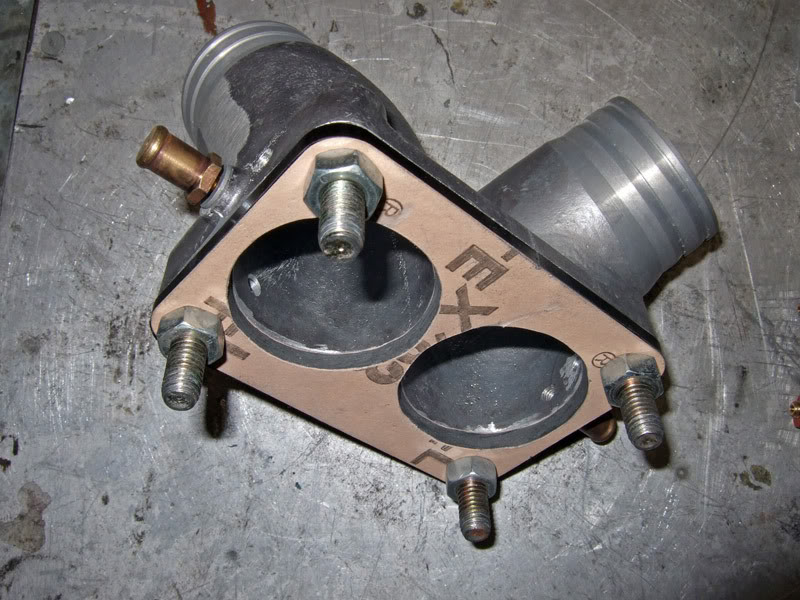

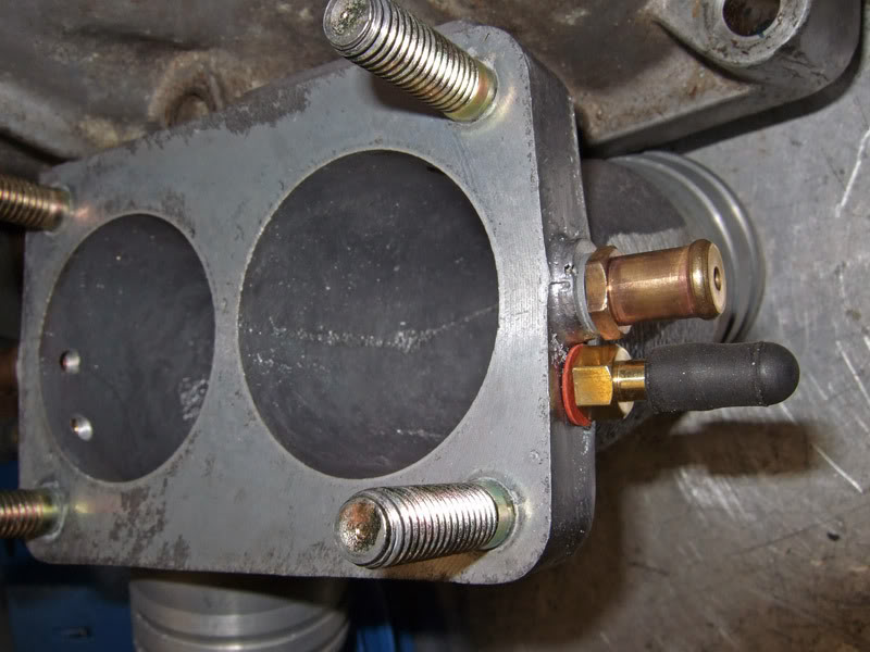

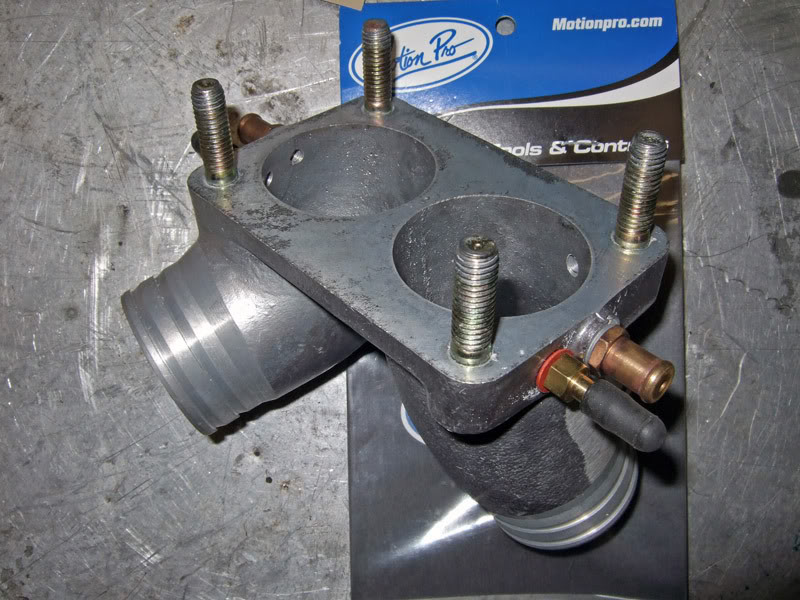

As I couldn`t figure out which base gasket was the correct one I got the phenolic block and the thinner graphite gasket. I guess I`ll see if the airbox hits the tank or not.
The phenolic block was impossible to find for the 44 so I had to get a smaller one and modify it.
The inlet manifold got additional screw nipples as I will use an underpressure fuel pump and valve. If you don`t how would you measure syncronization if there isn`t a second nipple ?! Also it may come handy if one day I decide for a Scottoiler.

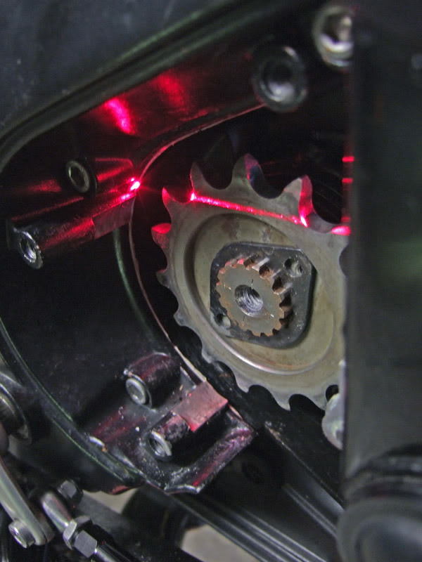

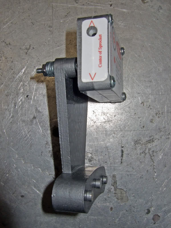

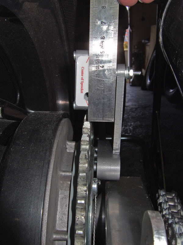

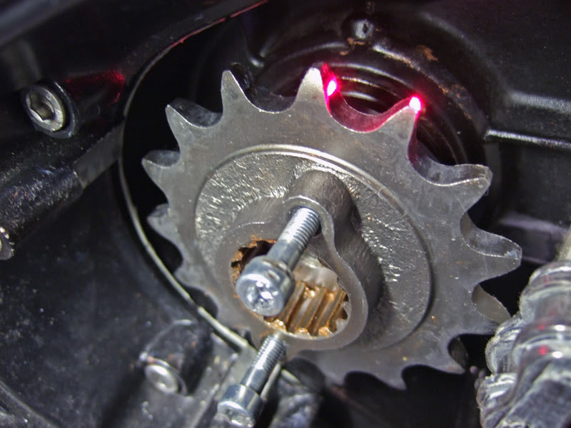

the laser chain tool

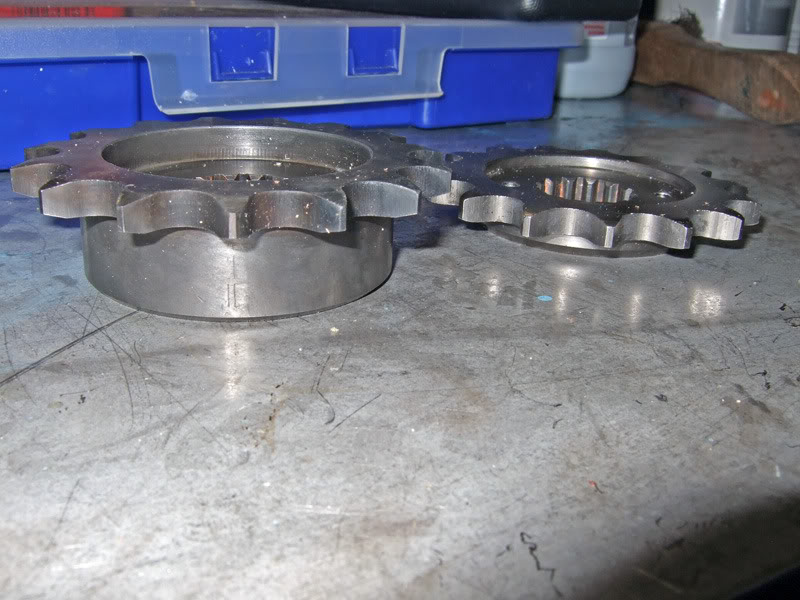

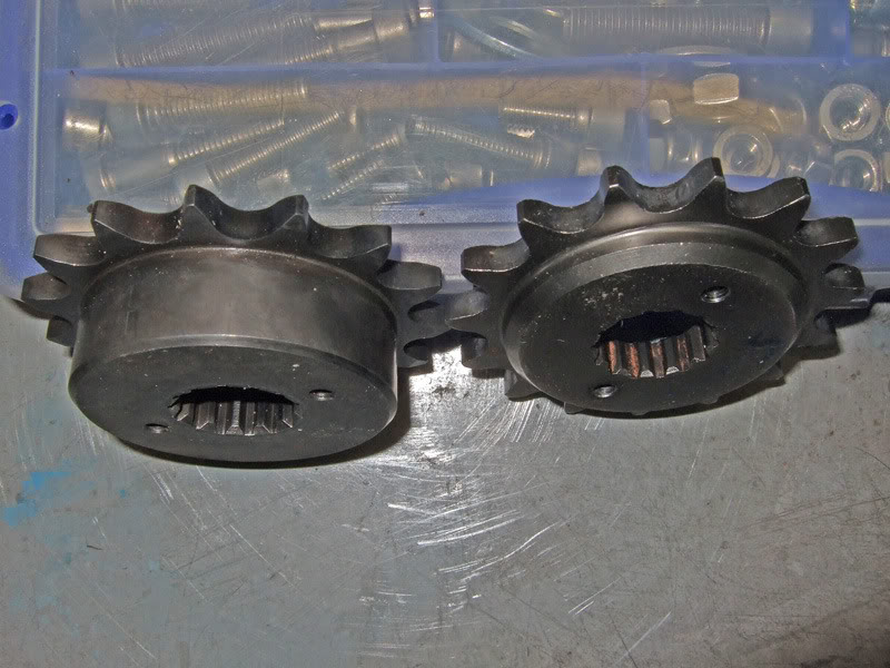

The original sprocket was of course off due the rear spacer
The offset sprocket is just fine
However, not being 100% convinced of my solution I had a custom sprocket made. It costs about 5x the price of an original one but I´ll sleep better now. The new sprocket has a few mm more offset than the original one. I`m not writing how much as it`ll only confuse as I doubt there`s anyone out there with the identical setup.
The shocker came the first time the new sprocket arrived. The shop meant well making the sprocket quite thick to prevent whobble but 390g vs 190-215g original was not acceptable. I had sent them correct drawings they ignored as they probably thought they knew better. No matter it didn`t fit anyway as the drive shaft is not that long.
They claim 7-10 days for a new sprocket. In my case it took amost 4 weeks for the first shot. Of course it was not their fault but the fault of another shop who does the hardening. They just hadn`t gathered enough parts yet to make it economical.
The sprocket was sent back with an original one and turned down to identical thickness.
When received 2 weeks ago I had to notice it still didn`t fit as obviously unlike many other bikes the fit is by the millimeter. When turned down the bezel of the sprockets inner teeth was not redone so this was probably the 1mm that was still missing to get the securing clip in its groove.
I should get it returned the next days, I hope it`ll fit now.

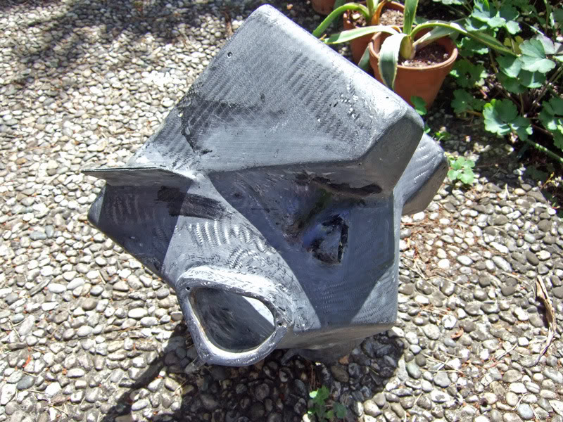

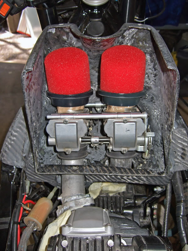

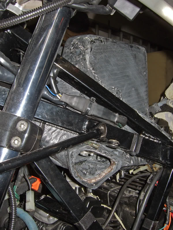

This all ongoing and the weather being increadible so far I continued with my airbox.

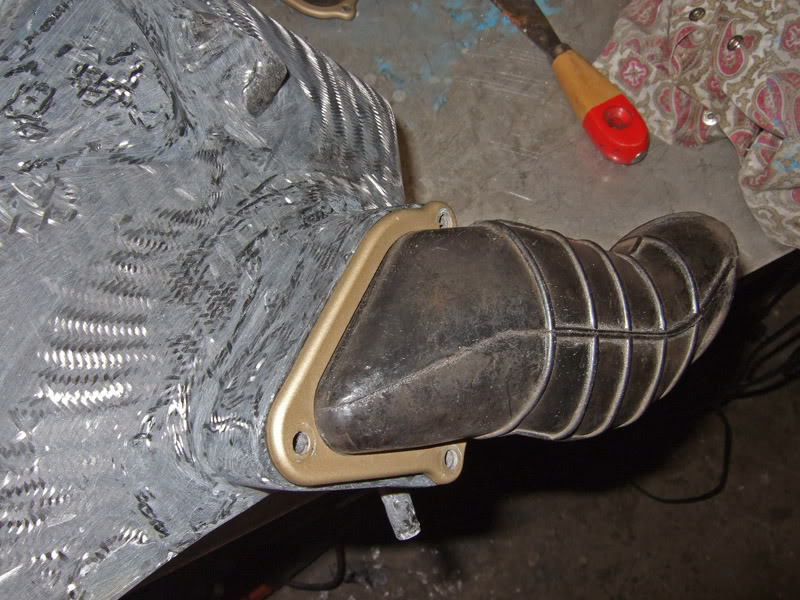

The position of the filter and the inlet ducts was still undecided as difficult. Snorkels on the bottom rear like the original ones would`ve been nice but wouldn`t work so I figured I`d do it like on the 907ie and put some snorkels in the front. That idea was scrapped after having done that as I didn`t like it and the space above the carb being the most important I didn´t want to have the inlet ducts just there.

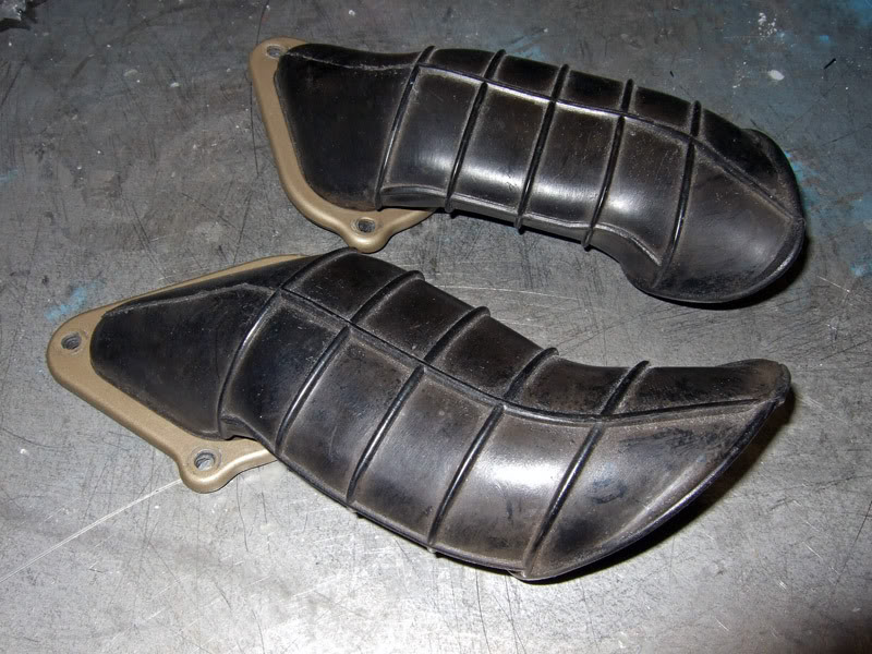

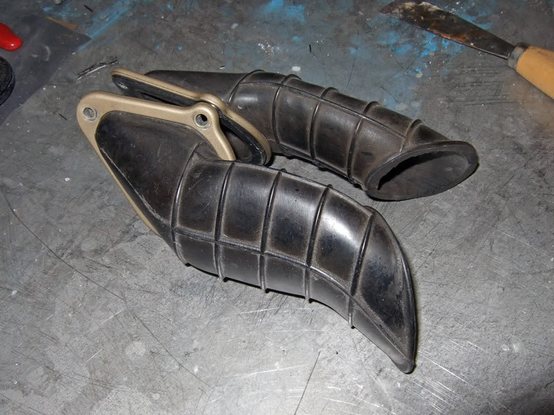

Going through ebay I was lucky finding some oval snorkels which were told to be from an ST model which I doubt very much. These were perfect.
The holes intended for the front snorkels had to be closed and new ducts made to mount the snorkels.
Horn and fuel pump need to be relocated but I`ll figure that out later.

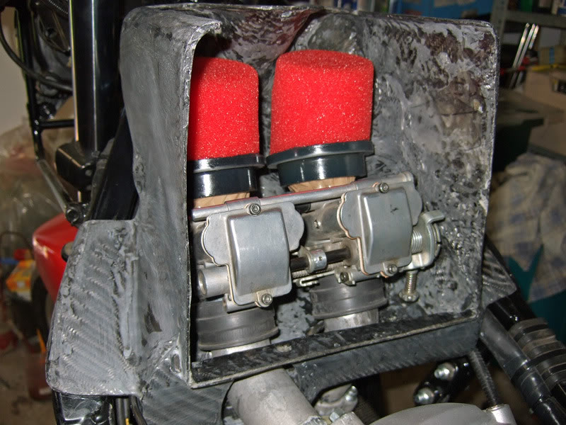

Finding filters that would fit was another mission that basically took months. The box is narrow so no K&N would fit. I don`t know how many catalogues I studied before I ended up with foam filter socks (from RAM AIR) actually for velocity stacks.
The actual measurements were totally off from what they should have been according to the data sheet so they went back to the UK.
At UNI FILTERS ins Autralia I finally found the perfect match and Claude was so nice to help me having them here only within a few days (thanks again !!!)
They didn`t fit right away so I had to cut out triangles of the sides of the airbox and bulge them.
The past days I did nothing than wet sanding which brings me to a halt today. The finger tips won`t play along so with the weather having turned fresh and wet today it`s a good time for healing and an update.

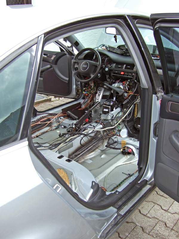

PS: (offtopic) another thing that kept me busy was my car. If your car stands outside a lot do check all drain holes once in a while. I missed that although I do check the drain holes of the sunroof. My car has a compartment where the battery and whiper linkage is mounted. This is devided from the engine compartment and has two draining holes. Leaves and other stuff will collect at the rear edges of the bonnet and rot sooner or later clogging the draining holes. One can see on the right how high the water stood up to the point where it was higher than some rubber grommet where it then spilled inside the car. The complete interior needed to be stripped as the carpet was soaked. Meanwhile it`s all cleaned, dried and reassembled. You may give your draining holes a check, too ...

And in regards to the car:
Thats a Volkswagen/Audi-Issue.
My uncle had that with a Passat, coming back from the holidays, the water level in the car was up to the door sill then & has been higher before.
And the car has the ECU in the so called "waterbox". It was killed, too.
The 6 year old car had to be wrecked...

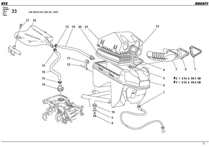

These are not from a ST2/3 or 4, are they ?
Johannes I`d love to see some pics of your airbox in your thread.
PS: Luckily on my Audi theres a box with the main relays infront which was "above the waterline". The two main ECU modules are in the black boxes below the front seats (one can be seen). They are halfway waterproof so I was lucky. My old Alfa had at least 4 drain holes in the cars floor (which always rusted). Newer cars don`t seem to have that anymore. The foam of the carpet almost took 2 weeks to completely dry through. Luckily we had a sunny period.

paso750 wrote:These are not from a ST2/3 or 4, are they ?
I thought they looked familiar. They are the air ducts (#2 & #3) on the ST2/4 that go from the air intake duct under the headlight and direct air to the rubber snorkles (#13) that are attached to the intake box...

Re: my Paso - a never ending (love) story ...
thanks Terry !
Do you also have the page that shows the intake duct under the headlight ?
I wonder why they made the air ducts oval as #13 is round and the air duct cannot be pulled over it.
no need to look it up anymore. I found the parts catalogue of the ST2 and also some topics in other forums like this one

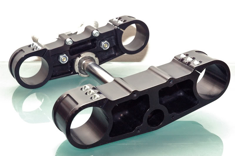

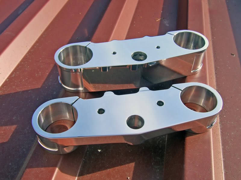

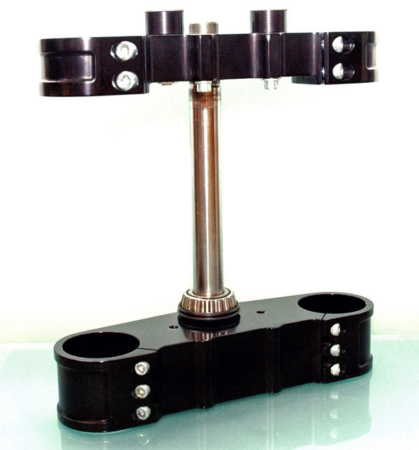

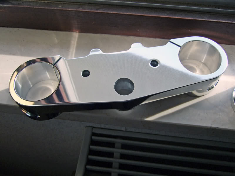

great work there G...those triple clamps for the elepant came up very nice, I might have put a coat or two of clear lacquer on them instead...

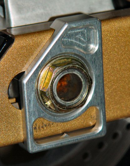

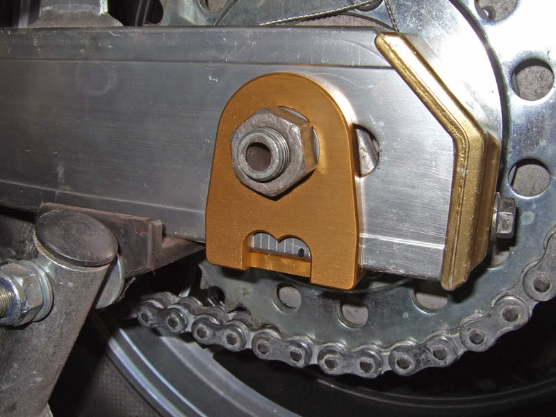

you have a 907 swingarm...nice alloy guide, where did that came from?
Sprockets lined up with a lazer beam...carbon fibre parts...lots of elbow grease, all this dedication surely makes you more of a pasonut than I'll ever be :thumbup:
BTW: sending those filter pods was no problem...I must mention, G sourced parts that I needed for my 851 project, ie: rear alloy subframe, rear fibreglass fairing, high rise exhaust pipes for the single seat conversion...thanks again! :beer:
Cheers Claude.
'92 907...numero 2046
'92 851...in progress
I agree those triple clamps were nicer polished but a. all the rest on the bike is black b. like most other aftermarket or custom parts (w/o TÜV documents) these need homologation which one will have to pay for. Being black like the rest no TÜV inspector will notice that those are not original and c. clearcoat on mirrorpolished parts won`t hold up long. It`ll chip off with time. For paint to stick well the surface should be slightly rougher.

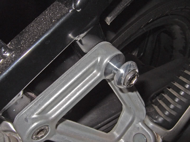

The rear axle plates I found here:
http://cgi.ebay.com/ebaymotors/ws/eBayI ... OTORS:1123
The stainless steel washers that come with the plates were too thin and had to be replaced with thicker ones as otherwise the nut would´ve scratched the axle plate. The nuts i.e. from a Monster are a little different for instance they are not as thick as the ones from the 907ie so that may be the reason.
I find these even nicer and they go around the swingarm also on top. (would for sure look good on your 851 :) )
