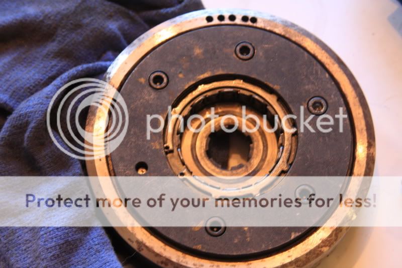

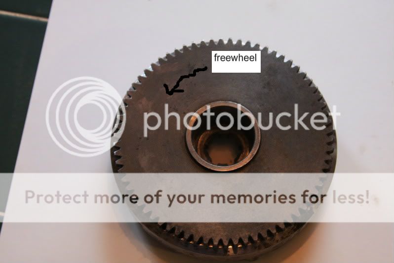

If you rotate the engine at the flywheel on the bike clockwise the starter will spin if you have the sprag installed
properly
counter clockwise the starter will not spin
Now this means when the starter spins counterclockwise( from the side of the bike looking at the flywheel) as you hit the starter button the sprag locks and drives the crankshaft counterclockwise
spins the sprag gear counterclockwise ( don't forgot there is a third set of gears between the starter and flywheel gear)
Once the engine starts the crank rotates fast enough to overrun the sprag. The sprag is still spinning in the same direction but since the crankshaft turns faster than the sprag.... the sprag freewheels as its relative motion to the crankshaft is now in effect clockwise
Make sense now or did it just confuse you again?
Now with the flywheel out and on the bench sprag and starter gear facing up if you spin the starter gear counterclockwise it will freewheel when the sprag is in properly This is opposite of how it works installed on the bike

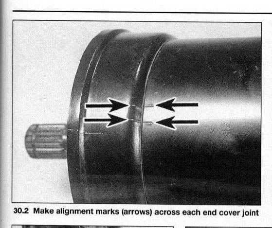

Harry, I`m about sure you assembled the brush plate correctly. Do check if the marks on the housing align. There are 2 parallel marks at both ends of the main starter housing which have to match the 2 marks on both endcaps.

Ok update time. I have totally removed the Starter and yes there are alignment marks on the end that bolts to the Engine two of, and then on the Starter Case itself 3 of and on the End Cap two of but the problem is if i line up the end that bolts to the Engine with the Starter Case lines then the two marks on the end Cap do not line up so that the two long phillips head screws will go back in to secure the End Cap. To get the two phllips head Screws in the cap has to be rotated about 30mm past the other alignment marks. Hopefully i will get some photographs of this for easier interpretaion.

. Sorry about the quality but you should see where i have hi-lighted the marks with silver paint pen. Oh and it looks as tho i did not resize properly. Apologies all.
