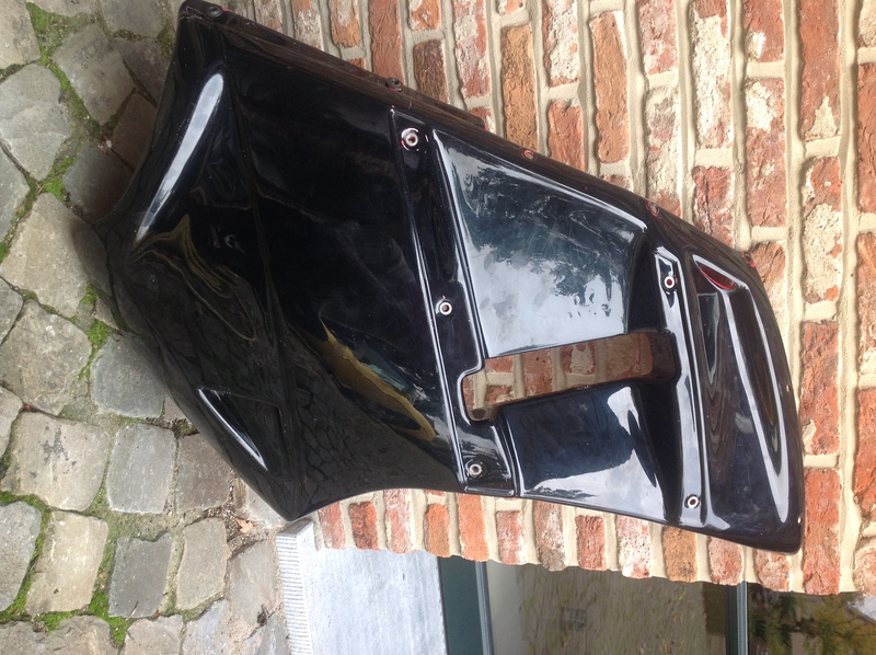

Almost forgot to say: removed the paint from the fairing (well, started).
Was surprized to see the Italians did a s****y paintjob.
No preparation, the fairing surface was not even abraded (made my life A LOT easier though).
Unfortunately the rest of the fairing: rear side panels, mudguard and top fairing are all much more difficult with regard to removing old paint (that's for later).

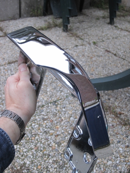

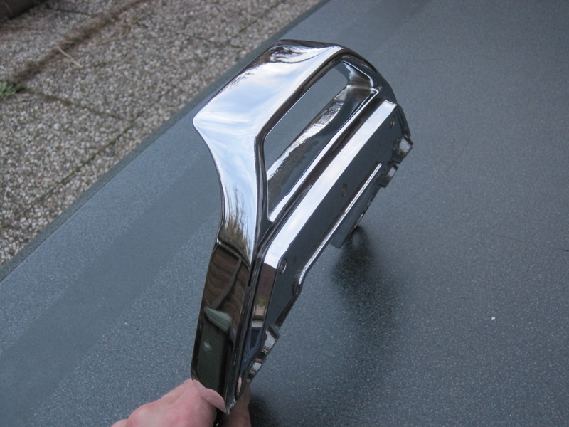

And a picture of my freshly chromed handrail (was a little expensive but I love the chrome of the first Paso's).

- Looks even better in the flesh though !
- image.jpeg (238.92 KiB) Viewed 16180 times
- Bling bling ...
- image.jpeg (399.15 KiB) Viewed 16180 times
- Glossy gelcoat what once was red ...
- image.jpeg (433.75 KiB) Viewed 16180 times
