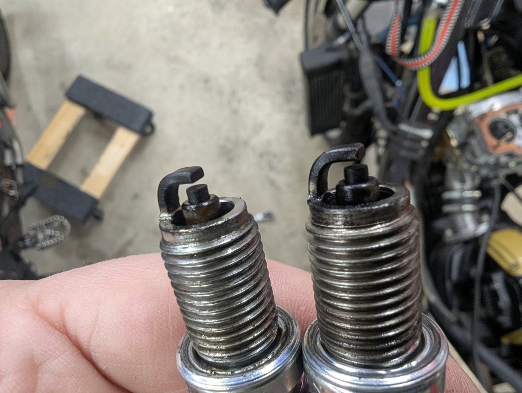

Verified spark at the plugs and voltage while cranking is about 10.4v.
Pulled the plugs and saw they were rather wet. Vertical left, horizontal right. Cranked the engine over, plugs pulled to show the stream of fuel coming into the engine when I twist the throttle. When I start it, the butterfly seems a bit closed but first opening with the throttle, the gas just has a steady solid stream down. For some reason that seems odd. I've always started the bike with the air box on so I never saw it before. Keep in mind also that fuel pressure is merely the gravity flow from a small bottle- hadn't been a problem yet.

They dont like running without the air box , even taking the cover off will upset it .Its not unusual to fuel coming out of the aux venturi ( the tube thing in the middle of the carb barrel ) when there are a few revs on board , like off the idle circuit and into mid - full throttle .
I would see if the battery voltage is 10.4v ( measure at battery ) whilst cranking as it seems a little lower than ideal but if thats what the battery does then I would try to jump start it off a running vehicle ( something showing 13 ish volts off the alt ) just to eliminate low voltage , like if it still plays up with 13v then your issue aint low voltage .

Sounds like you have a cylinder not firing. You can hear it start to fire as you rev it up. To me I would say you have an issue with your ignition somewhere. Most likely low voltage at the plug. Could be coil or spark plug wires or maybe the plug. It may also be low voltage to the coils. Have you done any of the wiring mods to be found here.

That's what I'm thinking as well could be the problem. Especially with the wetter spark plugs that I've pulled out.higgy wrote: ↑Sun Mar 23, 2025 2:35 pm Sounds like you have a cylinder not firing. You can hear it start to fire as you rev it up. To me I would say you have an issue with your ignition somewhere. Most likely low voltage at the plug. Could be coil or spark plug wires or maybe the plug. It may also be low voltage to the coils. Have you done any of the wiring mods to be found here.
Funny part was that battery voltage was 12.3 prior to cranking and the 10.4v at the coils while cranking. Resistance showed to be in spec measuring across the tabs on the coils, roughly 3.78 ohms. Or maybe that's on the low side of the tolerance.
