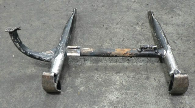

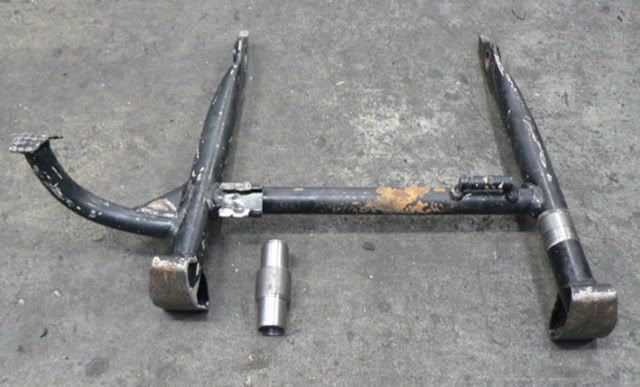

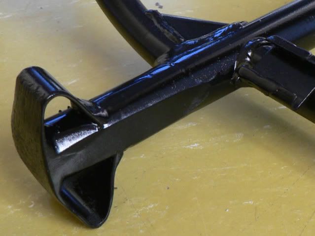

So I lengthened the centre stand legs, repaired the grooved holder for the chain pad and made a new longer pad. I lengthened the legs 22mm by making some inserts out of 25mm mild steel round bar. I turned a 20mm long spiggot at each end. The diameter for the spiggots is 20.25mm but you will need to grind off the seam from the inside of the leg once cut.
You can see that I did one leg at a time so I had the foot to work off to keep it square. I bored the inside of the insert to 17mm. I tapped the foot back on with the insert in place and used the mig to weld it before cutting the other side. Below is the stand lengthened with welds ground off.
I check fitted it and found the leg still hit the chain so ground 2mm off the inside for some clearance. I bronzed up the damaged groove for the chain pad and gave it a coat of paint.
As suspected, the chain does not contact the pad with me sitting on it and clears it by about 15 - 20mm. I intended to lengthen the side stand next but the hex on the retaining bolt is rounded off so it will have to wait until after it is legal.

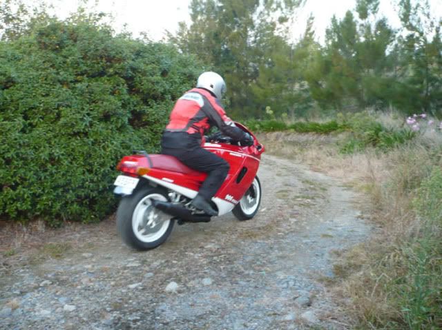

It was dry when I got home tonight, so I took the 906 on my usual test circuit to a local watering hole and back :beer:
When I reached the end of my drive I once again encountered that reluctance to turn at slow speed. Coupled with a torquey motor eager to go I am coming to realise I will need to have my wits about me when manoeuvring at slow speed. However, once under way she performed flawlessly. I consciously 'reverse-steered' it into the bends and she immediately responded by laying over and taking the turns with ease. The tyres felt grippy both front and rear and the further I rode the more confident I felt. I tried a couple of 'panic stops' and there was no hint of rear lock-up. Even some hard downshifts failed to disturb the grip of that 180. I did 36kms over my usual 'once round the block' trip and cruised at up to 120kms/hr on the straight bits.
Both the Sprint and the GPZ would leave it for dead but the 906 wins hands down when it comes to 'grin factor' :thumbup:

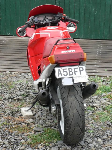

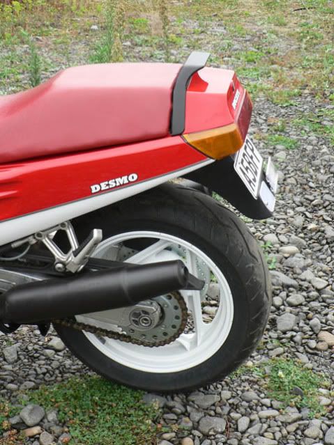

OK, this morning I dropped my reconditioned 906 ($2,300 later!) off at the vehicle testing station to be vinned, with the Dunlop D250 on the back, and the 130/60/16 Metzler M3 Sportec on the front.
It rides like a new bike. With all new brake discs, pads and tyres, along with every fluid, seal, and bearing either replaced or lubed.
I only did 10km to the testing station, and did not thrash it. The rear tyre is *just* touching the chain - not taking chunks or anything, more like leaving very tiny wavy lines on the final 0.25mm of the rubber.
I'm vinning it now, so that further mods to the chain won't produce any legal issues getting the bike on the road. I'm confident they won't see that the chain is just touching.
Tonight I'll take it out to my engineer's in Rangiora about 25 klicks away.
CB, I printed out the entire thread and I went over it with Duane at the shop, and he reckons your mod won't work on my bike - at all, under any circumstances. That's because there's no way to move the chain 10mm outboard because it will contact the frame of the bike after about 5mm! Also, the chain guide would need to be shifted, and (as you've done) mods to the center stand would also be required. He reckons that at 10mm it'll eat a whole in your frame, and you won't notice "because it'll sound like normal chain noise."
Because of this, I am *not* just going to blindly follow the process you've used, but let my engineer check it out for himself and come up with a solution.
My chat with him last night indicates a couple of things worth discussing here. He's an engineer with over 45 years experience, and he restores motorcycles full time in his retirement. He said that it is NOT essential to have the sprockets perfectly in line, and he will refer to his tables which allow him to calculate what acceptable offsets are for this combo.
It may well be (he said) that it is possible to move the rear sprocket 2mm outboard with little or no dire consequences at all, with a simple 2mm spacer under the sprocket. That little offset would still allow the sprocket to be properly located. That's before looking at the bike of course!
He said that it is sprockets that wear (not the chain, mainly) with sprockets off set and that the difference might be a 5-10% reduction in life time at most. Given I'm going to ride less than 5,000 klicks per year, this is a sacrifice I would gladly make if it means just being able to bang another standard sprocket straight onto the when it wears down.
