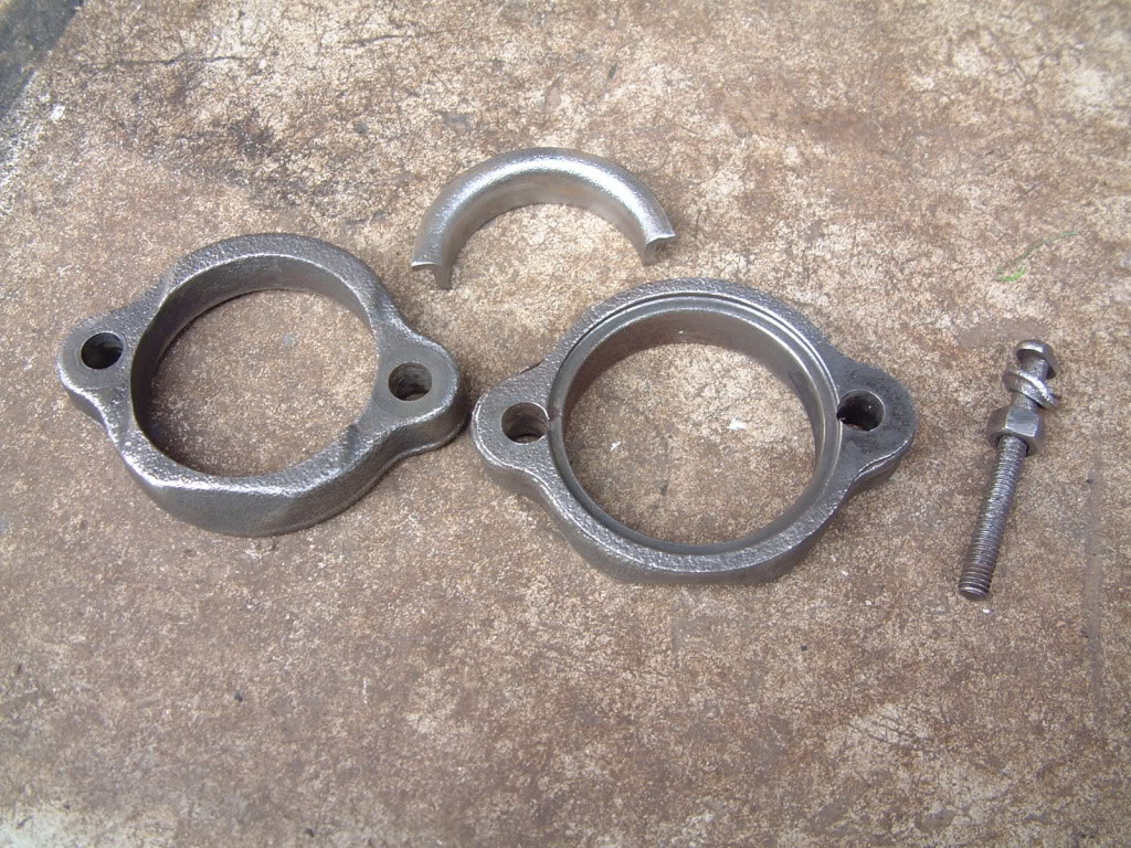

The inlet rubbers look just like the ones from the carbed SS models. I don't know if they are the same but it's worth a look.
Andrew2
- Posts: 574
Thanks Derek,I'll check it out.Derek wrote:The inlet rubbers look just like the ones from the carbed SS models. I don't know if they are the same but it's worth a look.

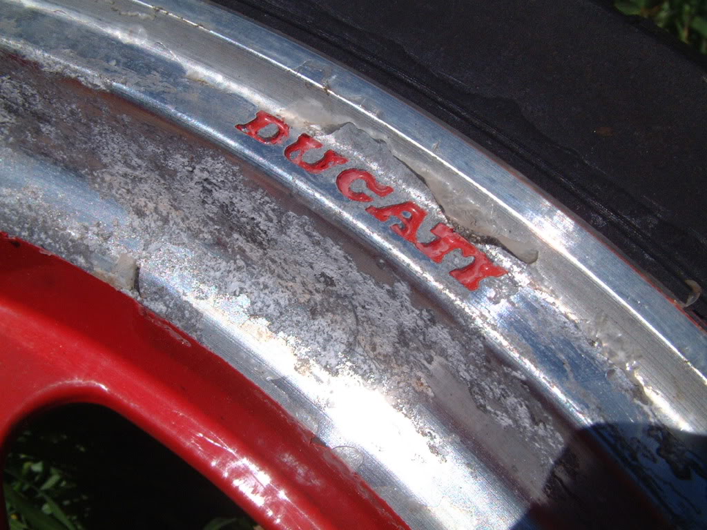

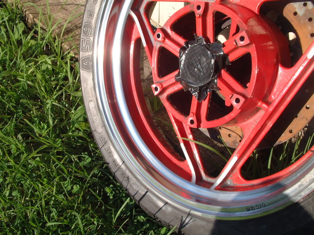

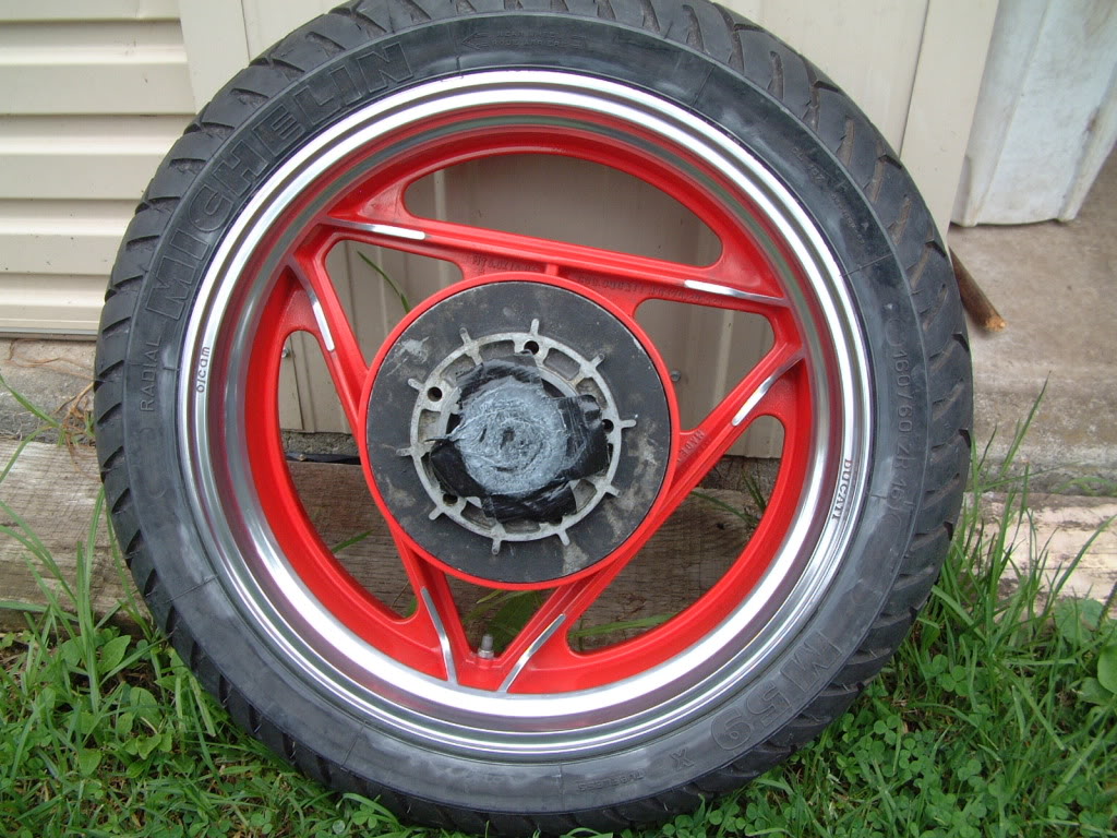

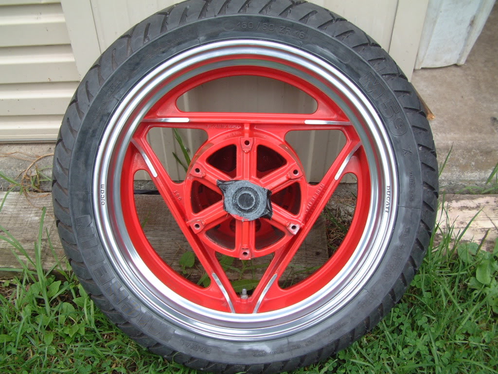

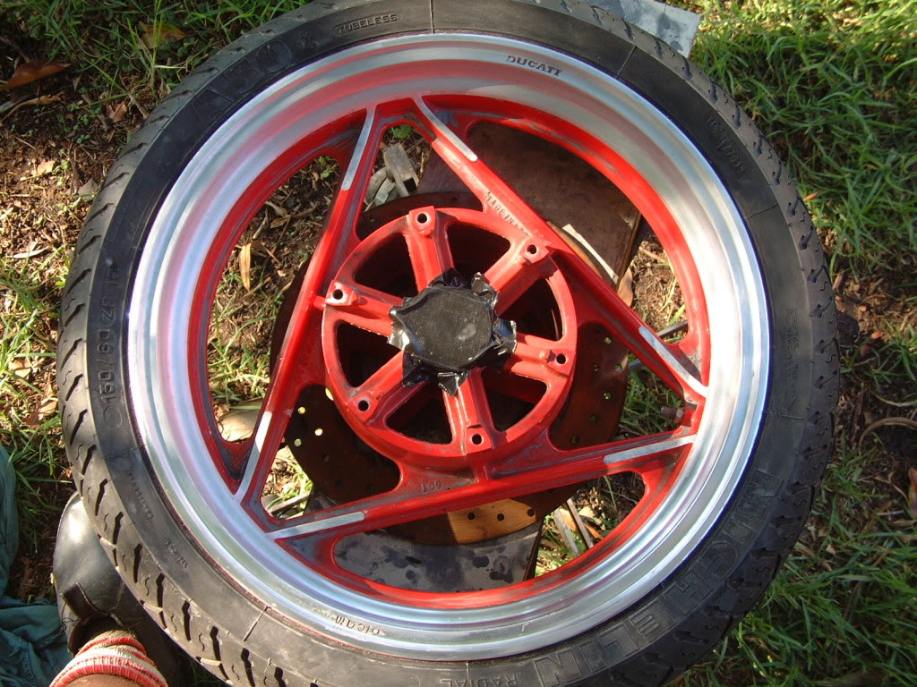

I got the rear wheel cleaned up after not doing anything to it since the last post.Anyway it looked like this.
And now looks like this.
It's not perfect and I was'nt going for a mirror shine so I'm happy with it.Better than it was anyway.

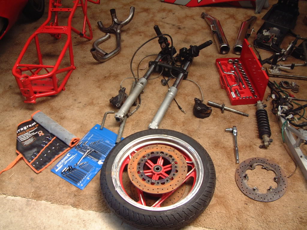

- Posts: 5570
just wow, I didn`t believe it was possible to get the rims so nicely looking again
My old ones look almost like yours did. I was thinking what to do with them as I have a set of brand new ones on the bike now. Can you give us some more details what you exactly did ?
I was always thinking that when polishing the rims the critical part would be the edge to the paint and the small silver section on the 3 spokes but that looks really good on your rims.
Guess you will have to wax the rims or do something similar as the aluminium is blank and will corrode even faster but maybe that`s less of a problem in Australia`s climate than it is here.
Don`t forget to polish the outer edge when the tires are taken off.
Cleaning the header should not be that hard. I did the mistake to sandblast mine which left a rough surface which needed a lot of sanding to become even again. It should be easier for you.
Headers get a lot hotter than exhausts so many "heat resistant" spray paints will start to peel off over time. Better invest some elbow grease.

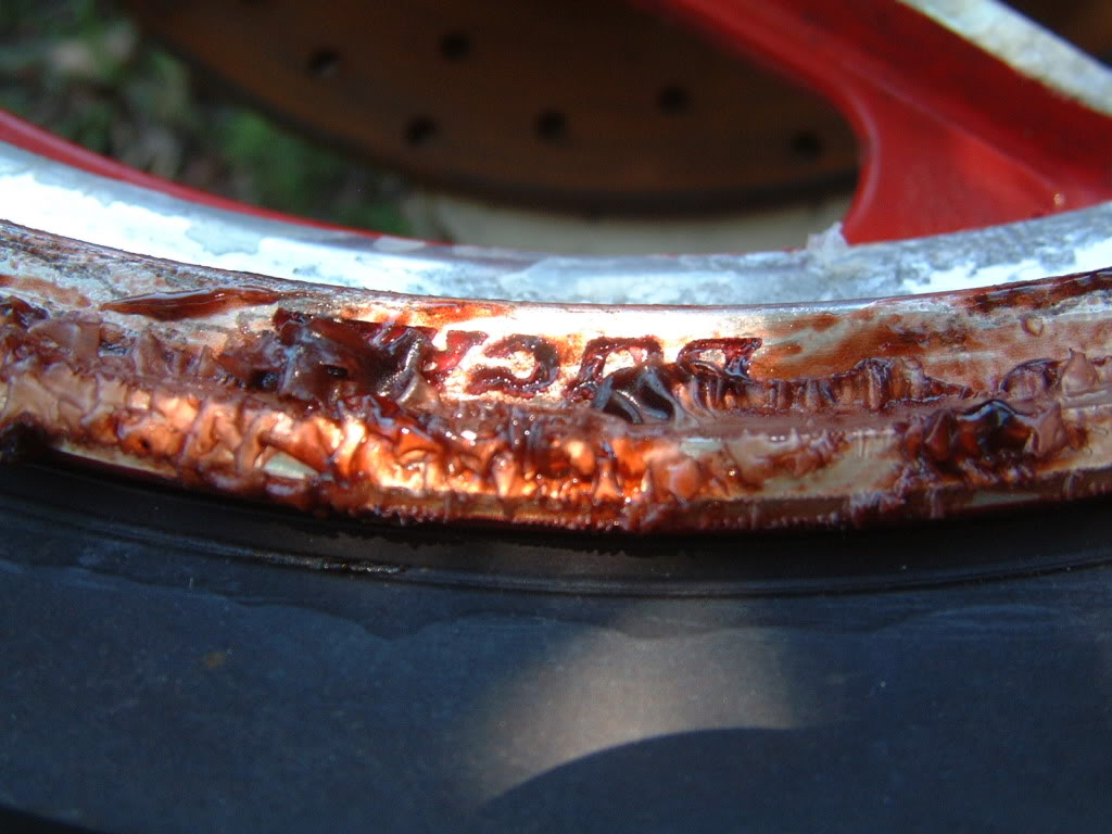

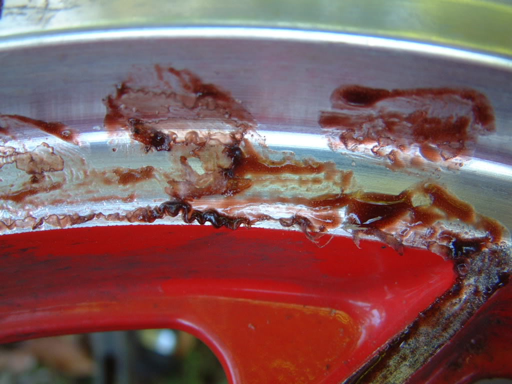

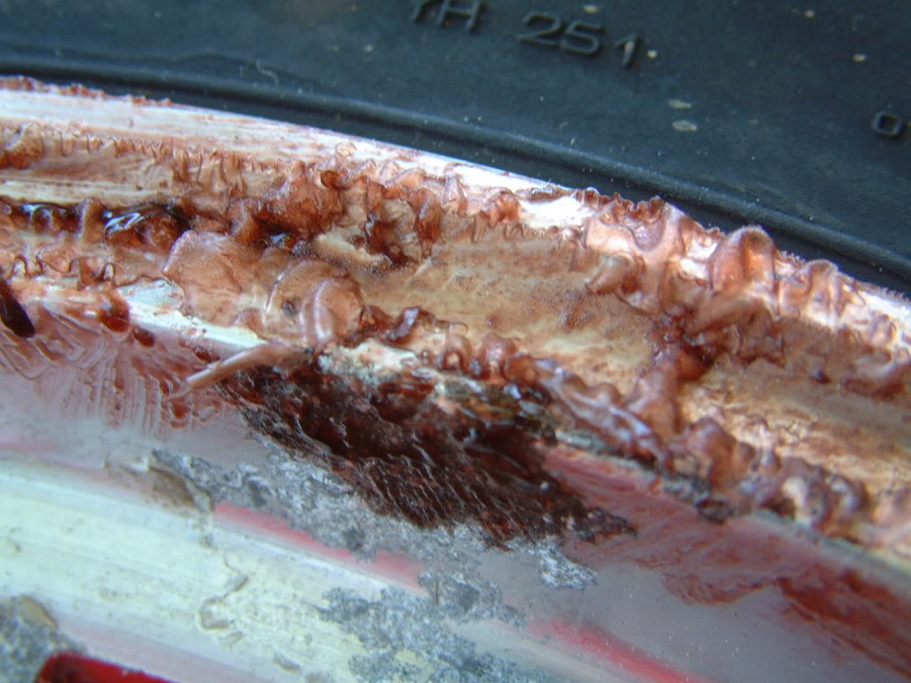

Thanks G.As you well know nothing is easy but here goes.First I had to remove the front wheel and the disc from the side I was working on.
This is what it looked like.

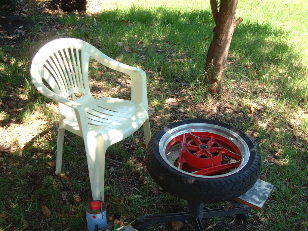

Then find a shady spot to work in as it's the middle of sumer over here.
Now on with the paint stripper to get the plastic coating off.
You usually won't get it all the first time.When it comes to putting it on close to the paint I use a small brush and patience.
Next up is the hard work starting with this.

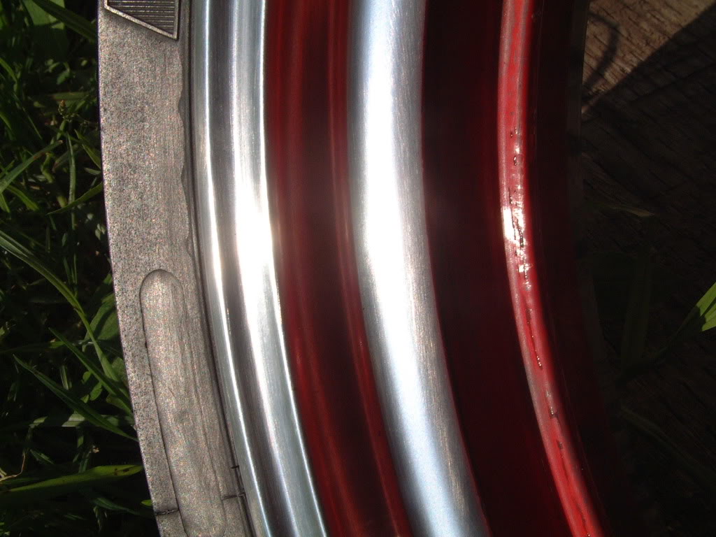

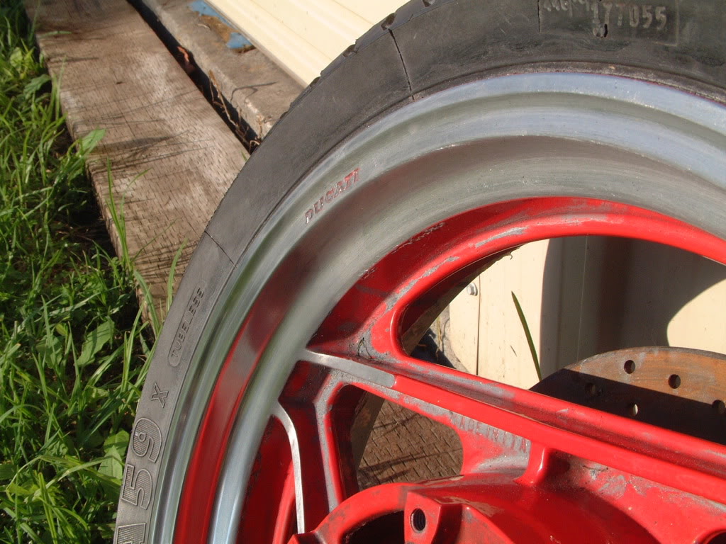

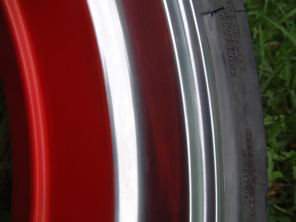

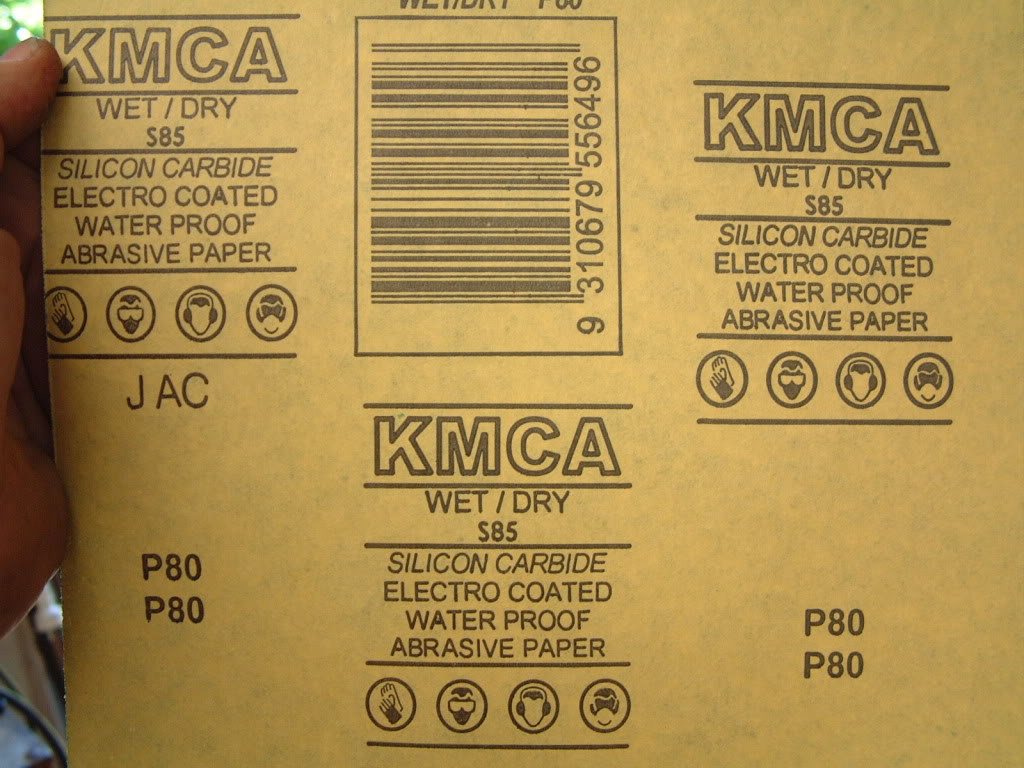

Where was I...oh yeah.This is what it looks like after the 80g wet/dry.
The 80 wet/dry part is the hardest and longest.Next up some 120.After the 120.

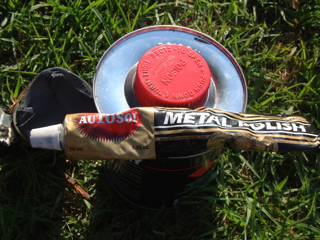

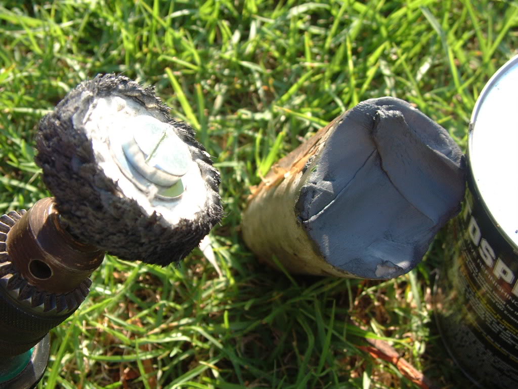

After that I used some 600,1000 and 120.Then I use this for a couple of minutes.
And finally tidy up with this.

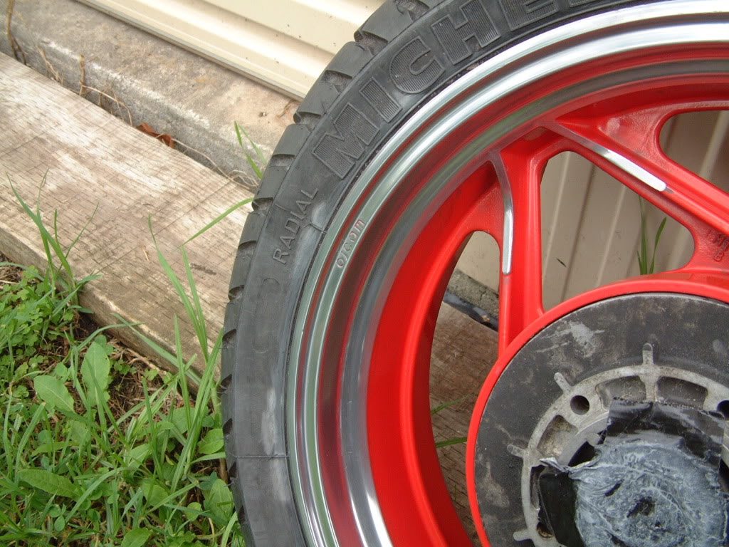

Here I've done one section to final completion.Came out ok.
You can see where I"ve stopped at the 80g and finshed the one section completely.As I said the 80 grit takes about 70% of the job.I'll probably finish the rest of the wheel through the week.

- Posts: 5570
thanks, Andrew. Are the spots were the silver shows through under the red paint because of the paint remover ? If so it`s probably better to have the wheel standing and doing only the lower section, then rinse, then do the next etc. This`ll take a lot longer but it may be safer for the painted parts of the rims.
I`ll definetely give it a try in a couple of months. Currently we`re at -15°C
Andrew2
- Posts: 574
paso750 wrote:thanks, Andrew. Are the spots were the silver shows through under the red paint because of the paint remover ? If so it`s probably better to have the wheel standing and doing only the lower section, then rinse, then do the next etc. This`ll take a lot longer but it may be safer for the painted parts of the rims.
I`ll definetely give it a try in a couple of months. Currently we`re at -15°C![]()

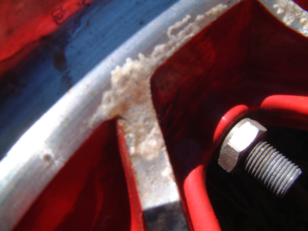

That's actually aluminium dust mixed with water from using the 80grit G.I had'nt washed the rim at this stage because I still had to finish the rest of it.The front wheel in the earlier pics looked the same before I gave it a wash.I just did a part of the rim to photograph the different stages.I'll post up photos when I have finished the whole rim and given it a wash.
If you look at the closeup you'll see where the oxidisation has got under the plastic coating on the painted part.There was nothing I could do about that but clean it up.I will eventually repaint the rims but it's a money thing (lack of) at the moment.
