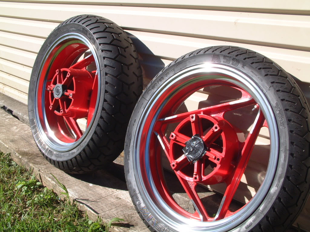

Well I finally got some more work done on the old girl this weekend.The wheels were done and I must say I'm happy with how they came up.
I just need to bolt the discs back on and the they're finished.What a job though :shock:.As I said before I'm on a very tight budget and everything I can do myself I will be.I have some forks lined up and am saving like hell to get them.

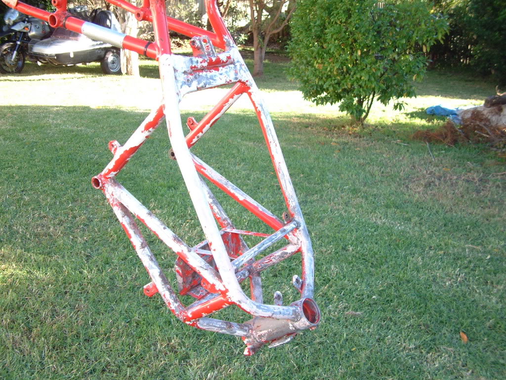

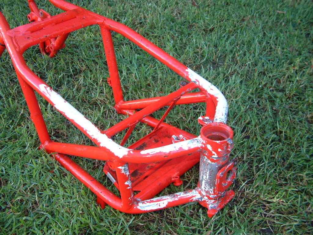

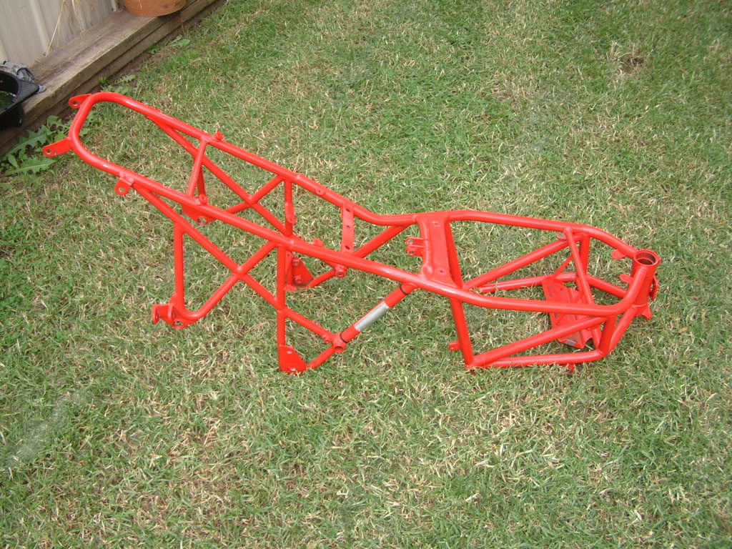

Next up will be to strip the frame.This will also take some time to get perfect for the painter but it's only my time.Looks good from a distance.

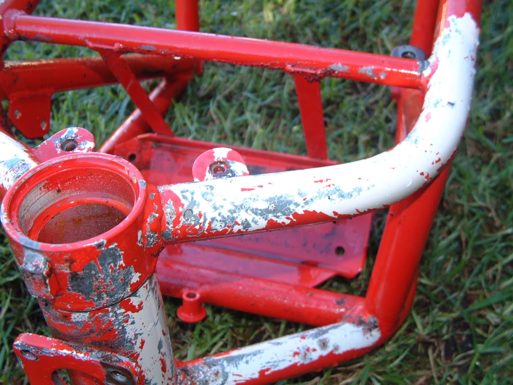

I've given some thought to putting the extra brace at the steering head but have decided against it.It has'nt cracked in 40,000kms so I'll leave it alone......unless someone has another reason for it to be put in.
Let's get started.
Finally....chrome moly :choo:
I'll add some more photos when it's stripped bare.While it's getting painted I'll mask and paint the engine.For some reason I have'nt been keen to get into painting the engine.Not sure why but can only guess that I don't feel it's cleaned up enough to get a good finish.It'll have to do though as I've got it as clean as I can short of bead blasting it.

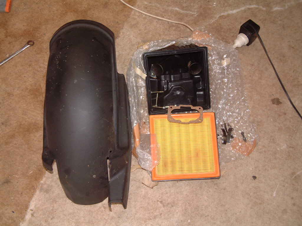

I also picked these up from the previous owner today.I doubt I'll use them but will keep them just to have the original parts.

Andrew, you`re not totally done with the wheels yet. You need to pull off the tires, then you can finish the rim edge. You won`t want to use those tires anyway no matter how much thread there`s left. The front tire seems to have a 3 digit DOT with a triangle so it`s from the 90s!
I`d use that airbox if you have the original cover, too. Filters like your old one just make more noise and make a proper carb setup often more complicated.

The diagonal brace to the headset wasn't so much to prevent frame breakage as it was to stiffen up the headset a bit more. The 851 has a similar tube that area. Easy to add now that your frame is clean.
But, as you pointed out earlier, you are going back to stock. So, to be correct, don't add it.
Everyday its looking better. Did you drop those iron rotors into the molasses? What is the proper way to deal with rusted cast iron rotors?

ducinthebay wrote:Everyday its looking better. Did you drop those iron rotors into the molasses? What is the proper way to deal with rusted cast iron rotors?
I haven't touched the rotors yet but will try the molasses.The only problem is if you don't do anything to them imediately they rust again so might leave that till last.Although I have found that just using them gets rid of the rust quick enough.

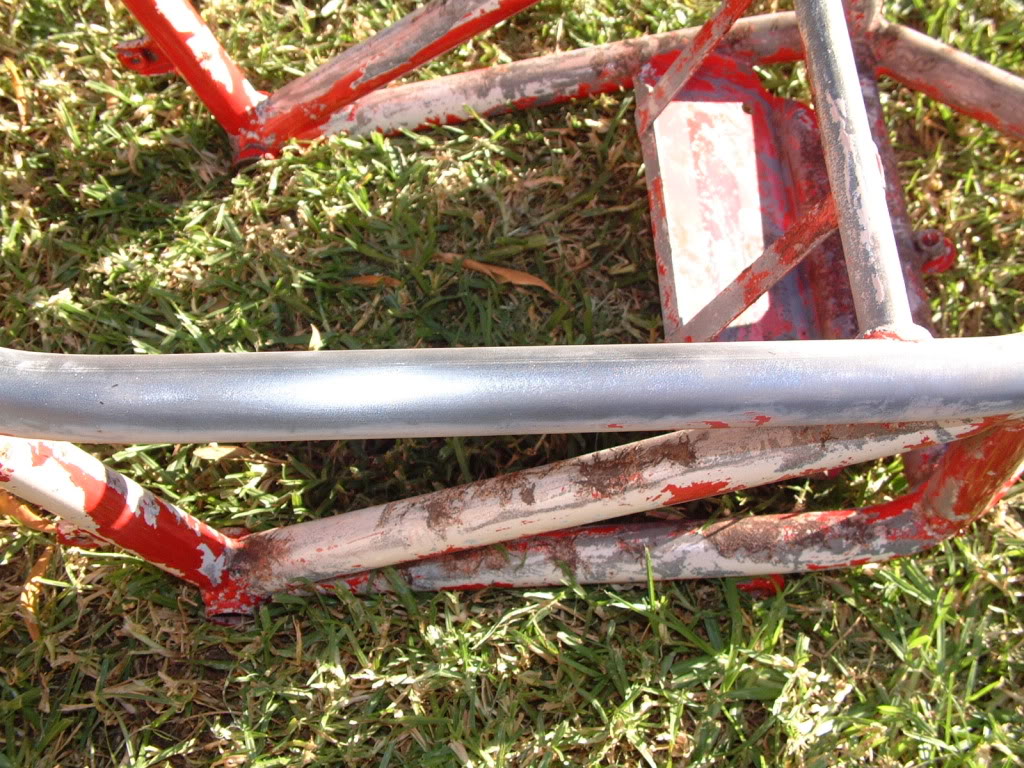

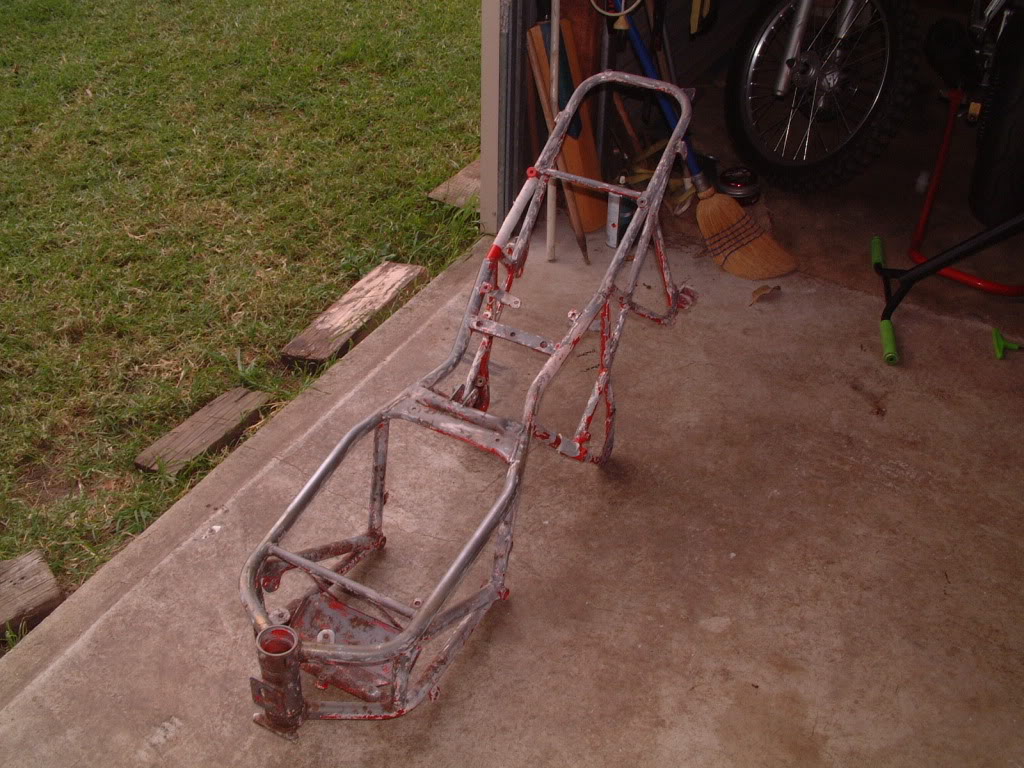

Not much to report.I stripped a bit more paint off the frame.It's a time consuming job and I might get it blasted yet.

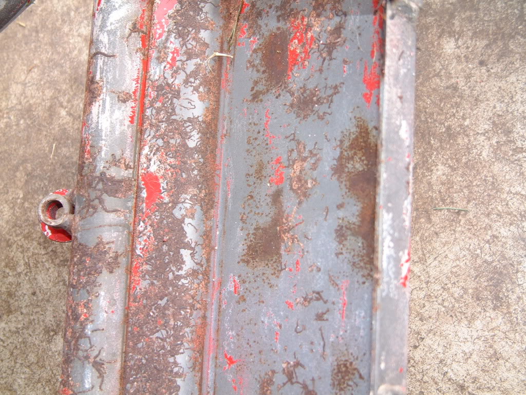

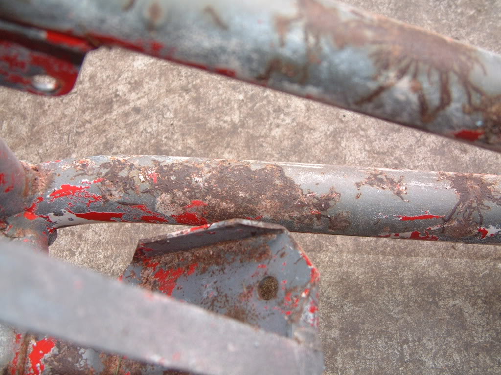

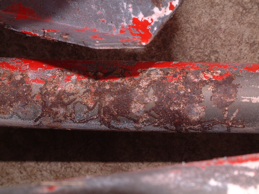

This is what battery acid will do to your frame if left.
Andrew

I was very naughty with the rotors off mine, hit them with the wire wheel on the bench grinder, then block sanded with 1200 wet & dry :beer:
Actually gave the pads a light block sand as well just to take the glazing off, that trick is older than dirt.

That battery acid damage could have come from a bad regulator/rectifier boiling the battery. Better check it before reusing it in case the last owner didn`t already change it.
If you`re using a non sealed battery a catch tank like this`ll help if that happens again:
http://www.amazon.com/Motion-Pro-Batter ... 864&sr=8-4
Posts: 3381
+1 on the catch tank for lead acid

another thing , I have recently painted 3 frames and 5 motors ( actually only 2 frames and 2 motors , I just did them more than once ..... and thats my point )
NOTHING shows up poor preperation like the last coat of paint, be it on a motor or a frame . I have had all sorts of drama trying to save a few bucks . After paint strippering , water blasting and wire brushing a guzzi frame and the paso one TWICE each ( the 1st time looked like shit ) I found the local powder coating guy would acid dip , sand blast , primer and powder coat a frame for $100 (NZ )
As for the motor , I paint strippered , I wire brushed and I even f*&%in prepasoled , but the firetruckin paint wont stick. One lot did stick but crc , petrol and oil took it off ... f^%$in great!
So IMHO If you want your frame to look good give it to a pro. Powder baking involves a bit of finishing off , cleaning out threads and removing masking . If you have never done it before go see the guy who's gunna do it and he will tell you what YOU need to do to geta good job . Engine ; if you want it to look good for longer than the 1st ride , strip it down and get it soda or vapour blasted clean, and I have been told by several people now that the harley branded ( dunno who really makes it ) engine paint is hard to beat. Out board motor dealers often have quality factory primers and top coats in aerosol cans too ( mercury black ) It is heart breaking to spend hours and dollars and get a average job . Do it once properly ,it will save you money in the long run :) :) :)

Yeah, stripping a frame is a lot of work. I have done some bicycle frames by hand and it takes a lot of time to prep it right. As with all paint jobs, its all in the prep work. Get yourself a roll of 120-150 sand paper, (1.5 inches or 35-40mm wide) put on some good music, go around the frame to the rhythm of the music. Its a tedious job.
Beadblasting is one option, as is hot dip stripping if you have a service that will do it for you. There is always some hand work after any of those services.
Painting a frame is much more difficult than something like a tank. All those different angles to get covered and getting a good gloss on the paint is very difficult because everything oversprays. That's one reason that powder coat is done often. No concern of overspray, and a nice even finish.

I'll check the regulator.I think I have a good spare ( of course....being a Ducati owner I would have a spare regulator :lol: :lol: ).The catch tank idea looks like a good one too.
Speaking of regulators I remember doing a ride to the Snowy Mountains on the Paso.When I stopped I could smell a sort of rotten egg smell but thought it must have been something in the pub.Anyhow,when we got to our destinaton I saw a Huntsman spider ( they're big :shock: ) run under my seat.So off with the seat to find it and lo and behold there was my battery ballooned to half it's size again.So that's where the smell was coming from.The regulator was over charging and the battery was about to explode.Thankyou Mr Hunstman :lol: .
