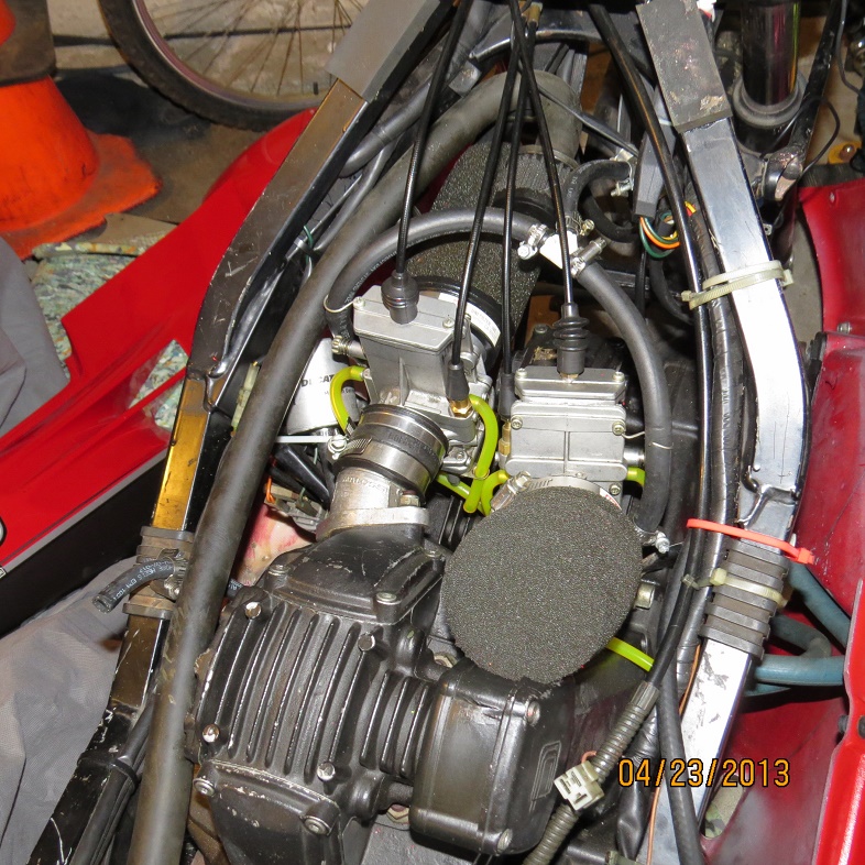

Re: new Paso owner
Posted: Fri Jun 06, 2014 7:32 pm
by Jeffreyt
If you're thinking Mikuni carbs, here is what mine look like:
