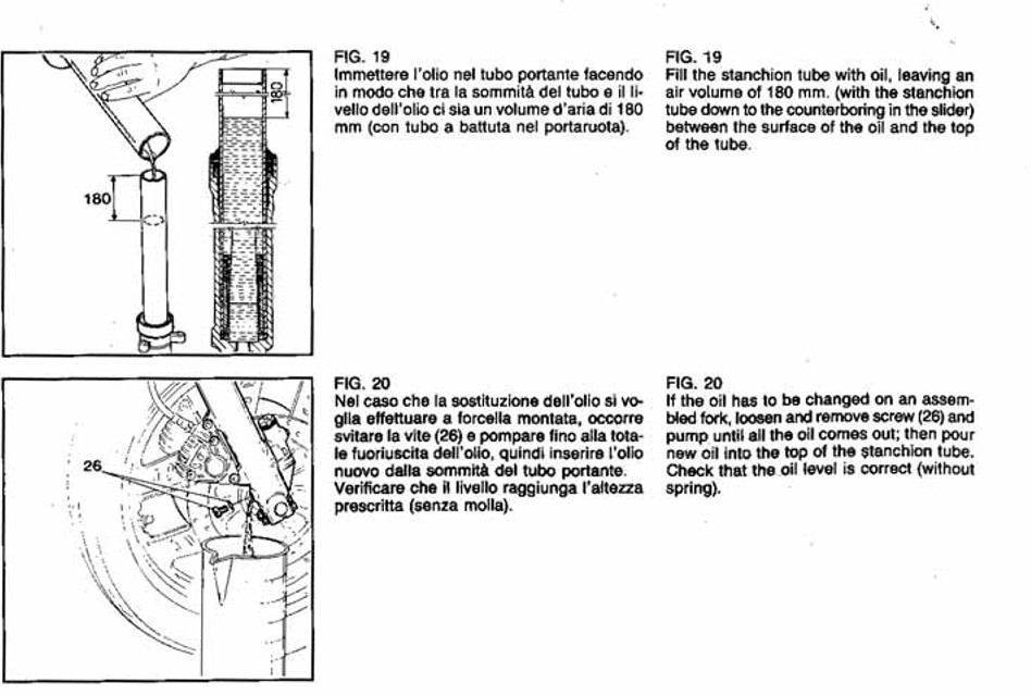

Re: Oil level in 907 M1R forks ?
Hi Antti
original Marzocchi workshop book says 180 mm.
I put in WP progressive springs without spacers and oil level 160 mm.
this avoids bottoming, because the airpressure builds up more rapidly.
I would suggest to start with 180 mm. This is also related to your bodyweight.
So, goodluck with your selection

My 2 cents:
Fill the forks with oil leaving an air volume at the top of 180 mm (see drawing from M1R shop manual page). I do this either before or after I put the forks back on the bike. The way I get the 180 mm air space is I took a thin tube of copper from the hardware store (because it is stiff and will not bend) and attached a drill bit stop collar on the tube to set the required length. I over fill the fork slightly with oil. I then take my copper tube and insert it in the hole at the top where the air valve screws in. Now I have allowed for thickness of the fork cap and all so that from the fork cap to the end of my tube I will get the 180 mm distance. So with the fork slightly over filled, and then using a syringe and a short piece of rubber or plastic tubing to connect the syringe to the copper tubing, I remove the fork oil until the syringe will not suck up any more oil and this will leave me the required air space. Easy.
I have read, and been told, and researched about the air valves. They are for releasing air pressure that builds up and not for pumping up or adding any air pressure.

- Right from the manual
- Fork oil level.jpg (115.45 KiB) Viewed 84805 times
