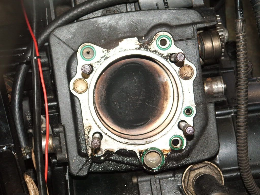

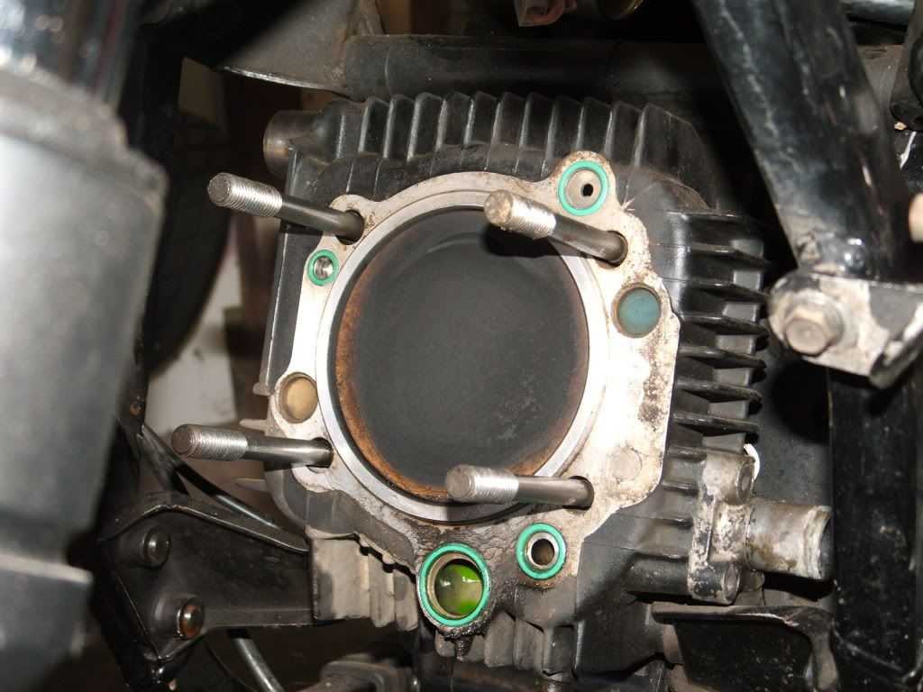

This is what the (green) o-rings look like
Horizontal cylinder
vertical cylinder
as you can see, these were leaking as well.
Horizontal cylinder
vertical cylinder

Can you send a picture??ErikB wrote:Hi, both cylinderheads have a oil leak near the exhaustpipe. I have bin told to replace the o-rings.
Doe anybody have any pictures off the head\cylinder so i have a impression what i have to do?
Mayby some tips?
Maybe the valve covers are leaking??

Hi Guys,
I am 100 % sure the leak(s) are similar like the pictures off Duckboy. I tried to retighten the cylinders but that did not helped. The pictures are very helpfull, THNX!!
Soon i will take off both heads & replace the o-rings. First I am going to enjoy my leaking Bike during this lovely weather!
