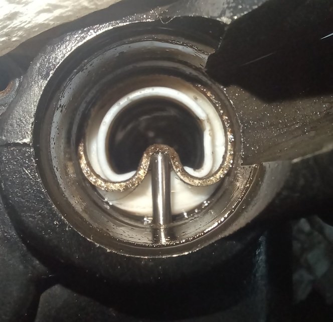

Alternative method to 11 above to assist collapsing the retaining ring use a backwards 2.5mm OD drill bit and pushed it in using a vise. The drill goes through the outer reserviour cap retaining screw hole.
Step 18 use a small length of welding wire to hold the piston assembly in position by going through the big inner hole (furthest from outlet, not the fluid inlet port) and onto the recess on the piston. Once the retaining ring and seal assembly is tapped into position reattach the lever and pull out the wire.
