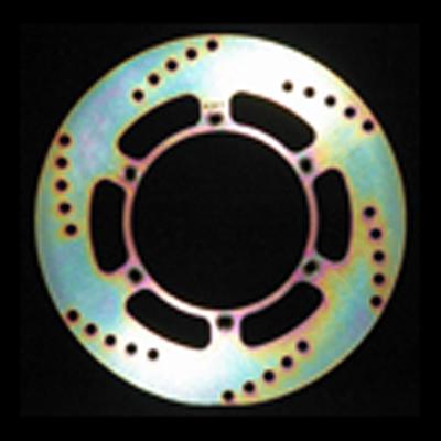

does any know where you can get replacment front discs that bolt on to the oscam 16" wheel.

WOW - those look really cool. I just bought some 4 piston Brembo calipers and with these discs would look fantastic. I think I'm due a really cool Christmas present for once!!

The standard cast iron front discs (750 & 906) are prone to cracking so they must be checked over periodically. What are these new discs made from, is it Cast Iron again? With the lack of vent holes I am guessing it is.

My guess is that they are made of stainless, but i'll see when they arrive. who still makes cast iron discs today? I've since found that EBC also make replacement discs for the paso/sport.

they are stainless steel.
the EBC number is MD630LS & MD630RS (left and right). The rear is MD631
I didn`t know EBC still makes them.

EBC have a high Stainless content - they stop ok though but they seem to have designed a disc that is rubbish with anything but their own pads !

just copying "MD630LS" into Google shows i.e. $228ea. in a US shop or 230GBP (the pair) in a UK shop (which is a lot less). Guess it`s worth do do some searching and comparing prices.

Why not look at this option, fairly cheap, look like original setup from Germany. 139,80 Euro /disc, front and 109,77 Euro / disc rear.
