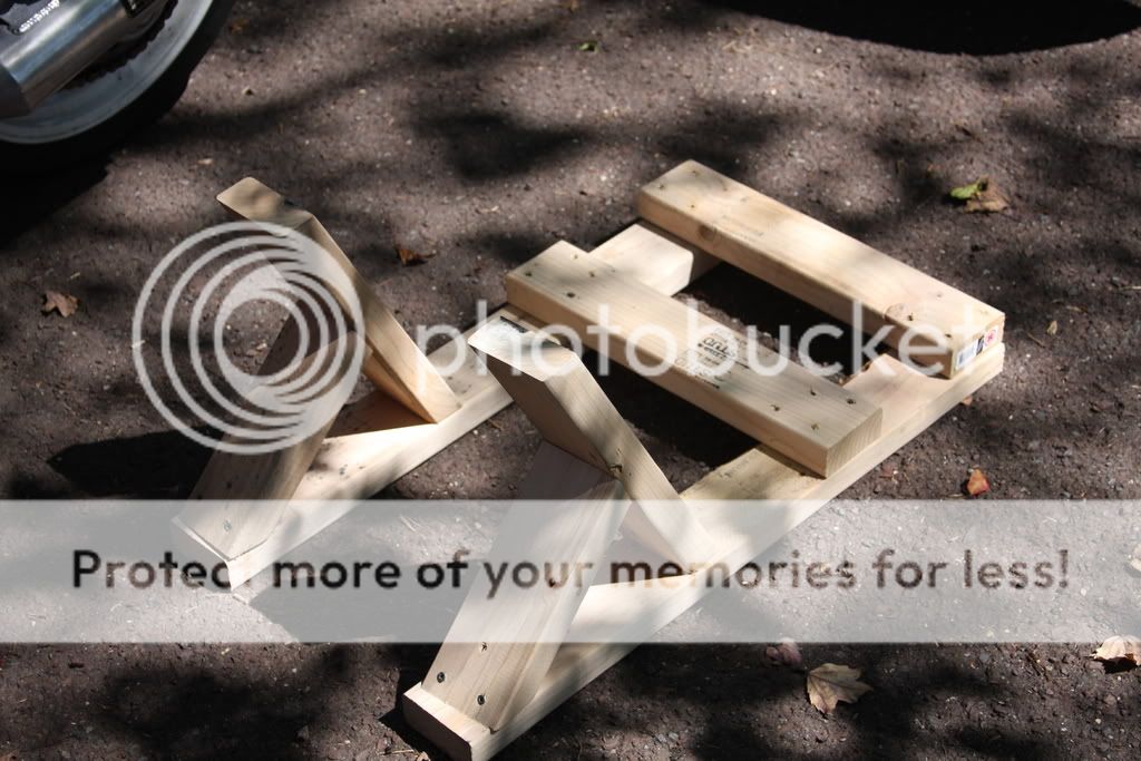

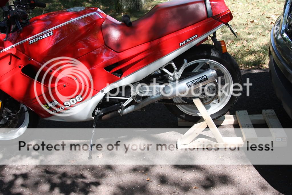

You should be able to put something together out of 2x4 fairly cheaply.
I have as yet not put a centerstand on my 906,have one just to lazy to do it.
So I cobbled this together one day a while back. I'm sure it could easily be made to lift
the front wheel off the ground as well,just to give you an idea

Looks a little like Redneck Engineeringhiggy wrote:You should be able to put something together out of 2x4 fairly cheaply.

pipe jobby is good, wtf u Thinkin on the second one ? Hows that one going to help
