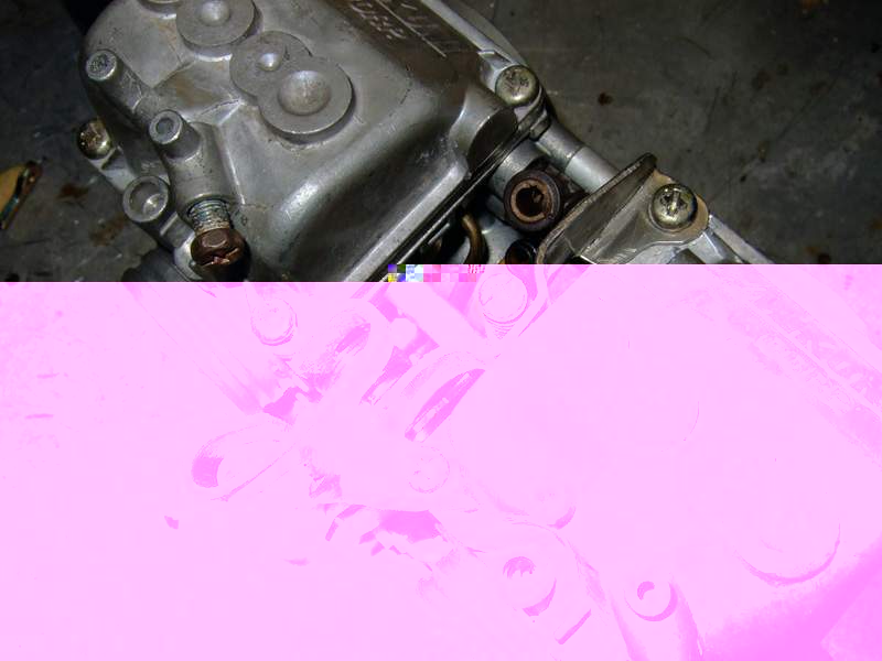

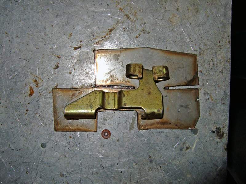

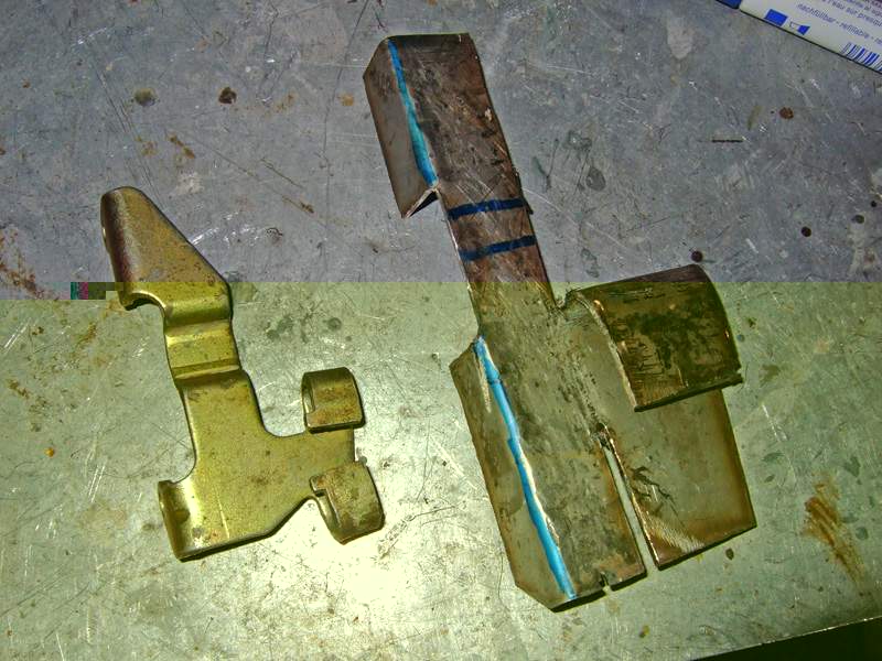

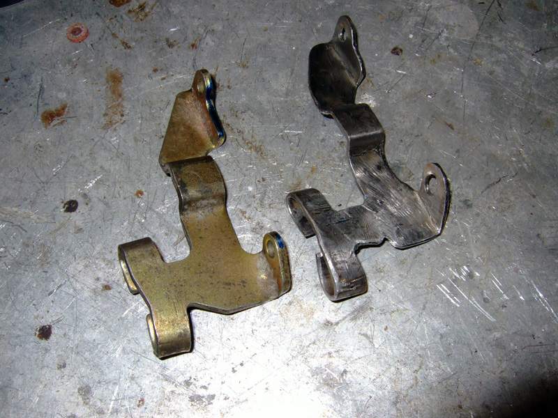

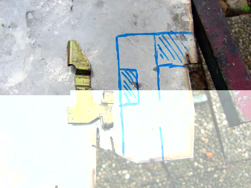

Funny I had the same problem a few weeks ago but I was lucky to have one Mikuni with that bracket to copy. I tried asking on another Duc forum but was only offered complete Mikuni carbs and I lost on the only auction I saw selling two disassembled Mikunis.
Meanwhile my parts are between here and Australia so I can`t attempt to make another but you should try to ask on general Duc forums or some for Supersport or Monsters as chances may be higher there to find what you need.
If your choke cable from the Paso is ok you won`t need another one. That`ll fit.

That bracket came out awesome!!
