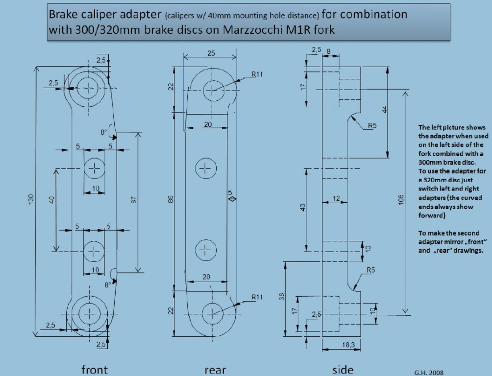

Sean, you should just need a set of adapter plates plates for the 4 Spot Calipers to suit the rotors, they were available through bevelheaven, https://store.bevelheaven.com/brake-rel ... mm-rotors/
and/or there are drawings on the site to get them made up.
This is one type below, assuming 40mm mounting centres
Peter
Re: 907ie FRONT DISC SET NEEDED.
Posted: Wed May 28, 2014 6:48 am
by bmw851
This is site member Danielmc's adapters and link to the technical drawing
https://app.box.com/shared/lzd6kxnkgk

I am using 40mm spaced calipers. You can see them on the ground. The forks have 40mm mounts.
I would like to keep both and just change rotors.
Those mounts wont help and I dont want to use "Yamembos" BMW 851 :-P

so the issue is not an incorrect offset of the discs but that you can`t mount the calipers due to the 10mm larger disc radius? I guess one could design a caliper adapter to make it work. Can`t say how that would look though.

exactly. its the diameter that is a problem.
the calipers are what I call STD gold Brembos (think 900ss) but 2-pak black.
300mm discs are the easiest solution I believe.
