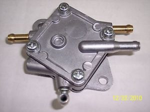

Okay, I took up dirt bike racing and got a little lost on getting my 750 Sport running well again.
I bought a Mikuni dF52136 vacuum fuel pump.
mikuni pump.JPG (11.43 KiB) Viewed 36808 times
I now realize I have no idea how to install it. I have the dual DellOrtos. There is a cap screw sticking out of each of my intake manifolds (manifold going from carb to cylinder). Do I put an air nipple into each of those, run it to a T, then into the vacuum line of the pump? Will this pump work? It has 4 nipples with arrows. 2 arrows are going out of the pump, one arrow is going into the pump and one nipple has no arrows (is this the vacuum?). Any help would be greatly appreciated. I now know this may not work...

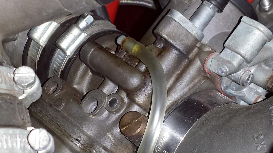

Update, is this nipple the vacuum line from the carb?
vacuum nipple.jpg (66.32 KiB) Viewed 36806 times
Each carb has this nipple, this one just has a hose that goes to the bottom of the bike like a drain. The other carb's nipple has no hose. If those are the vacuum lines, I think I can figure this out.
Dave, what you have there is a dual outlet fuel pump. Instead of having to use an Y piece in the fuel line to the carbs you can connect each one directly. The arrow in is the fuel supply from the fuel filter/tank and the nipple on the pumps cover is for the vacuum.
That small hose is not a vacuum line. If it was it would be connected to something. That`s the breather for the float bowl.
It seems like the Dell ortos don`t have a vaccum connection in which case you`d have to ad a hose nipple to the carb manifold but I don`t have Dells so I`m not 100% sure.

Can I put a nipple in this screw hole (where blue arrow is pointing at the screw) and use that as the pulse vacuum?
Re: fuel pump, rough running.
Posted: Mon Feb 23, 2015 7:34 pm
by paso750
yes. The only thing is that you will have to remove the vacuum line for the fuel pump if you sync the carbs as that is where you would connect the sync gauge.
