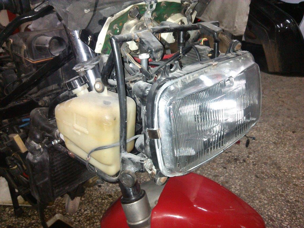

The frame doesn't seem to have been affected by the accident but the headlight mount is bent and I will need to find a good straight one. The coolant tank was broken and glued and the instrument cluster is not in its best shape.

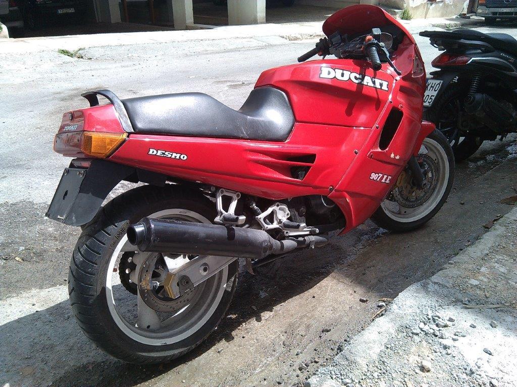

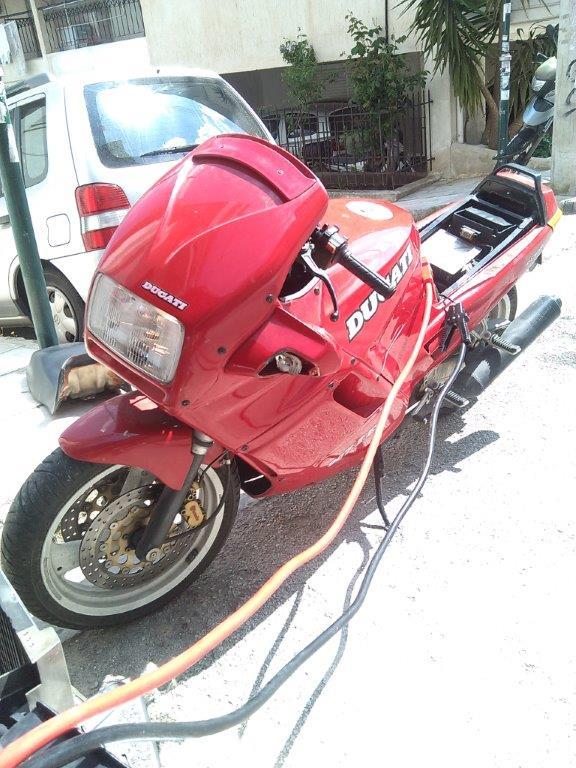

The panel repair is very good but the paintjob quality is poor so I decided to respray everything but the petrol tank which is in excellent condition.
I started preparing everything and also began making a list of the parts I will need. The aim is to make all necessary repairs and a good engine maintenance so it can be ready for the summer.

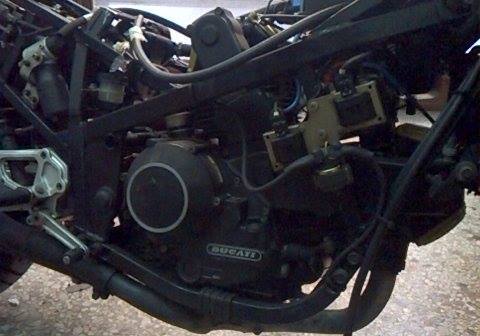

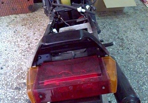

I removed as much stuff as I could and took the bike for professional cleaning. 24 years of dust and oil was gone. It needed some more manual work afterwards but the result is quite rewarding.

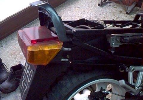

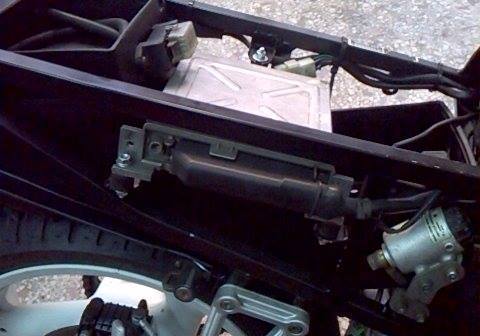

The frame section under the battery was corroded by battery fluid spillage so the plastic cover that holds the battery and goes all the way to the rear end was removed for gaining better access to the area.
This was a good opportunity to respray various black parts such as the corroded part of the frame, the rear grab bar, the brake calipers, upper fork plate, side and main stands etc

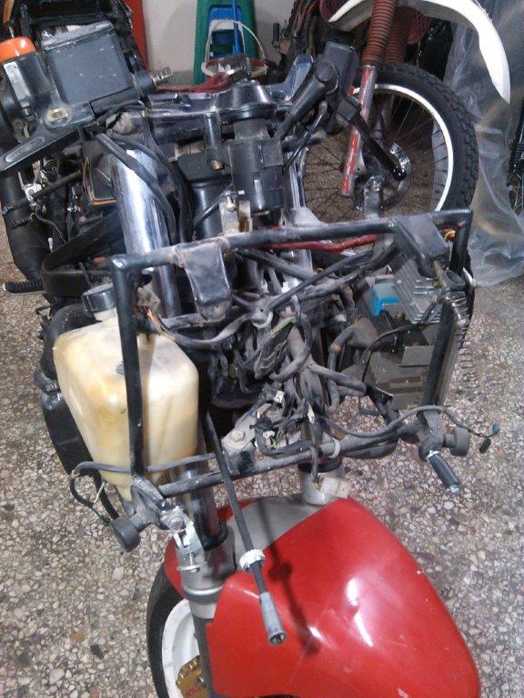

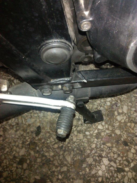

The front sub frame was damaged and was replaced by a good straight one from a 906 after cutting the voltage regulator plate mounts from the 907 sub frame and welding them to the 906 one. The result is quite satisfactory with the 906 sub frame looking exactly like an original 907.
The wiring harness had some really bad job done in the past on its plugs and connections so I repaired and secured everything. Also the thick wires from the battery to the starter relay and from this relay to the starter have been replaced by new and better ones.
All vibration dampers of the ECU and alternator mounting plate have also been replaced by new.

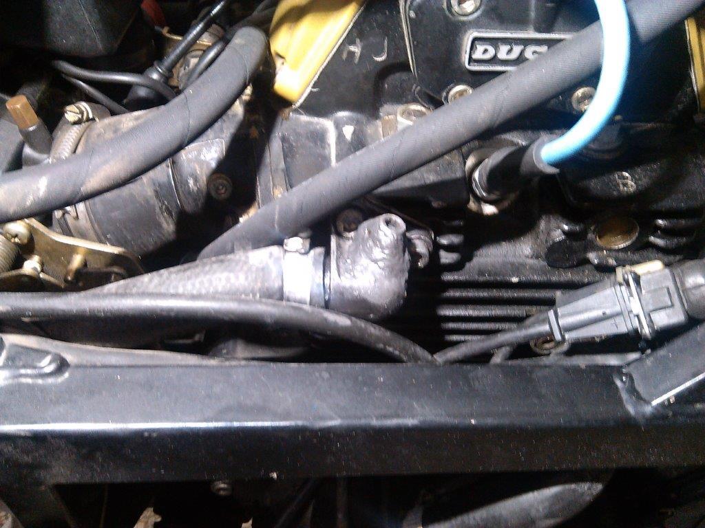

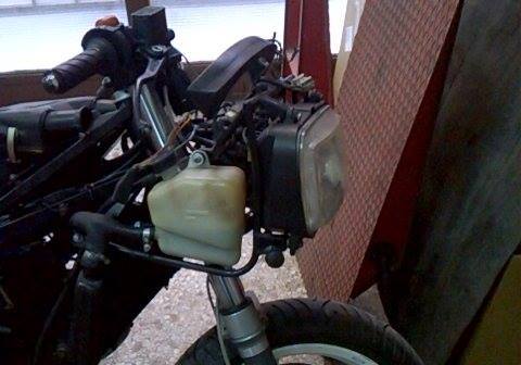

The coolant bottle has been replaced by a good used one and the coolant hose modification will come next, soon as I find a CBR filler neck.

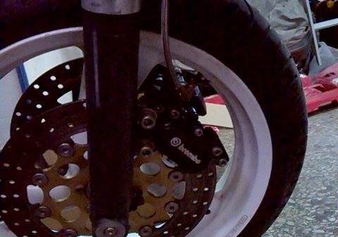

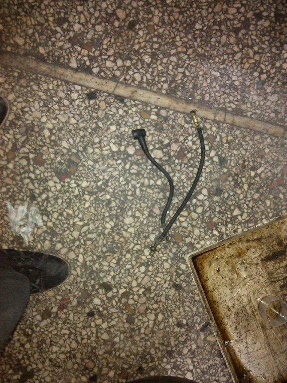

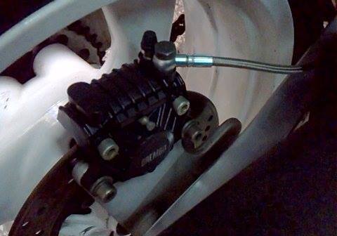

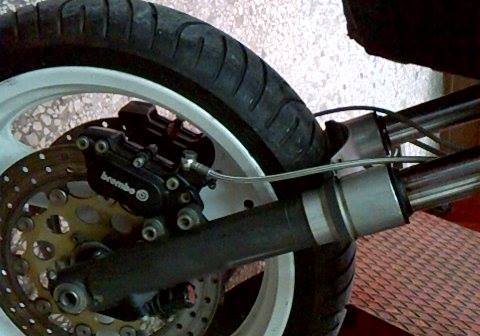

New steel braided brake hoses have also been fitted all around.

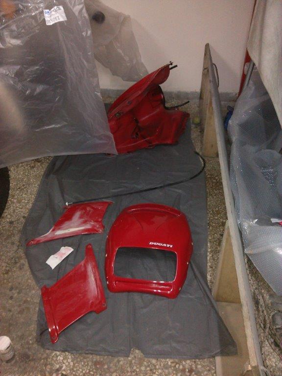

Plastic parts are now ready for getting their new coat of paint.
After a failed attempt of having the decals made by a local shop, I managed to find original Ducati ones through the Italian ebay so problem solved.

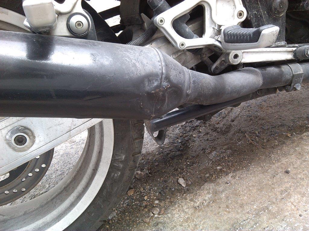

Two ways to fix the dented exhaust.
1. Find a way to block both ends and inflate to around 80psi and then take a blowtorch to the dented area, starting at the outside of the dent and work your way to the centre.
2. Find a way to block both ends and fill with water. Place in a chest freezer and check every hour (you don't want to leave it in there long enough to pop any welds).
2004 ST4S

Thank you for the excellent ideas for repairing the dented exhaust!
I was planning to remove them anyway and spray paint them with satin black high temp paint.
I saw a post not long back about using a Polaris Filler neck. It looked like it plugged straight into the original coolant hoses, rather than modifying and cutting them. I have a Plan A to obtain one and compare, but time and location are slowing me down a bit. That, and the 907 isn't moving anywhere for a little bit. Might be worth a look if you have time or inclination?

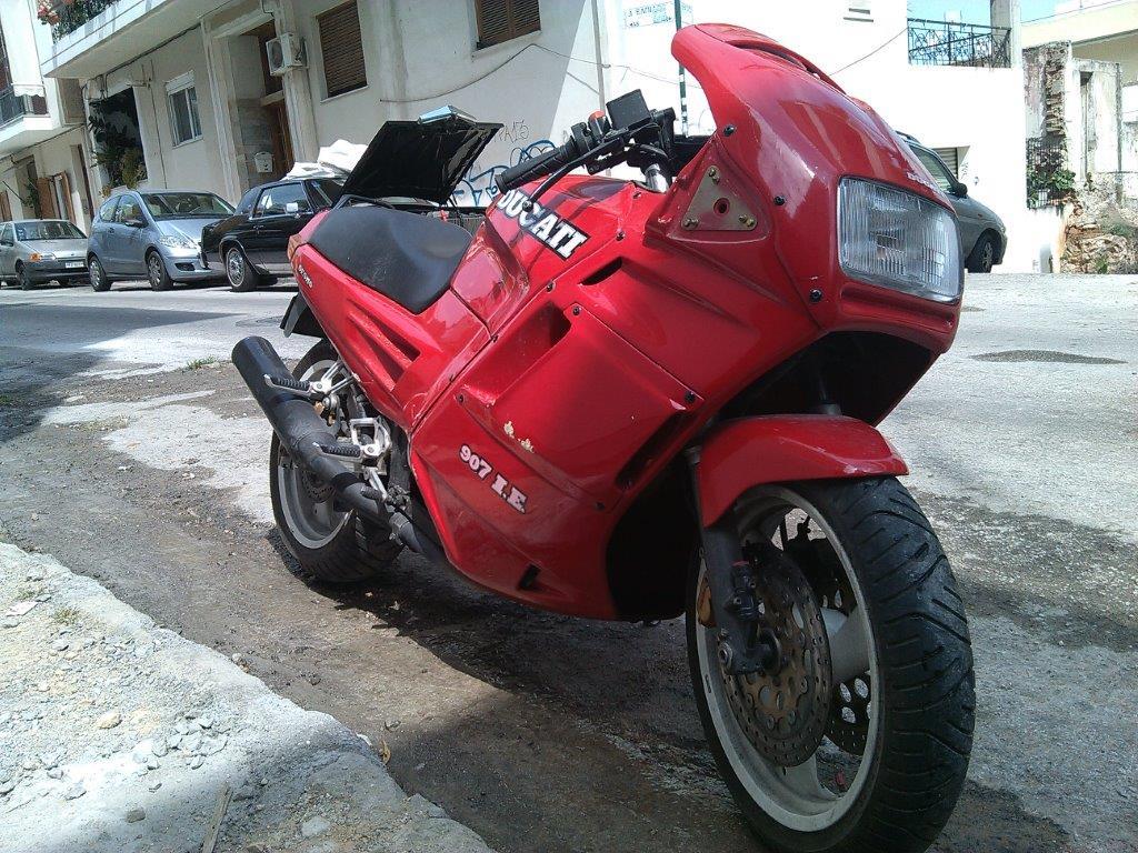

Some photos taken today.
