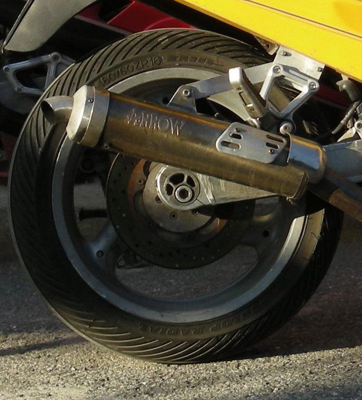

You can try to tension harder the spring and push the hydraulic lifter. More have a look to the chain tensioner. it can be twisted upward or downward.Here's a pic from mine, setted to downward. As you can see, it helps me to have some space more for my 17" rims
By the way... Don't care about the tyre label!

No eccentric adjusters on the 907 though. Same set up as the Monster and 851 with conventional sliding blocks and draw bolts.

Oh, I didn't remember how the adjuster was like!
