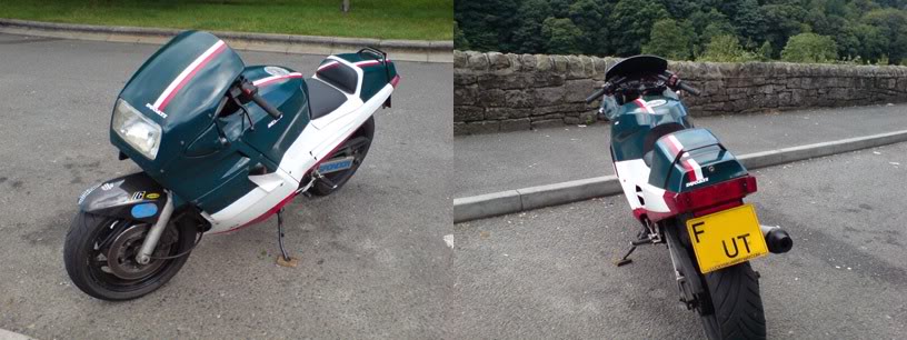

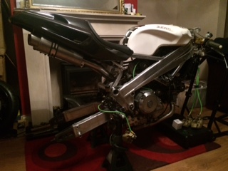

Hi all,
I've been looking at this forum for a while, so I thought I'd give it a go and join.
I've got a long-standing project bike (love/hate affair) it's a Spondon framed Ducati 906 paso.
I'll post a pic, so it will give everyone an idea of what I'm working towards and hopefully I can get some helpful tips and hints from everyone on the forum.

I've heard about this build some time ago. I'm jealous. Are you local to Spondon? I've had some work done for my Paso by them.

Hi, I'm not local to Spondon as I'm from the Liverpool area & this probably isn't the bike you think it is but I could be wrong? I've owned it for 11yrs or so & it was bought through Sports Motorcycles Racing Ltd from Steve, this is the one bike I won't part with. I should have it up and running after the new year after a suspension rebuild from Kais, new supercorsa tires, then back to G.I.A Engineering Nottingham, then a full rewire..... What did you get done by Spondon, I'd like to see if you've any pics?

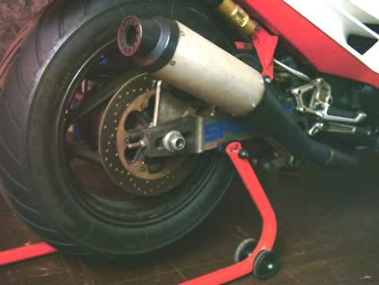

I have had floating front discs and sliding adjusters for the swingarm made. Will post some pics or redirect you to the relevant ducatipaso.org page. The point of Spondon used to be racing frames when the mfr's were not much good. They are doing a lot of work for the 'New' Norton now but still make custom frames etc.

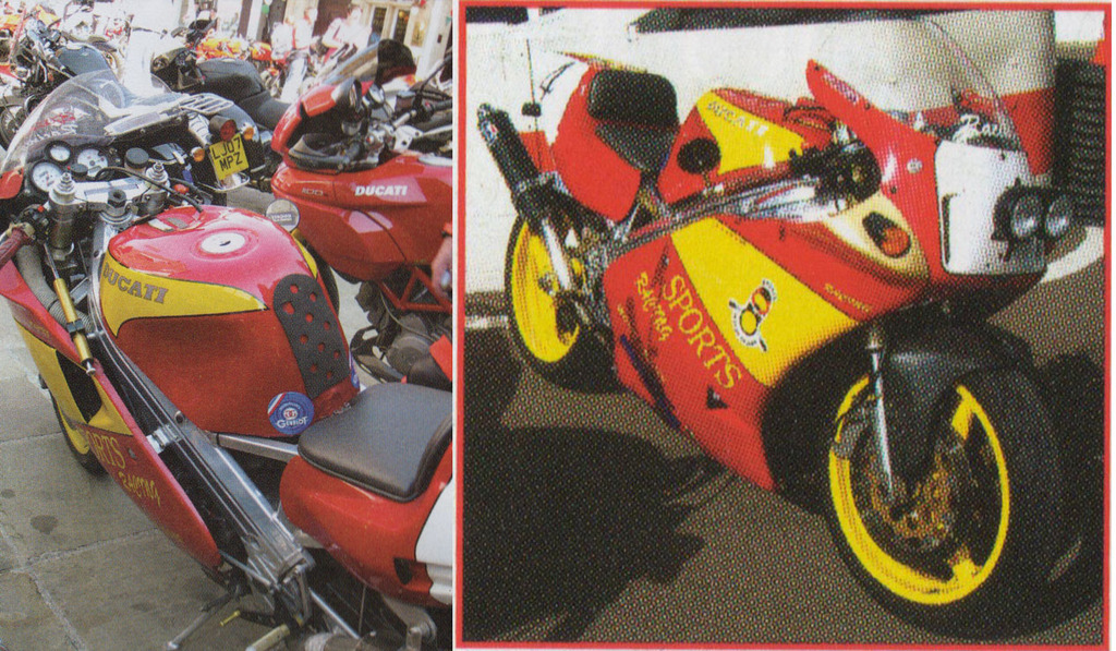

Here is a the Spondon Ducati I was thinking of. This machine is owned by a rider from Hampshire but I expect the frame spec is the same as yours. I don't know what Ducati engine is in this one. I notice you have yet to add a radiator to your Paso, that will give you a chance to connect the thermostatic valve correctly vs Ducati's attempt.

Here are a few images. You can see the discs' and the sliding adjusters (which are a bone of contention among other Paso owners)

JWilliam wrote:Here is a the Spondon Ducati I was thinking of. This machine is owned by a rider from Hampshire but I expect the frame spec is the same as yours. I don't know what Ducati engine is in this one. I notice you have yet to add a radiator to your Paso, that will give you a chance to connect the thermostatic valve correctly vs Ducati's attempt.
It's a slightly newer Spondon duke than mine with the 888 motor fitted, check out this link, it makes for a very interesting read: http://www.speed-trap.co.uk/spondon.htm
there's also a link in the Speed trap read up to the new sports motorcycle Ducati shop but without Spondon built bikes as that chapter in life has already been set.

JWilliam wrote:Here are a few images. You can see the discs' and the sliding adjusters (which are a bone of contention among other Paso owners)
I've also got the same adjusters on mine, Spondon adjusters are very recognisable, love it :))
You must be very happy with the way it stop compared to the standard items?

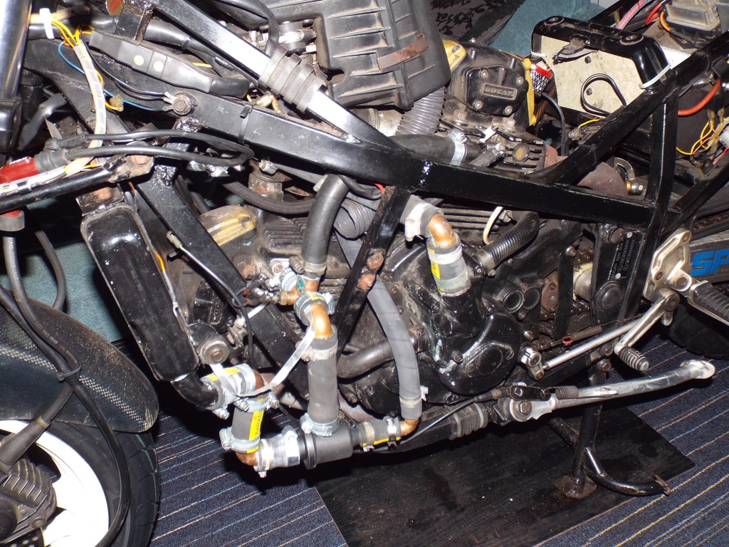

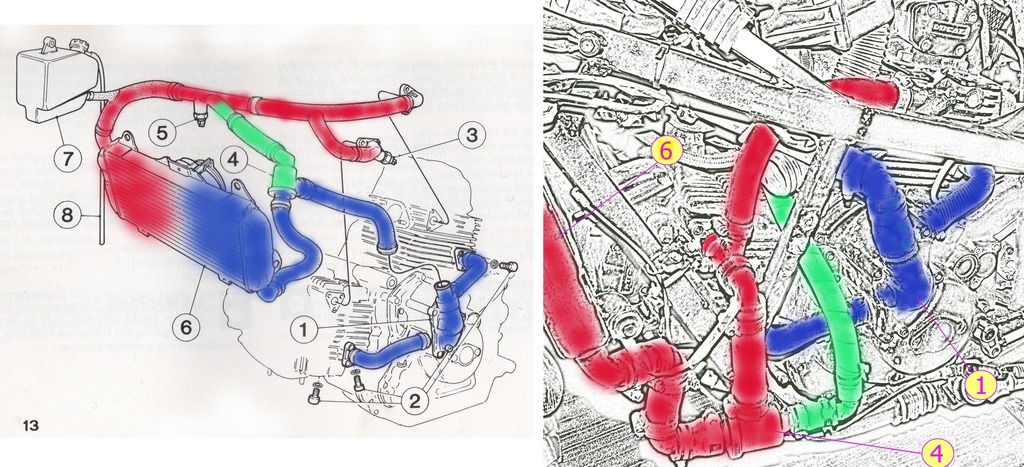

The Spondon floaters are a huge improvement over the standard cast-iron rotor braking which couldn't be much worse. How this bike got through TUV testing etc with that set up is beyond me. You might have some trouble setting up the radiator - thermostatic valve etc since the hose routing is far from ideal. These images show what I've done vs the standard set up. Blue is cold/cool water, Red is hot and Green is reheat for cold start-up. The problem is that Ducati are switching the thermostat with water cooled from the radiator. I noticed my 906 ran hot so purchased an Aprilia thermostat rated at 75C and when I removed all the hosing and inspected the Ducati thermostat it too was rated at 75C. I racked my brains for ages trying to think of an alternate method and settled on dropping all hoses underneath the frame and reconnecting there. Sorry about all the copper connectors, one day I'll send it all to Samco. There's no shame beneath a full fairing. The routing I have employed runs the water backwards thru the radiator but finally has stopped the over-heating. The 906 coolant hosing is the same on the 851 and they have made the same mistake. You buy a new bike that runs hot and is prone to over-heating. It's quite a blunder.
Spondon906
Posts: 26
Re: Hi, new to forum so thought I'd post a photo.
Post by Spondon906 »
Bloody hell, it looks really busy under the paso fairings, I'm going to need my hoses changing too, I might just by the silicone hoses individually of eBay, not sure yet??
