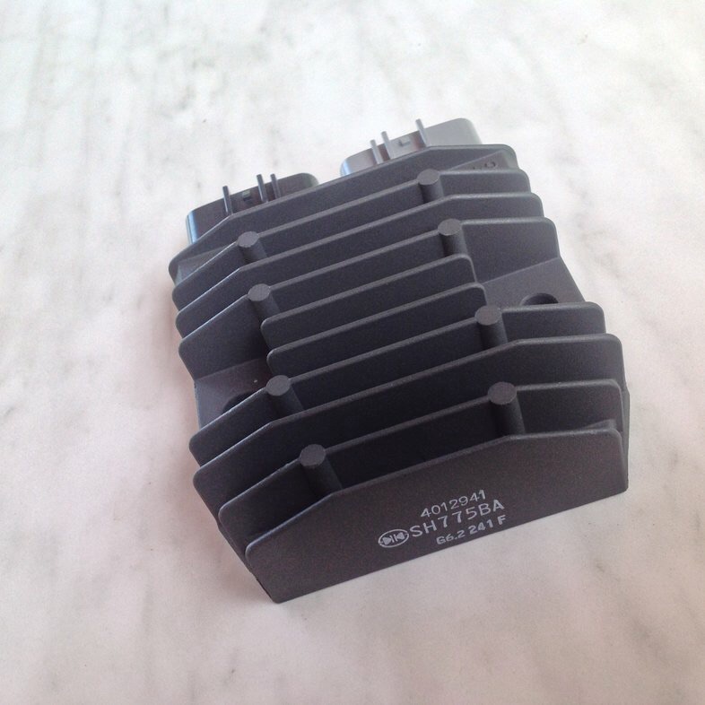

Hi,
Bought myself a brand new, original Shindengen SH775 serie regulator/rectifier in the hope it will work. :fart:
All remarks, reviews & advise that I've read, have not convinced me it will but I will inform you if it is plug & play or not. :wacko:
I've got 2 yellow and 1 red wire coming out of the stator.
Also not sure how to connect the output wires (original has 3 positive connections, the Shindengen only 1).
Tempting to take the 3 together but not 100% sure yet (anyone?).

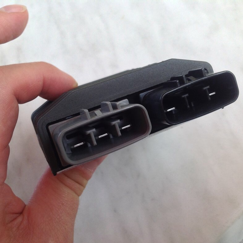

1 question though: does someone know the name/type/brand of the 2 connectors used on the Shindengen R/R? :?:
Need to have them and I would like to get them somewhere from Europe (to avoid customs - cost & handling fees, the original SH775 was already quit expensive).
SH775 R/R (Polaris)
SH775 R/R (Polaris)
SH775 serie Shindengen connector side

http://www.cycleterminal.com/furukawa-qlw-250.html
you should check local jap bike or Triumph dealers. They may sell them, too but of course under their own part number so it would make sense to visit personally and take the regulator along.

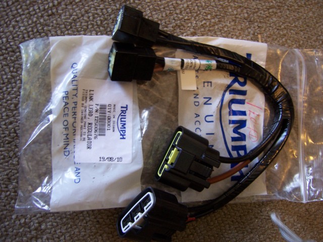

Re: Shindengen SH775 serie regulator - connectors
Triumph #T2500676

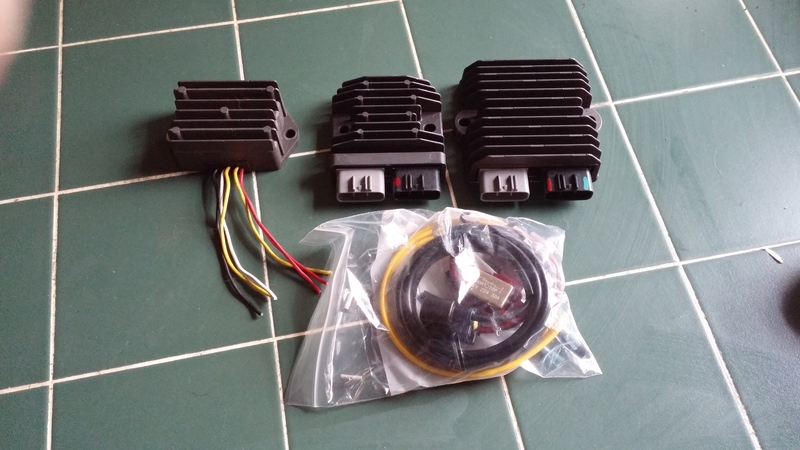

http://roadstercycle.com/
has everything you need to know and can sell you the connector-terminal kit for 20USD
Almost all bikes made these days use these regulators as well as snow mobiles etc
they hook up just the same as any other regulator

higgy wrote:http://roadstercycle.com/
Awesome , why would you buck afout with anything else :)
Posts: 3381
The electrosport :drunk:
The FH series :thumbup:
The SH series :beer: :beer: :thumbup:
The FH/SH connector kit :thumbup:
