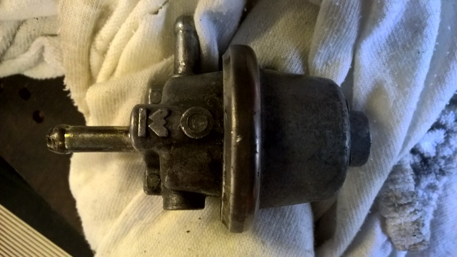

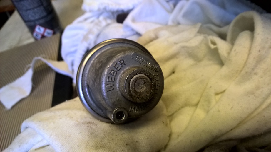

Hi!
I need a "new" fuel pressure regulator, as mine fails completely.
Any clue where to buy one (in Europe) with a reasonable price?
Thanks

I assume you can use the one from later Ducati IEs (SSie etc) if you get the pressure regulator incl. the housing.

I bought one for a more modern Ducati, I think it was from an 848? The critical thing is that it maintains the proper pressure, which I believe is 3 bar, and it fits into the general space allotted. My local Ducati dealer got me set up with one that has worked fine.
I am figuring you have a 907ie. Sure looks like the part I took off mine some years back.
