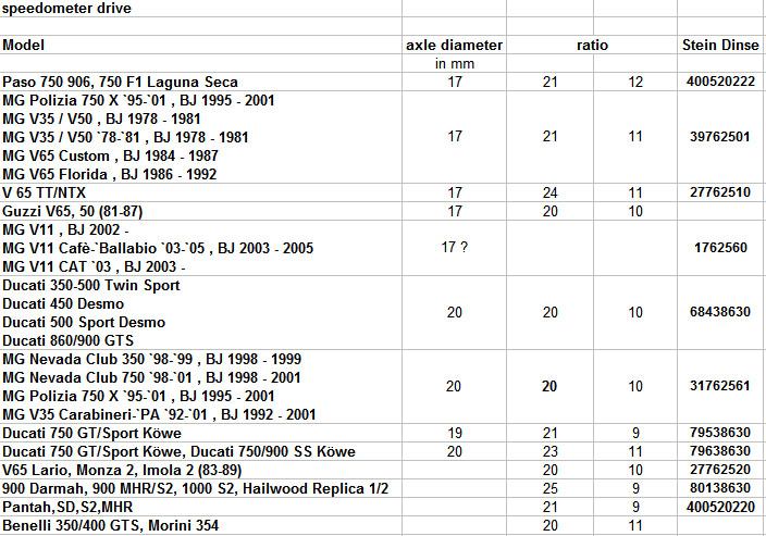

Re: HELP! 17 inch wheel conversion. All AOK Except Speedo w
a while back I was looking into speedometer drives and checked for similar narrow ones. I only looked for parts used on Ducatis and other italian bikes. Noone had the same ratio.
- Unbenannt.jpg (183.71 KiB) Viewed 98764 times
