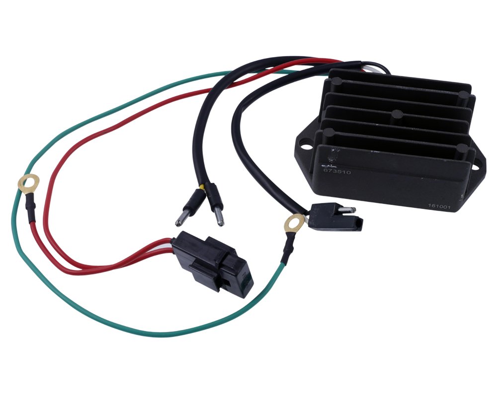

I have found a UK supplier of this which I believe is supplied by Electrosport in the states are they suitable replacements?

ANY ONE KNOW - ARE THEY ANY GOOD/

Looks, that such is not Electrex. I dont know realibility of those, but Electrex is very good one. Stiv, if You want Electrex, i think, that they have importer from USA to UK .... As last time, when i ordered them from USA(3 units), items came to me from UK, not direct from USA! ....and then i had not to pay any taxes, VAT's etc...

Stiv, why are you looking for a regulator in the first place? You mentioned you already had more than one. Imho it makes no sense spending the money if you're not certain that's the main issue.

My problem is that I want to test a brand new perfect Regulator/rectifier for a base level test as everything else seems to pan out okay.
All three current units that I have are just frustrating the issue as they all give a varied and different perspective.
Neither are for certain giving me any charge rate.
I have cut away as much of the shrouding that I can on the loom and apart from some oily damp residue no sign of scorch or burn marks, none of the plug sockets are corroded or damaged, Fuses are perfect and new.
