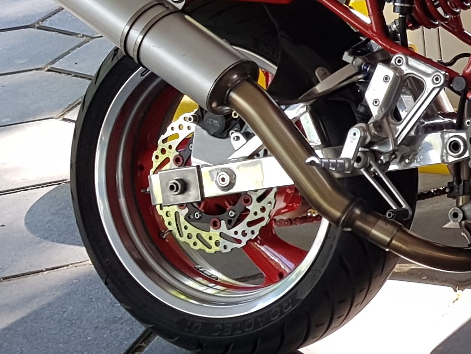

After quite some search throughout the web I finally ended up with a BrakeTech disc.
I was looking for a floating rotor.
https://braketech.com/axis-rear-floaters-2/

From what I understood Michael has the old brake disc on his new rear rim. The brake disc bolt pattern of the 16" and 17" rims is different so the BrakeTech one won't fit.

Posted: Fri Jun 08, 2018 11:16 pm
by micap
Paso750 is right. I have had some custom 17 inch wheels made, and as it is now I am using the original rear brake disc. I was just wondering if I could find a disc that would match the newer type brembo discs. But if seems to be a bit difficult. Luckily, the rims are made with bolt-on brake disc adapters, but it will be quite expensive if I I need to have a new disc adapter machined.
