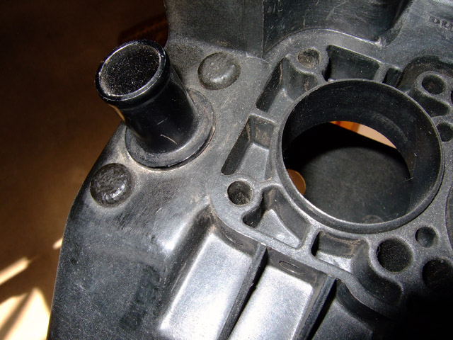

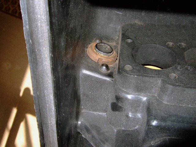

Re: 906 airfilter box - crankcase ventilation membrane
If a piece was added into the breather hose which is also named 'valve' I assume it has a membrane.I did look at the Stein Dinse 906 parts list but wasn't sure it was with a membrane inside.
No idea why there are two holes but they are closed with rubber plugs.

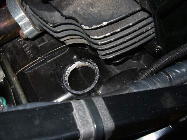

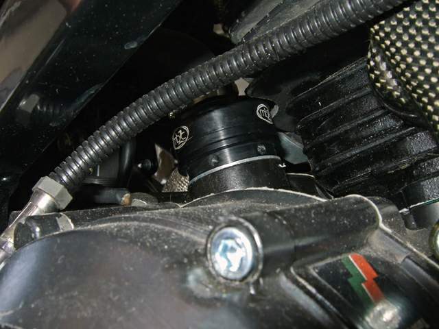

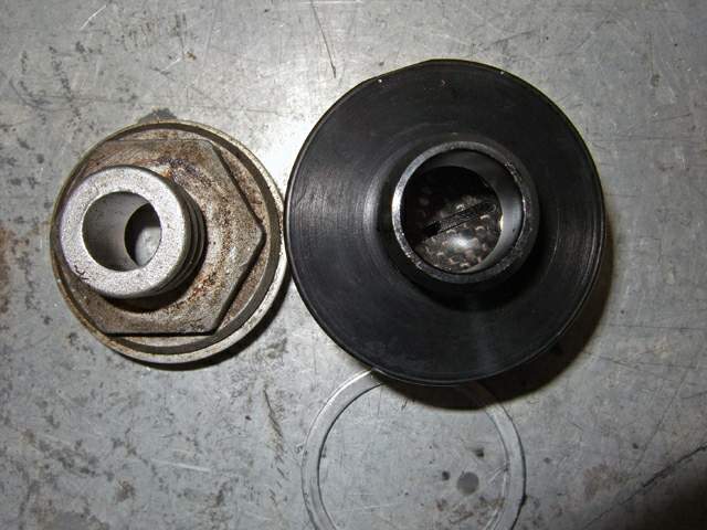

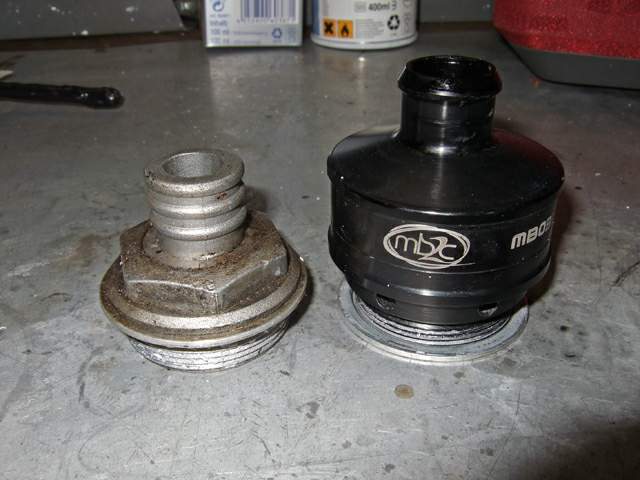

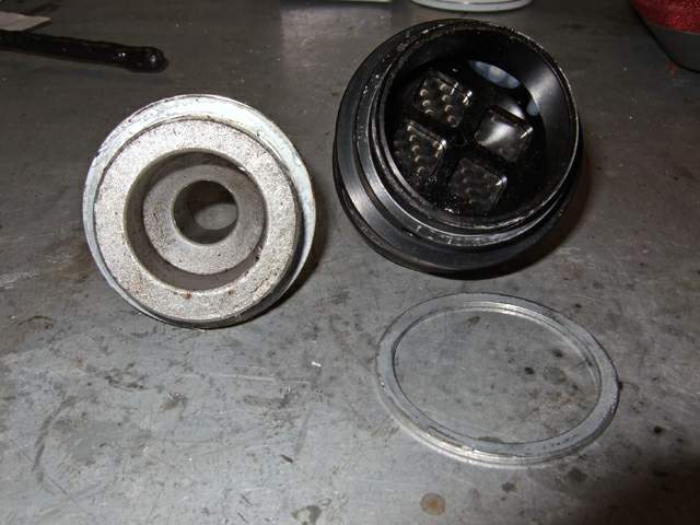

Yes those aftermarket ones fit. Since they are higher the hose will need to be shortened about 15-18mm or it will kink. Many aftermarket breathers have no membrane. Btw there are articles about crankcase breathers and the pro and cons of them having a membrane.So if I understood well I could buy one of those fancy aluminium ones you see on ebay (CNC, etc.) and it would fit on my 750 engine?!![]()
Any idea if the outside diameter, where the hose fits, is similar to the 750 version (meaning: the hose fits breather tank aswell as the mentioned later adapters)?
Someone who has mounted one of those?![]()
- DSCF7592_zps05892318.jpg (35.57 KiB) Viewed 12471 times
- DSCF7594_zpsd69e7f73.jpg (38.03 KiB) Viewed 12471 times
- DSCF7595_zps459a9028.jpg (42.2 KiB) Viewed 12471 times
- DSCF7596_zps130cd99b.jpg (38.7 KiB) Viewed 12471 times
- DSCF7598_zpse774203e.jpg (39.63 KiB) Viewed 12471 times

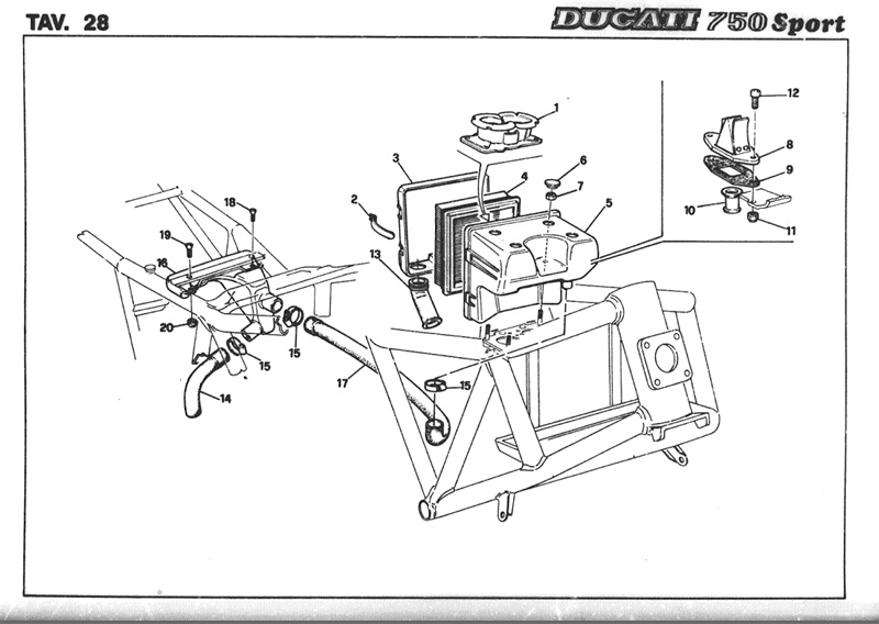

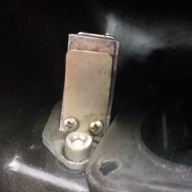

Hi,
Got another air filter box from Rudy since I was looking for the hose nipple that I was missing.
To my surprise this 906? air filter box has a membrane in it .... didn't see that on the 906 parts list.
And although provided with the same part number it is actually a little different to the other 906 air filter box.
There is and old sticker with italian on it so I assume it's been used in Europe, but again I didn't know it existed.

- 1539337259510.jpg (18.75 KiB) Viewed 12398 times
What Rudy sent you is the airbox of a 750 Sport which indeed has the same part number as the one of the 906 but is and looks a bit different.
