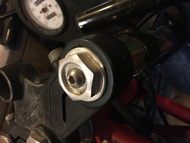

Hopefully photo attached. Those more wise on such matters will tell us if the top is standard or part of the maxton upgrade
bbeen71
Posts: 28
Joined: Tue Jan 21, 2020 2:18 pm
Location: Norway
Re: Fork upgrade 40mm MR1BB
Post by bbeen71 »
Thats different from my top cap, but also different from the top cap on the kits they sell now I think.
Posts: 2004
Ah, so thats where the missing fairing screw went
