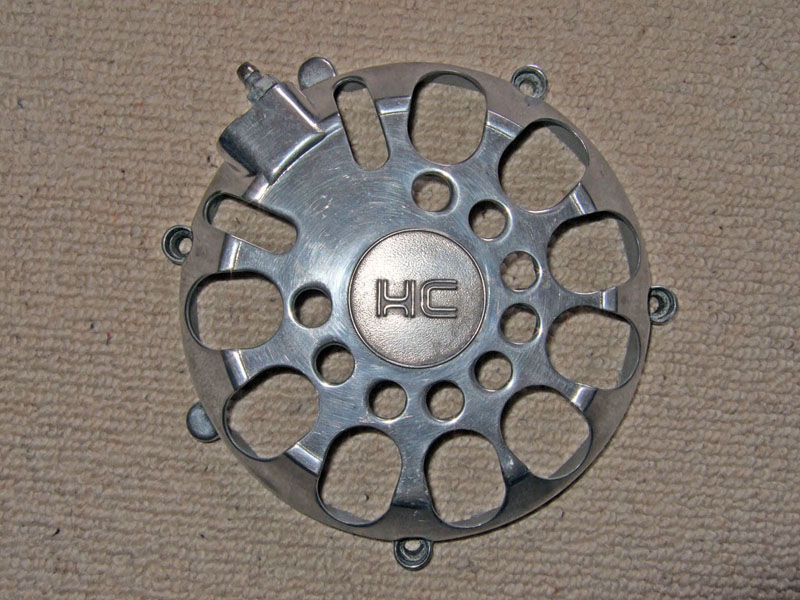

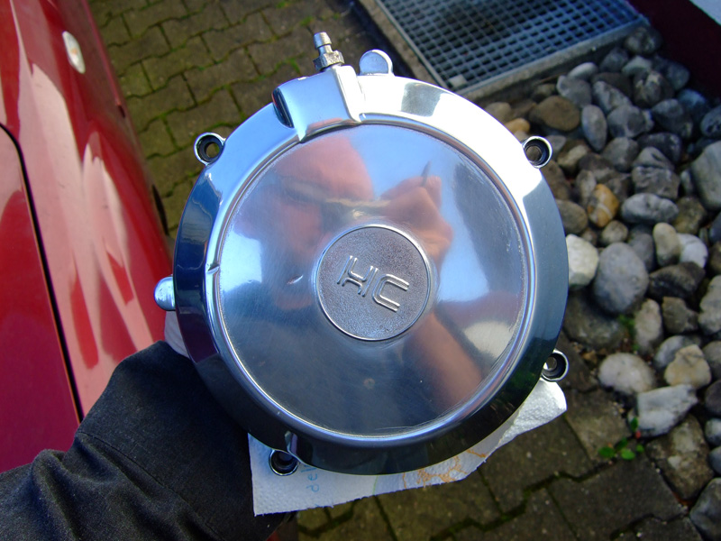

Re: brake/clutch fluid resistant paint
I had two polished ones but to be honest I prefer them in black
- DSCF0442.JPG (155.61 KiB) Viewed 64393 times
- DSCF9227.JPG (205.22 KiB) Viewed 64393 times

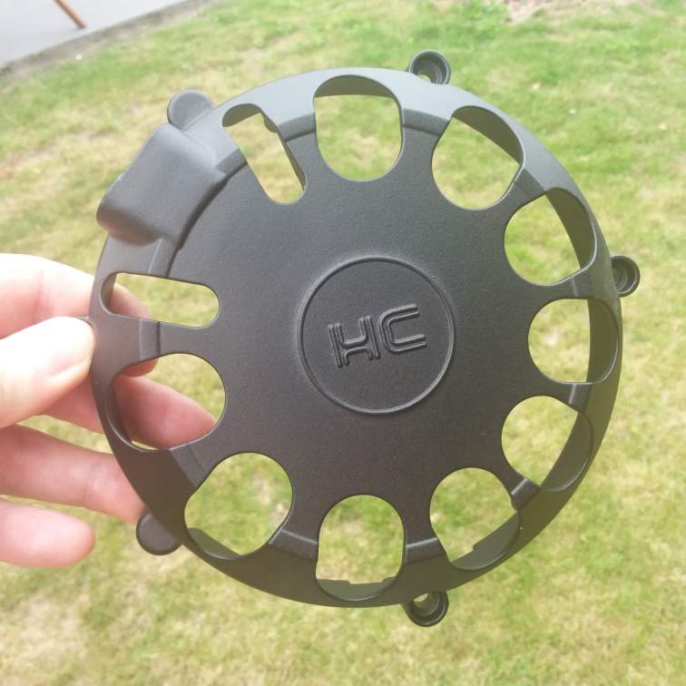

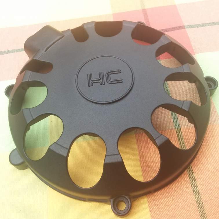

Here I've a little relief in the paint (difficult to see on this low res. pics), looks nice in reality.
Is powdercoat by the way.
- open clutch cover - paso 756.jpg (50.45 KiB) Viewed 64388 times
- open clutch cover - paso 756 b .jpg (52.97 KiB) Viewed 64388 times

I don't really have an answer to this.do you think the drilling is the way to go
Fact is those clutch covers are becoming rare so the first question should be: do you really want to drill holes into it? There's no going back and try to find another one. They do exist and sometimes prices are reasonable but that's not often.
You will notice after a short ride that the closed clutch cover gets really hot. The vented one has a clear benefit. Also it will blow the dust out. In the end this will probably make your clutch last longer.
On the other side the clutch noise/rattling will be louder. Also after a while you'll probably notice some surface rust on parts like the springs which now you'll be able to see.
That's specially if you live in a wetter climate or if the bike is parked for a longer while. These two things could also lead to the clutch pack getting stuck together. But for that the bike will probably have to be in storage for several months or even longer.
If you just want to get some dirt and heat out you can install a washer between engine and clutch cover so you have a little gap. (A washer - not a spacer). The way of the piston is long enough so that the added washer won't be a problem.

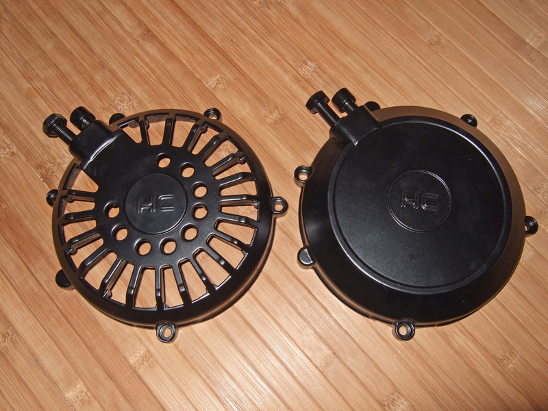

Just like Frank, I do have both (also powdercoated black)
- DSCF0585.JPG (252.07 KiB) Viewed 64379 times
