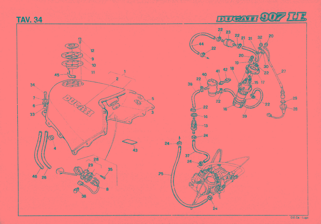

Had the bike apart tank off etc.. to do the fork seals and now when I turn on the ignition the fuel pump primes and pressurised fuel leaks from the front outlet on the tank where the hose mounts before it goes to the injector. It blows past the hose clamp. Have checked there is no fuel from the return line with the tank on, so something is blocked outside the tank???? What is the thing that the flow goes through after the injectors before it re enters the tank to the degasator?? Fuel pressure reg? Can it fail while your looking at it and can it block flow when it does?
Pages from 907 IE Parts Catalog-3.jpg (123.55 KiB) Viewed 14958 times
That's the Degaser #40. Or maybe some trash got dislodge when removing the tank. I would check and blow out the steel tubing in the tank. Also there is a "fuel reversion valve" #13 between the injectors and the degaser. The regulator is just behind the TPS.
