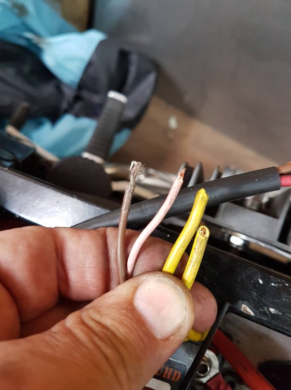

Hi, Could someone help me please am pulling my hair out!!
I have a replacement regulator which only has 2 x red wires, 2 x yellow and 2 x Green wires.
My bike has 2 x red, 2 x yellow, 1 x Brown and 1 x pink, I have looked through pages and pages of info on the regulator and cannot see any info on the brown or the pink wire. I know the yellows go together as do the reds and I believe the greens are both earth? It is the brown wire and pink wire which originally were in a rubber connector and plugged into the old regulator I have not a clue where they go. Any help would be greatly appreciated

You have 2 red and 2 yellow, a brown and a pink wire? That's interesting as those are the colours that can be found on the 907IE.
According to the wiring diagram the 906 would have 2 pink, a red, an orange and a red/black, a light blue and a brown wire.
Is there anything stamped on the regulator/rectifier, a model or number which could help identifying it? If not, please post a picture.

paso750 wrote: ↑Tue Aug 16, 2022 9:02 am You have 2 red and 2 yellow, a brown and a pink wire? That's interesting as those are the colours that can be found on the 907IE.
This is a photo of the wires on the bikes harness
