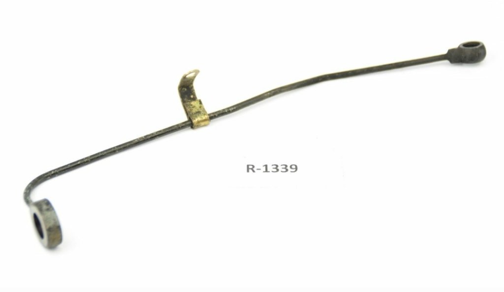

I have recently seen that this piece of the oil circuit does not fit in all Paso 750. In which versions were they mounted and what was their purpose?

The answer is none. The same seller has a few other parts that are supposed to be Paso parts but aren't.

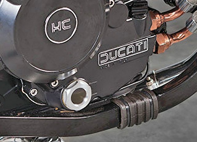

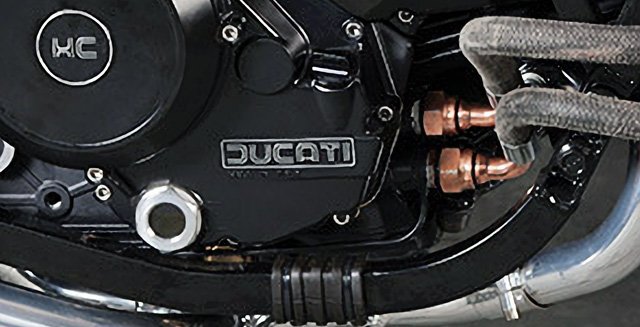

But I have seen this engine with this part, like the one in the image.
It comes out of the lower radiator oil tube and goes to the rear of the crankcase.

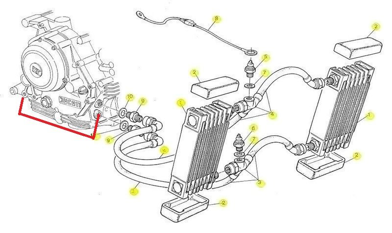

It goes to the rear crankcase bolt, where the anti-rebound brake bar bracket goes (look at the red line, that's the way). In this case it will be drilled.
