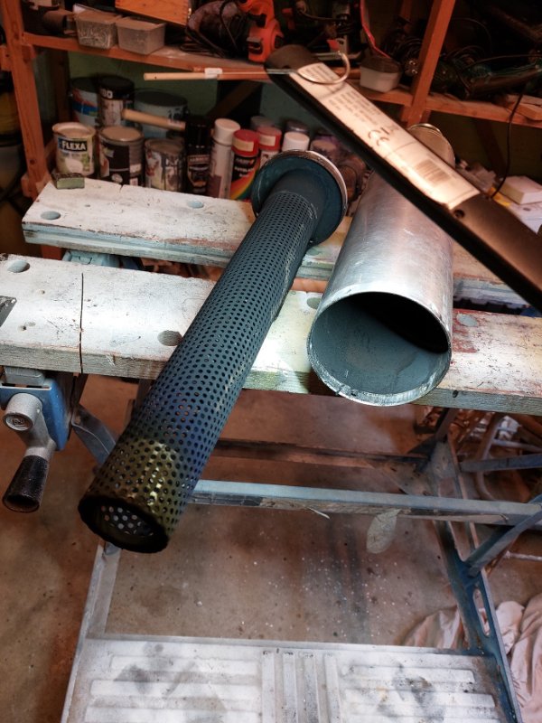

Took one of my mufflers apart, and they were completely empty :banghead: Insulation material completely gone. No wonder they were so loud....
Now in the process of repacking them;

Over the years the glasfibre packing burns out and is blown out the exhaust. Be sure not to stuff in the new material too strongly otherwise the exhaust will remain loud.

Yep ,I wrapped the inner tubes with stainless wool and mig wire , then fitted the outer sleeve and stuffed the outer area with fibreglass mat .
As G sez above .....sorta, the tighter you pack the fibreglass in the noisier it will be but the packing will last longer ......happy medium sort of thing 8)
