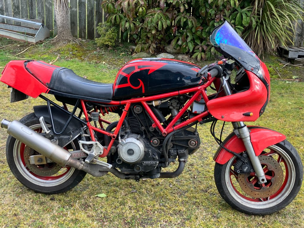

So I got the bike cheapish with 48,000km on the clock, dead rego and highly 'modified' appearance with the lower fairings missing due to a prevoius crash. I was looking for a pre '89 bike to turn into a classic racer. So thats the plan..

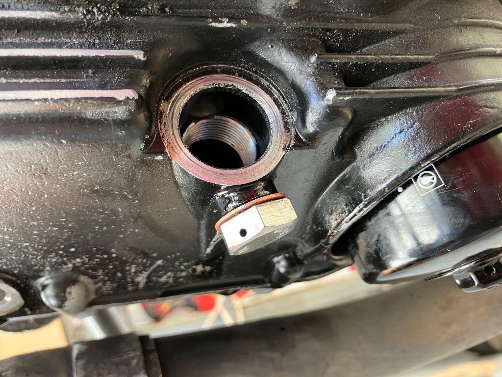

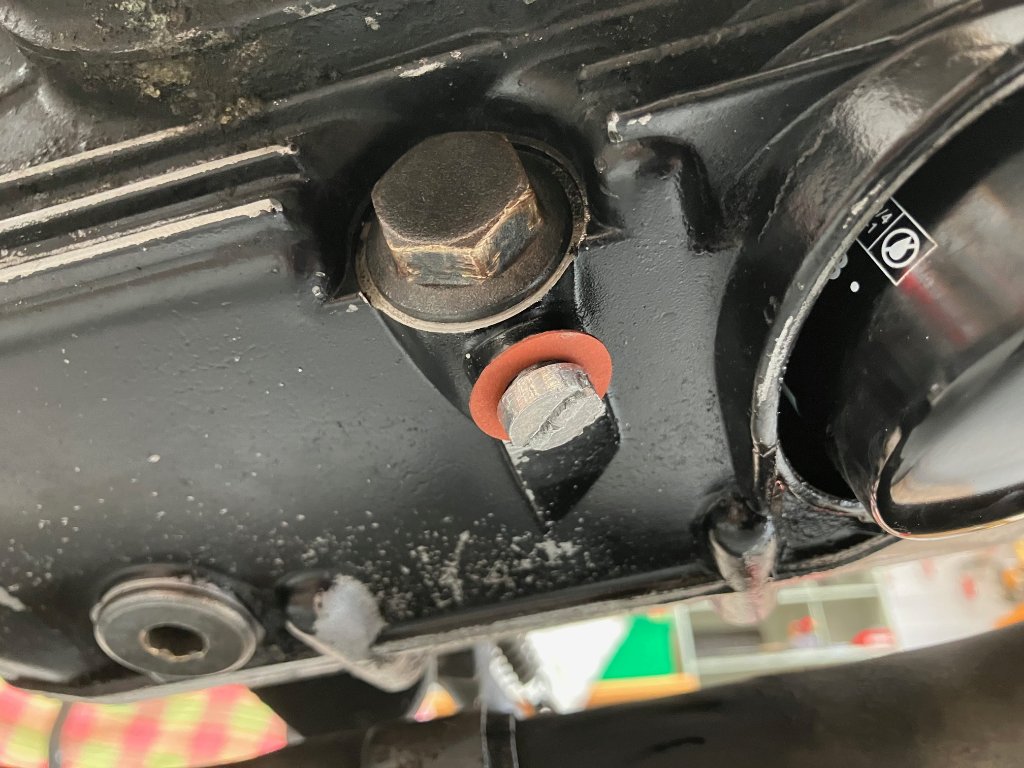

It had an oil leak on the LH case cover so I took it off and fit a gasket. At the same time I did an oil and filter change. Kinda weird having that extra little drain plug underneath the gauze filter housing?? My bike has an aluminium sloted head plug in there that is really tight on the thread. Is this standard? I'm going to need something I can drill like a hex head to get lock off wire through it.

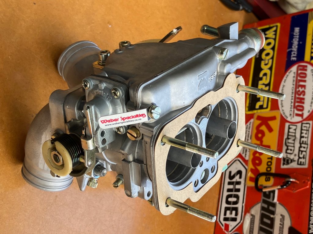

I've decided to stick with the original carb for now even though I know its not the best set up apparently. I sent it away to a Weber specialist outfit and they did a real good job cleaning it up and checking everything over. They found lots wrong (butchered!) with it so at least I know it is stock spec now. Looks like new now!

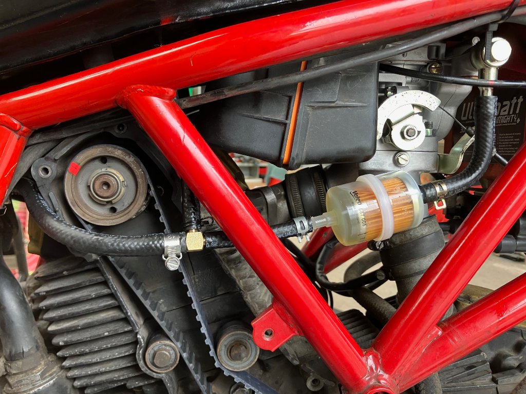

During the process of fitting a new fuel tap and inline filter I discovered there was no return line to the tank. I found it a bit fiddly trying to fit all this up near the tank with frame rails and the rear timing belt cover in the way so I have lowered everything down.

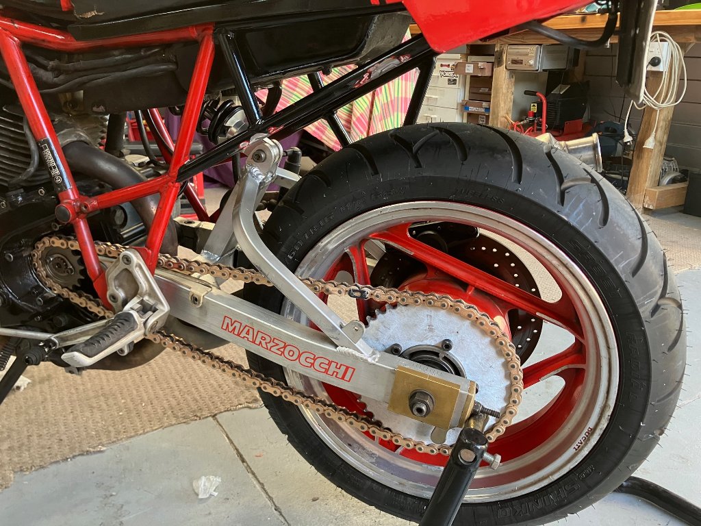

Its been nearly three months since I updated this thread but there has been work going on! I had a bad fuel tank leak at the front mount plate that took two attempts to fix and I lost enthusiasm for the project there for a while... But I'm back up to steam now as I have a race meet which I wish to participate in a fortnights time. I wont have time to get any cosmetics done bar a rattle can paint job once I finish removing the previous owners wrap design, so I've just been concentrating on getting the mechanical bits sorted:

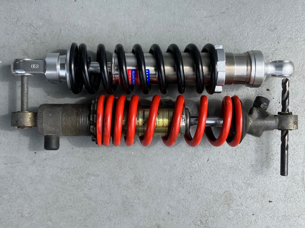

I started at the rear of the bike by removing the rear swing arm to get two cracks welded up and when I put that back in I fit a new Hagon shock. Unfortunately the Hagon shock is 5mm shorter than the OEM one despite being listed as the correct model for this bike. This has done nothing for my race geometry (opposite of what I want) so I've pushed the forks 10mm through the triple clamps to compensate. Not ideal as I'm losing ground clearance here!

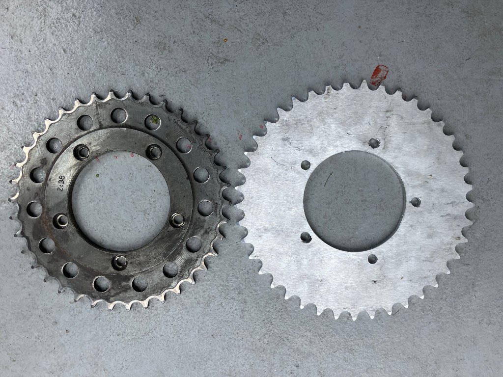

I wanted to lower the gearing but I couldnt find alternative size sprockets here in NZ so I bought a 41 tooth 520 pitch aluminum blank and lathed the center to suit the sprocket carrier and drilled the bolt holes to match. Weighs nearly a third of the OEM steel sprockets weight. Fitted new chain and front sprocket as well. You will notice in the second photo that I also cut off the pillion peg mount. Can re-weld it back on in the future if need be.
While I had the rear wheel out I fit a new Shinko tyre and I gave the rear brake a clean up and fit new pads. I did not refit the rear wheel hugger.

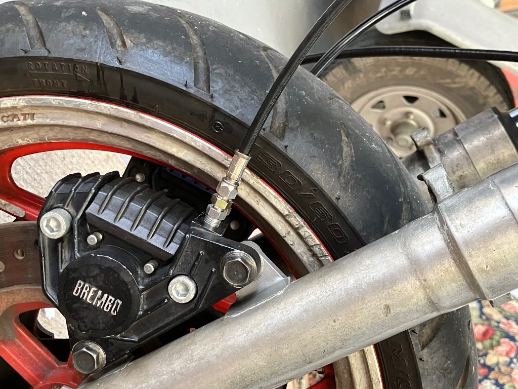

Front end: Brakes

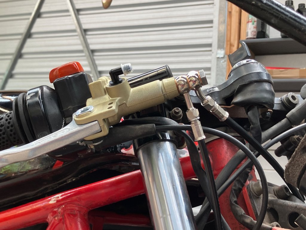

Big upgrade here, I fit a new Brembo master cylinder and got braided lines made to suit. It looks like I got my hose lengths correct luckily. I pulled the calipers apart for a deep clean and new seals. The ceramic pistons were in really good shape. I ordered a double banjo bolt with bleed nipple attached (second pic) as I have found from experience this makes bleeding up a whole lot easier. The lever travel is only 1/2" and very firm. I fit Newfren sintered pads as well. I hadn't used this brand before but they are Italian so kind of in keeping and they appear to work well. I'm real happy with the brakes on a road test but the track will be the acid test. You will see from the photos I need to make a mount bracket for the aftermarket reservoir!

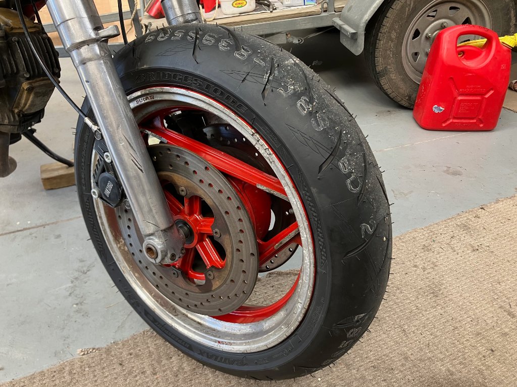

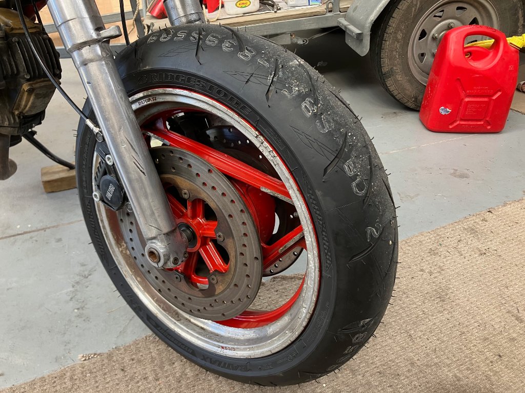

While I had the front wheel out I fit the new Bridgestone S21 in size 130/70/16 which I believe is the same front tyre as the original CBR900RR Fireblade.
This caused an issue with clearance for the front guard, so I had to raise it half an inch using spacers under the fork brace which supports the guard. Front end turn in has improved a lot with the more rounded tyre profile.

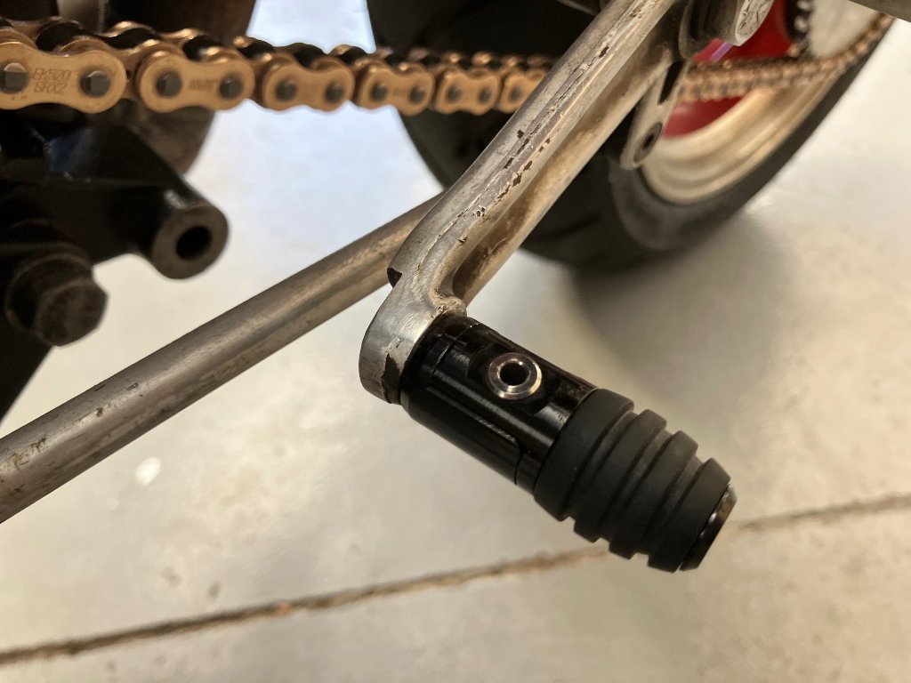

I had a spare Woodcraft folding tip for a gear lever floating around my race supplies box so that got fitted. Theres some slop in the linkages I need to address at some stage too.

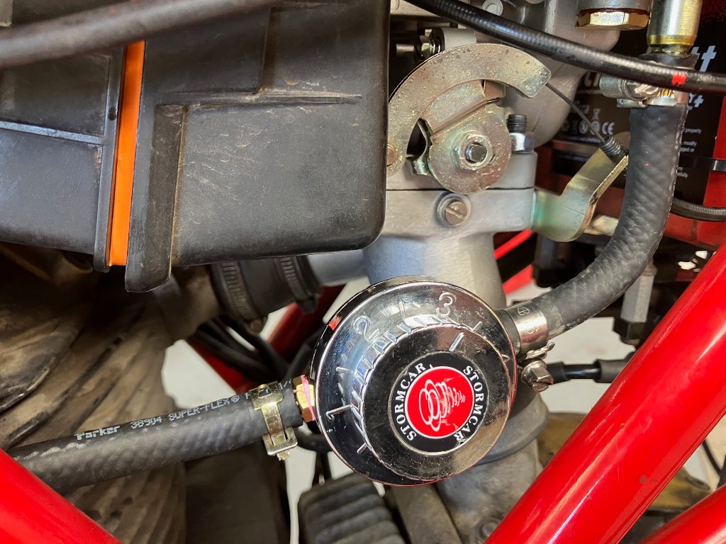

After doing some reading on this forum I decided to purchase an inline fuel pressure regulator to see if that would improve my running. I found a 1-5 PSI jobbie on AliExpress for not much and it has definitely helped. I have it set on 3 PSI but TBH it doesn't seem to change much if you adjust the knob in either direction. I want to check with a pressure gauge just what my actual fuel pressure is but it's definitely helped fitting this device. The bike is starting a lot quicker too.

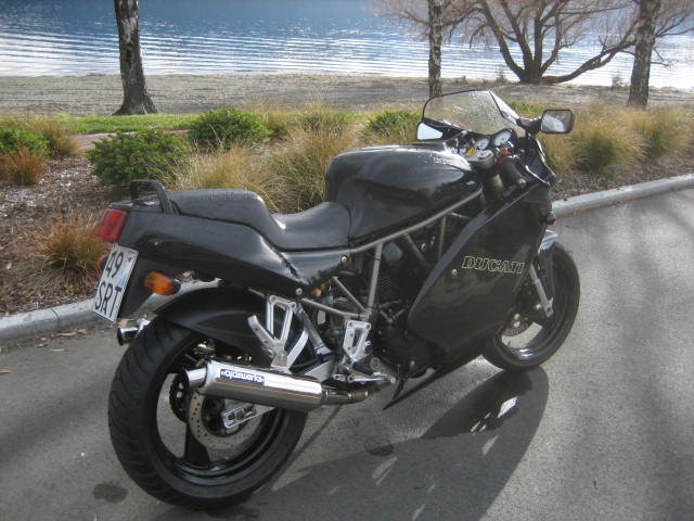

bike photos 017.jpg (72.85 KiB) Viewed 248445 times

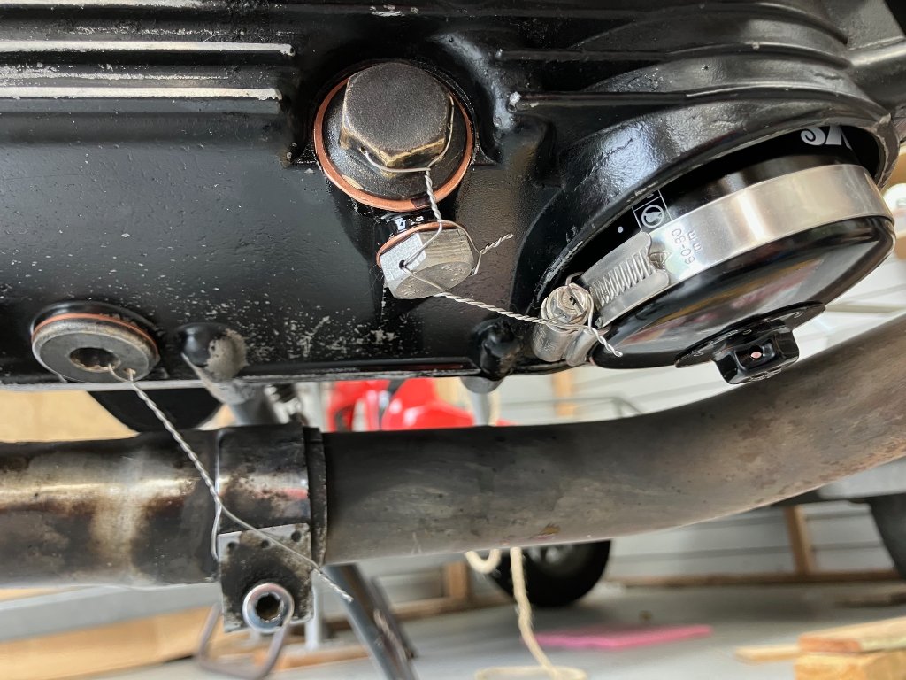

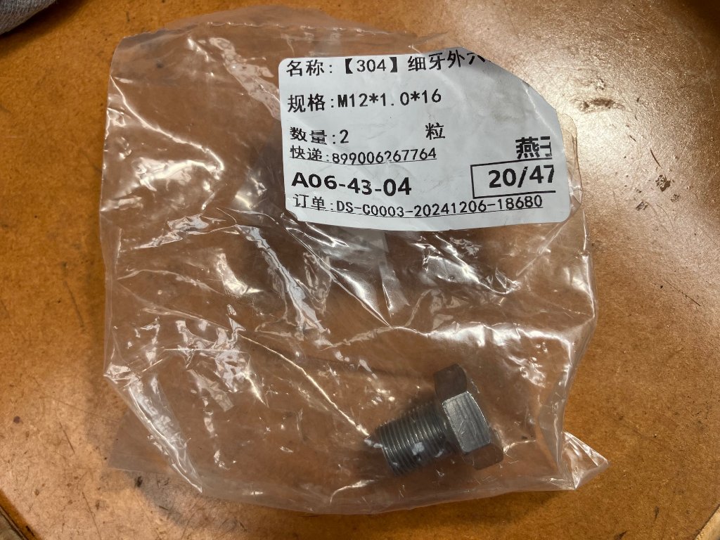

I managed to find a M12 x 1.0 pitch hex head drain plug bolt in stainless steel on ebay. I got two because they were cheap.
https://www.ebay.com.au/itm/27549945214 ... 6352740269
I drilled a hole in one of them for wiring off and put a copper washer under the head and job done.
