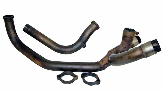

there you go. This is a header of a Monster, let`s see if someone else has one of a Sport to compare:

search ebay and find the right pics.
A 750 Sport header. The rear tube is bent upwards so it`s a no-go.
and here a Supersport header that appears to be about the same:

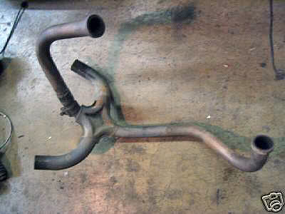

- Posts: 5569
Re: will a 750 sport header fit on a paso 750?
as as reference a (my) Paso header:
PS: the adapter on the side of the front header tube is not original. That part was welded in so for proper engine/carb adjustment a lambda sond can be used. Further advantage is that with a mobile lamdda meter you can also check when riding. The adapter costs like €15-20 or so plus welding. Ducati sells it as a single part.

- Posts: 5569
it normally doesn`t look like that
