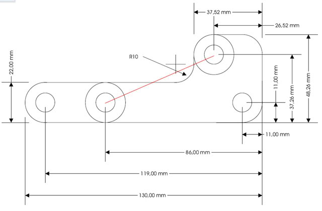

I think that should be easy. Take the 65mm adapter as basis
![Image](http://www.ducatipaso.org/myPix/mixed/bremse.jpg)
and just shorten the hole distance along the red line to 40mm. (the left/upper mounting hole of the brake caliper should stay were it is)

Thanks, G-man! It can be, that i have to do just so, but i have to do some measurements first from my ST calipers. Propably that "red line" is in same place in both calipers, black ones and new ones. But wondering, cause those black ones are designed for 300mm(91*907IE) rotors and those "golden" ones are for 320mm rotors
Anyway i still wait, if someone have made such adopters, cause i am not in any hurry to make 17" conversion, i have still "not used 16" Michelins" in my 750 Paso....
Thanks, Gerhard
