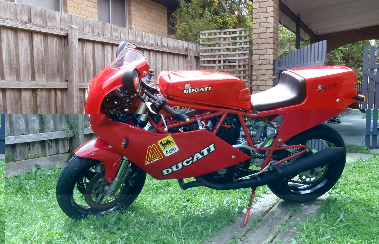

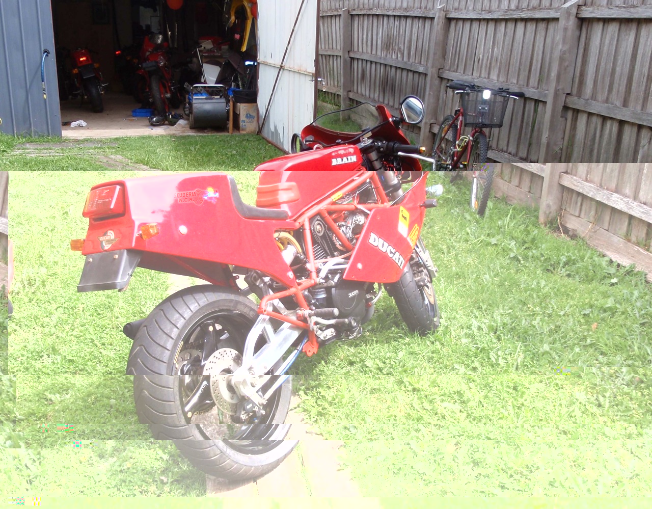

thanks for all the answers guys, I just put some 82mm pistons and cylinders on my 400F3 which brings it out to 540cc (attention to valve size in future) and was thinking of doing something similar to one of my 750 sport engines as a test.
btw the F3 performed admirably at the recent Broadford Bonanza 2011 here in Victoria, Australia. If anyone is remotely near, its a well attended and very relaxed event for classic machinery.
