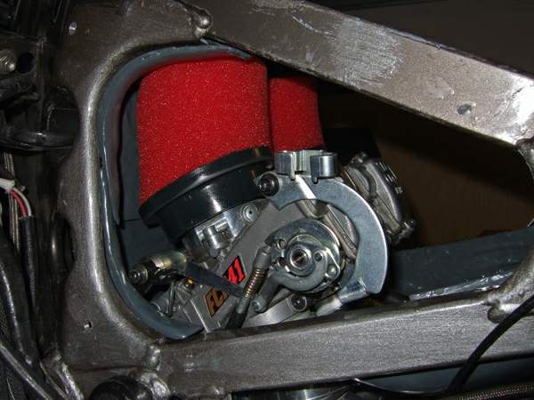

While you can run the manifolds from a Monster or SS,(which I believe you are already running) shorter manifolds are always better. If you get Malossi short manifolds, you can split the carbs. you will need to put elbows on the ends of the carbs to your aircleaners.

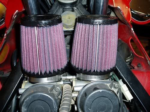

Splitting those carbs is not so easy as you`ll need a second throttle linkage etc. Also short carb manifolds will shift the torque curve from low to high end which may be good for track use but imho less preferable for street use. I don`t agree they are always better.
Not being a fan of elbows in general and in special if they are too long, U-shaped etc these filters will fit:
K&N 2530 (was posted here in the forum before. I guess it`s SN-2530)
Unifilter UP4060A (the Keihins shown have the SS/Monster airbox adapters mounted)

I must admit, that I only speak from what I have heard about splitting the carbs, as I have not done it myself. But seeing them installed, it seems the faster, easier install is with them together, and use the longer manifolds. It also gives you a chance to actually make an airbox, and the airfilter situation is much easier to resolve. And you can put nice big/long intake velocity stacks (trumpets).
